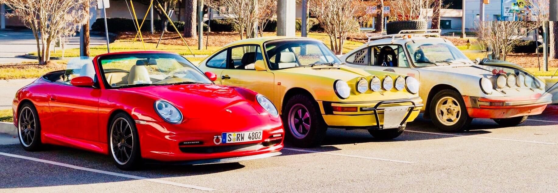

Mine has a splitter from GT3 Cup car. It’s a Porsche factory part. Does require slight modification cutting the ends flush with the wheel well.

Completely agree. Have have had mine taken off by bumps in the road. Simply push the plastics rivet screws back in and your good to go.
