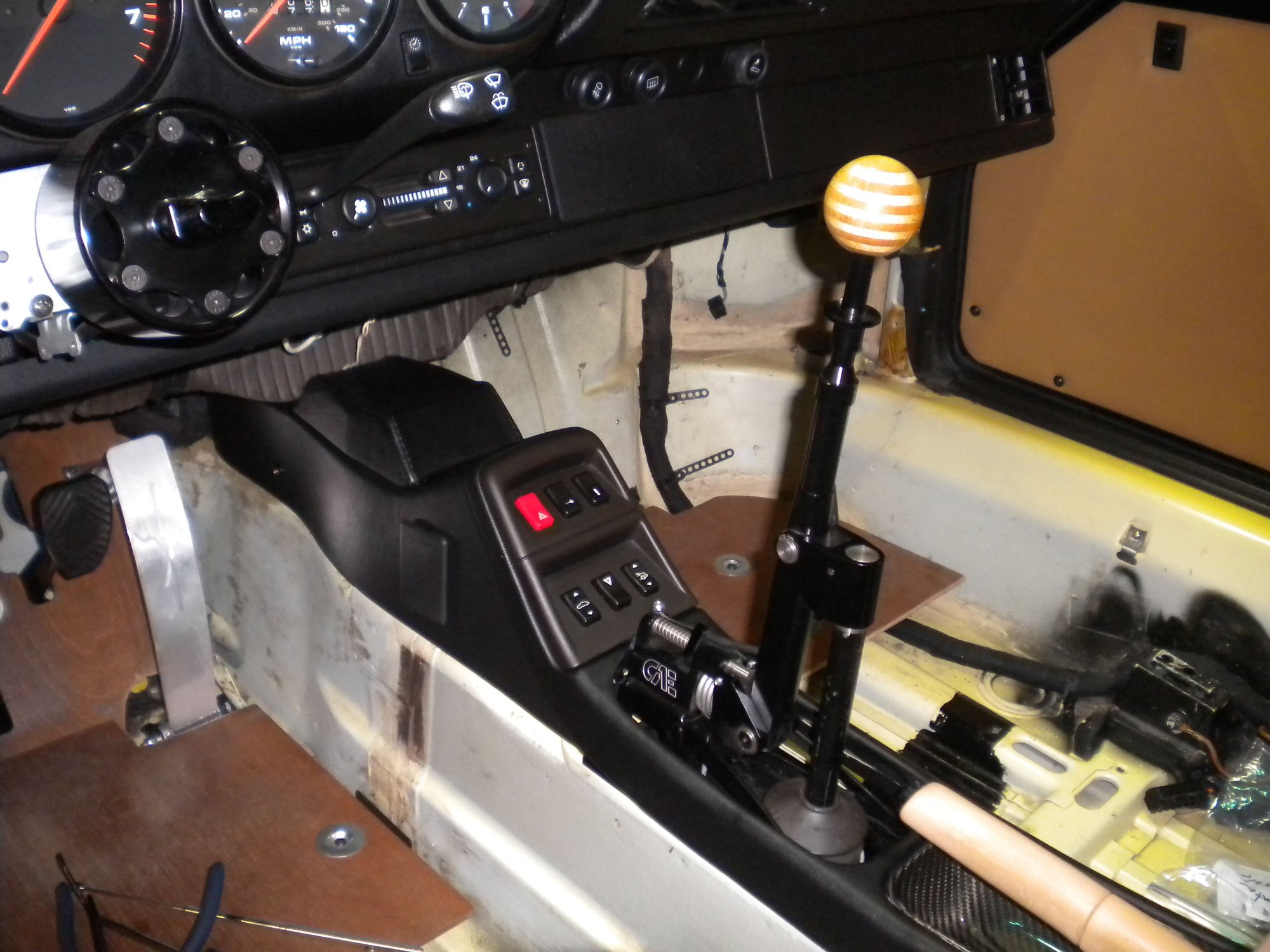

The partition between handbrake insert and original shift boot was moved back by amount shown between the red lines. Then 2" ABS plumbing tubing had the perfect radius for the corners. Flat sheet used for side walls. The insert under the hand brake was simply shortened and glued together with ABS cement using some reinforcing pieces of ABS under the joint. The whole thing was then covered in leather.

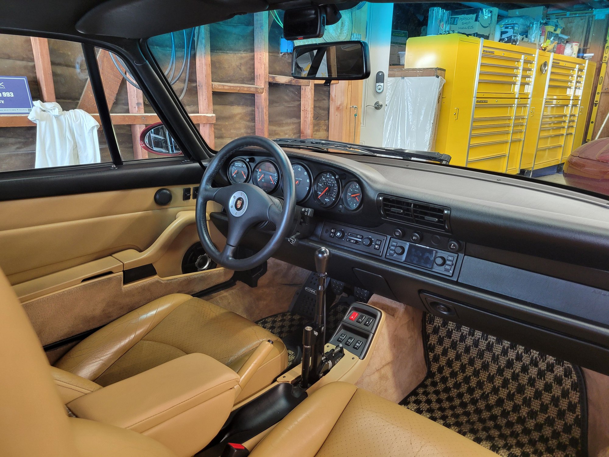

thanks to cupcar I have a center console again.
thanks cupcar! merry christmas!
I know, I need some sound deadening, maybe.
some carpet, maybe.
probably that passenger side servo would be nice.
and seats, I need seats.
but I have a center console with switch plates, kept the cae shifter and it looks great.

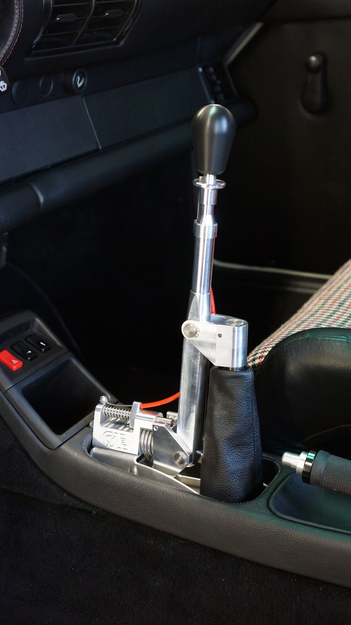

Mini update: I made a form fitting cover out of sheet metal, then covered it with leather. It's installed around the base of the CAE shifter, giving it a little bit more of a finished look.
some carpet, maybe.
This looks perfect to my eye. It has a raw cup car vibe. No need for carpet or sound deadening. I wouldn’t change a thing. CAE for the win.
