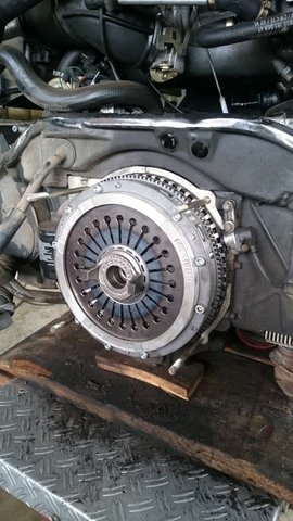

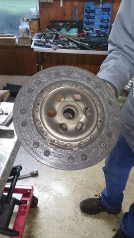

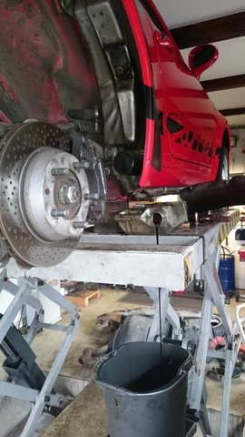

Sachs Lightweight Clutch + Flywheel installation went pretty smoothly. I was due for an oil change so that was an added benefit. My mechanic dropped the engine and transmission, pulled the old clutch, and black dust rained down when it came out.
It was fun watching my mechanic work, he’s been wrenching on these cars since they were new, and he has everything memorized. One day he pulled out an old photo album and showed me a photo of him in the 2.7RS he used to own! He told me that he heard that they are now quite valuable
Nice way to change oil without spilling

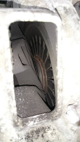

Sneak peak before the clutch came out, full of clutch dust
Out with the old

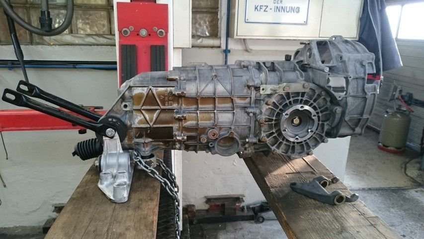

Had the transmission taken off and cleaned, it was covered in salt from two years ago when I picked up the car in February from Bremerhaven. The Germans salt the roads to unbelievable levels over here.
All clean

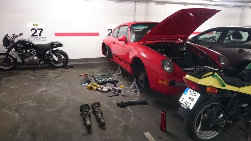

Once she was put together, I drove the car straight from his garage to my parking garage, where I began work on the suspension. Big shout out to my parking garage neighbors for being cool with me working on my car there every weekend! I met some nice Germans and had some fun car talks with curious people.
My "shop"

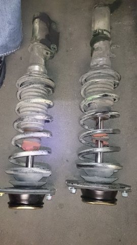

My old suspension was definitely on its last legs:

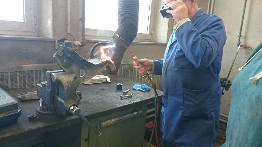

And while I was at it I put Walrod bushings in my A Arms, the shop wouldn't trust me with the torch:

Did all that suspension work in a public parking garage?
Inspiring...

Beggars can't be choosers and my neighbors seemed to be ok with it. I told my wife when we move to Seattle this year my one "must have" for the house is a garage.
