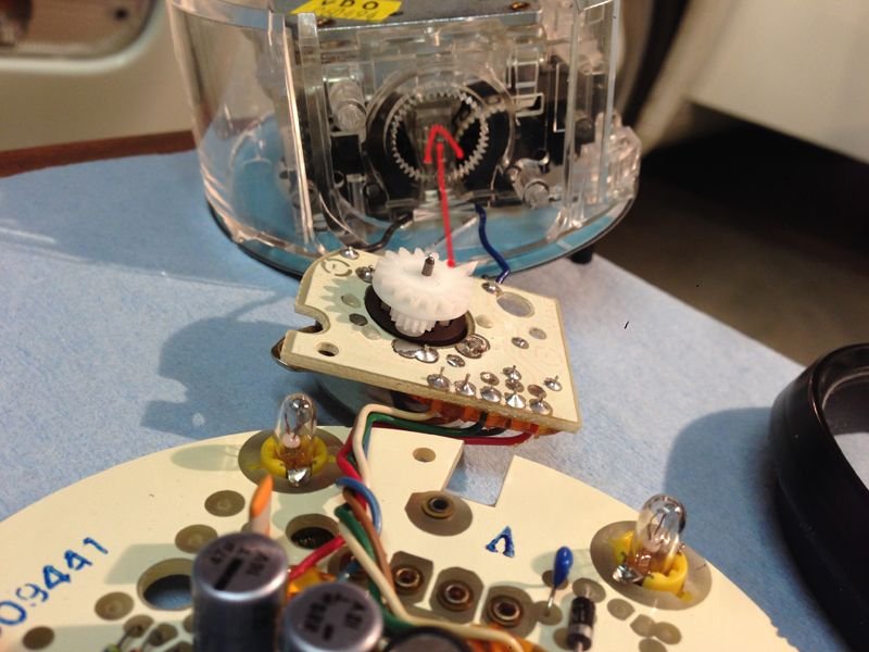

Besides a much needed thorough cleaning, the new large gear might also not have been fully seated against the main gears (away from motor) during the first reassembly...
Here is a pic of what I am talking about:
Make sure you push the gears towards the center of the odometer during reassembly. You should be able to feel when they are all the way in.
BTW: as shown on my photo, I was able to completely remove the motor without removing the needles and the face, but I don't recommend going that far! I think that it is safer to just follow the Youtube video and to simply slightly pry on the motor to gain just enough access to the gears.
