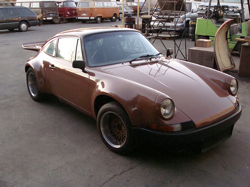

Andreas, how did the DB get her name? It would be easier to grasp if she was Sepia Brown.
The 3/4 view is the same.
Andreas
