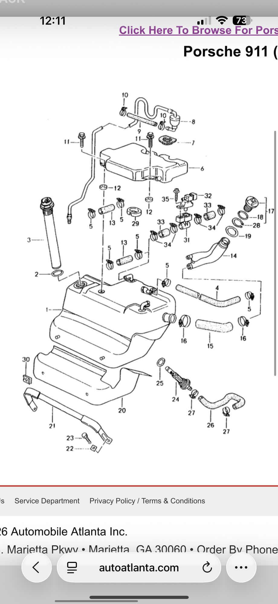

A year or so ago I pulled the fuel tank to repair the HVAC and when I pulled the vent off the top of the tank I noticed what appeared to be carbon in the lines. There’s no issue with how the car is running and the fuel filter should catch anything so I bought a new vent line valve #8 in the diagram and didn’t get around to installing it or addressing the carbon issue.

Aside from replacing the canister, did you do anything else? I don’t have a diagram handy for this, did you find carbon in any other areas that needed to be cleaned or blown out?

Blew out the vent line at the roll-over valve (# 8 in diagram) by mouth, back to the charcoal canister. Got maybe a teaspoon of charcoal granules out of that line.
Vacuumed the granules out of the wheel well area. Replaced the canister with new one. Old canister was leaking charcoal from upper vent "Tank" & lower air inlet "Luft" nozzles. Nozzles are labled on canister, "Tank", "Motor", and "Luft" (for atmosphere) IIRC. Motor nozzle was not leaking in my case, could still see intact filter membrane inside.
