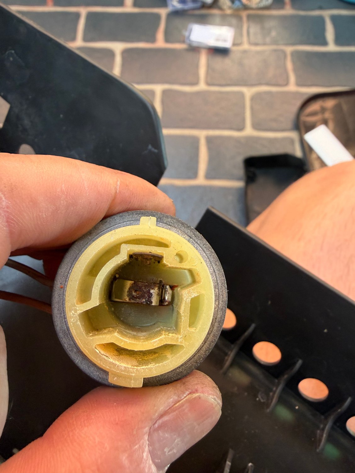

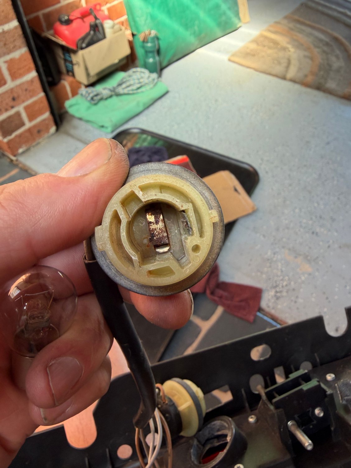

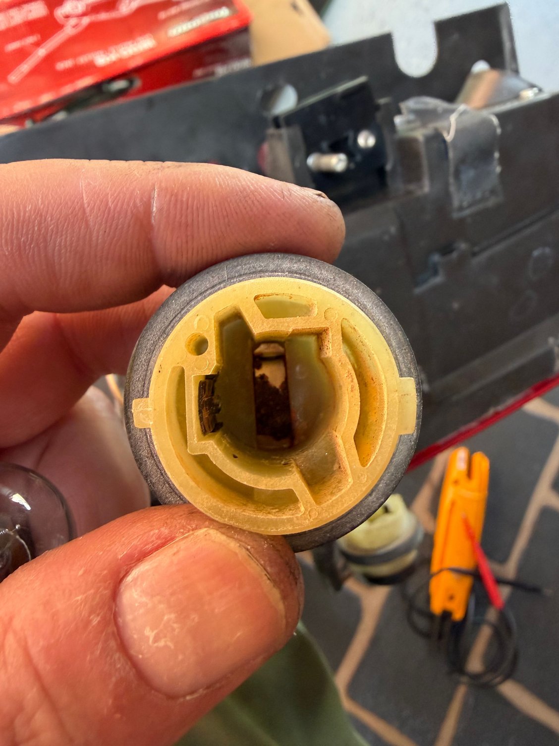

Originally Posted by TDCook
ok makes sense. I cleaned the switch on the gear level as that was filth, checked the fuse and relay they are fine as well as the globes. Any other ideas?
I think if found the issue..
The bulb sockets are cooked. Corroded as
