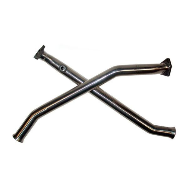

@Bill Verburg i noticed cargraphic cross pipe diameter is 63.5mm and dansk 54mm 🤔
Btw. My car is Bischoff
https://www.cargraphic.de/en/your-ve...p/carp93kater/
https://jpgroup.dk/en/p/Cross-pipe-s...l/18517/18517/
Id probably go for the 54mm to keep gas velocity up, and they will be easier to fit.
If you were racing a 3.8 o4.0 w/ extended rpm the bigger ones might be more appropriate, but I doubt it.
If the system is to be used with a muffler, I think the ~ 10 mm transition from the bigger to the smaller diameter stock pipe in the muffler would not be great for flow ether.

Its RS so its 3.8.
I'm also wondering about the point of a larger diameter since the entrance to the muffler will be smaller anyway
true, 54mm is still on the large size for <~1900cc and <7krpm

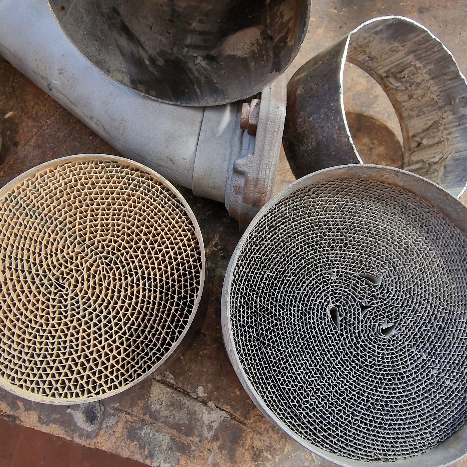

Originally Posted by clubsport1

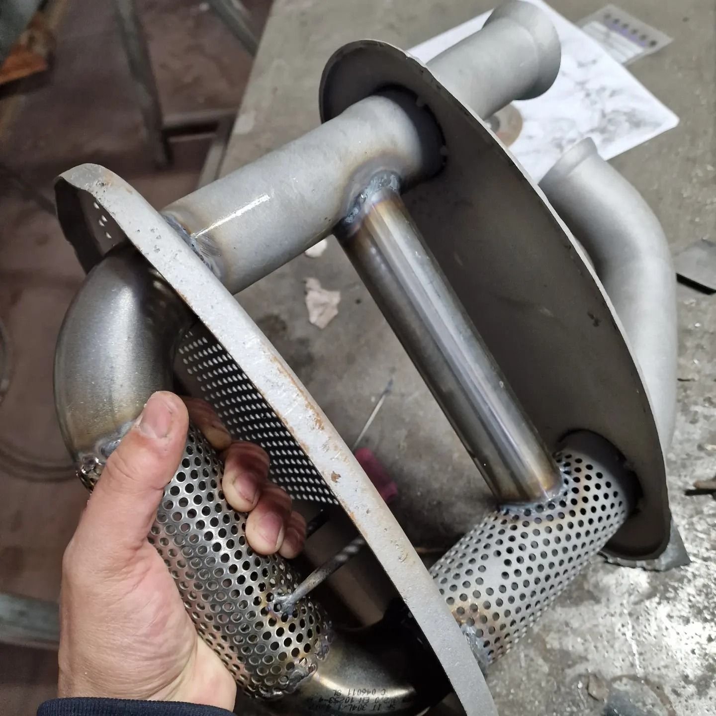

Of the 993 RS with modified exhaust systems I have seen over the years in the UK, the swetspot seems to be fitting 200 cell catalyst convertors. This obviously improves the flow, but still gives you a chance of passing the annual exhaust emission part of our "Mot" test. No catalyst fitted is an instant fail, where as 100 cell cats fitted can be very marginal at passing the emissions test, particularly as they age. Everything is a compromise?

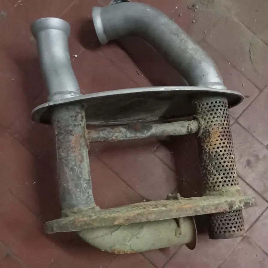

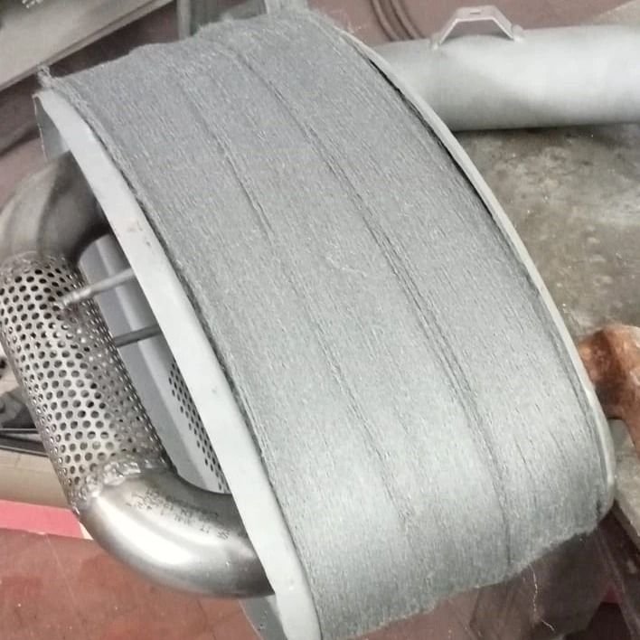

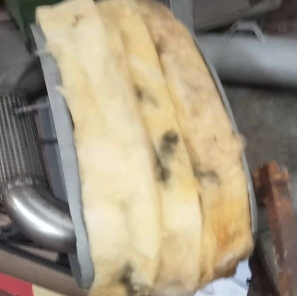

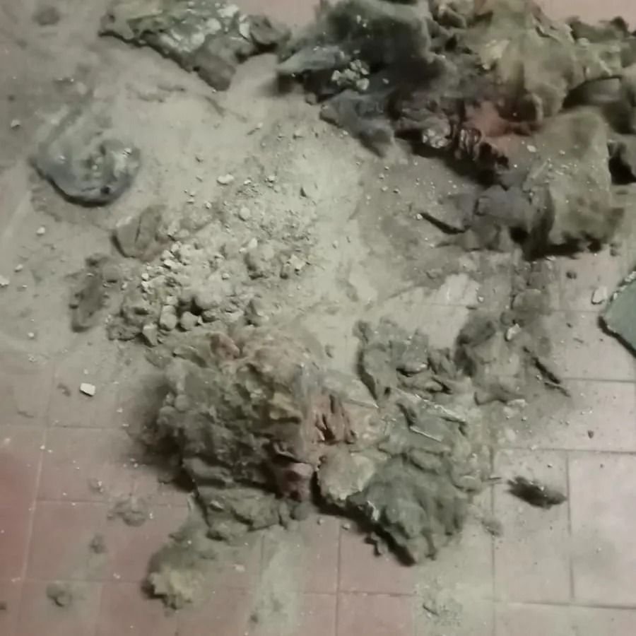

On a fully rebuild to 0 hours engine equipped with the so called "common mod" (muffler mod - with the turbo shaped upper perforated duct between the 90° curves) but also with larger diameter bypass duct inside the muffler as for the soundkit, with the addiction of HJS Hi-flow 100 cells motorsport cat inserts, the car passed the tests here in Italy with a large margin, being the limit 150(but I don't remember in what unit of measurement) and the measured value being 110.
I am now dealing with the complation of the running-in, but a thing I would like to do afterwords is the map of the engine, but I don't think is easy to find someone really expert in such "hybrid" engines, in the real sense, with a partially electronically and partially mechanically controlled engine management, hence I don't know how much of an improvement to expect, even if performed by someone really skilled.
Muddy inner side because of the river mud - but here it is the original shape of a n/a 993 without the kit sound
the river-mess, once the muffler were opened
here the final set-up, with larger diameter bypass and the turbo style mod to enhance the gas flow
rock wool layer
rock wool layer
additional insulating element as originally present, the name of which I don't remember
comparison between original and Hiflow 100 cells cat insert

Niece modd.
So oem cats are 400cps ? 600cpsi cats are dense.
rock wool layer
rock wool layer
additional insulating element as originally present, the name of which I dont remember
very very nicely done!!!
that lower crossover mostly makes it louder the bigger it gets, and quieter the smaller it gets
