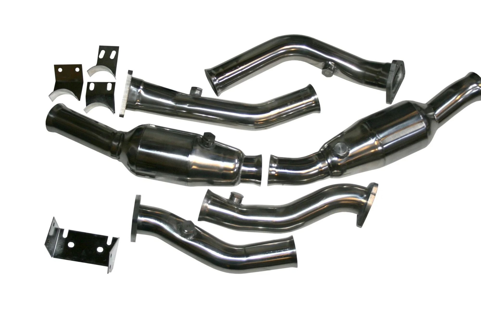

Maybe this could be a good choice?
That was my choice, but no smog checks here
@Bill Verburg I should not consider this system?
For a merged cat system that's pretty decent, at least the gasses appear to be just brushing by each other and not smashing head on.

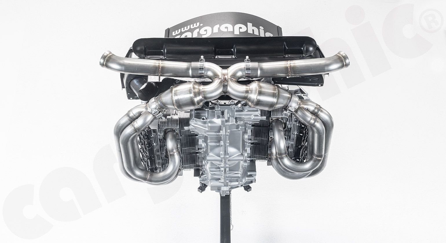

@Bill Verburg , what would you do if you were in my position? 😁
1. Cross pipe?
2. Cross pipe + modification of the OEM muffler?
3. Replacing the OEM catalytic converters with 100 CPSI cores + modification of the OEM muffler?
4. A complete system with headers from Cargraphic?
What matters to me? Improved sound and, of course, a power increase.
Thanks a lot for your advice 👍
1. Cross pipe?
If there are no smog checks and it's an OBD 1 993 then the separated cat bypass
If there are smog checks it depends on whether it's a visual or actual sniffer test and how stringent they are
for a competent visual you need all the stock components
for a cursory sniffer 100 cell , if it's a little more stringent 200cell
headers don't really add a lot to the program over stock heater boxes on a 993 and they are expensive
That said sometimes they are necessary for one reason or another, I use cat-lass Fabspeed on my 911 w/ 993 motor because that's' the only one that I've found that works well in all the areas I'm concerned w/
