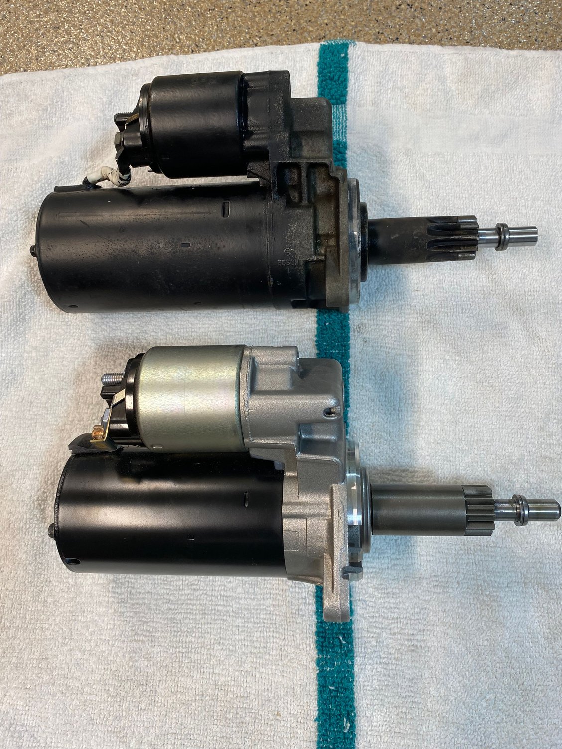

Posted this to the general forum and re-pros thing here. Pulled out the old starter and when comparing to the OM replacement it is much smaller. Opinions, before I proceed.

The small one will fit fine. I remember the same when I replaced it on my C4S a couple of years go

Replaced mine a while back where the replacement was a tad smaller. I was concerned until the first start, spins much faster. You should be good.

Better & lighter than the original.

Is it a Bosch SR0451N ?
If so yes it fits and yes it's a massive improvement on the original. You won't believe the difference

I had my starter replaced with a Bosch SR0451N about 3 yrs ago. I also noticed it was a bit shorter than the original but it's been working flawlessly for me.

I thank you! Installed and apparently works fine.

Much better and lighter than the original. Just replaced mine as the original was too far gone. Much faster turnover starts than the original!

The Original (longer) is Lighter. = 4.54 kg
The replacement shorter update is heavier = 4.568 kg
