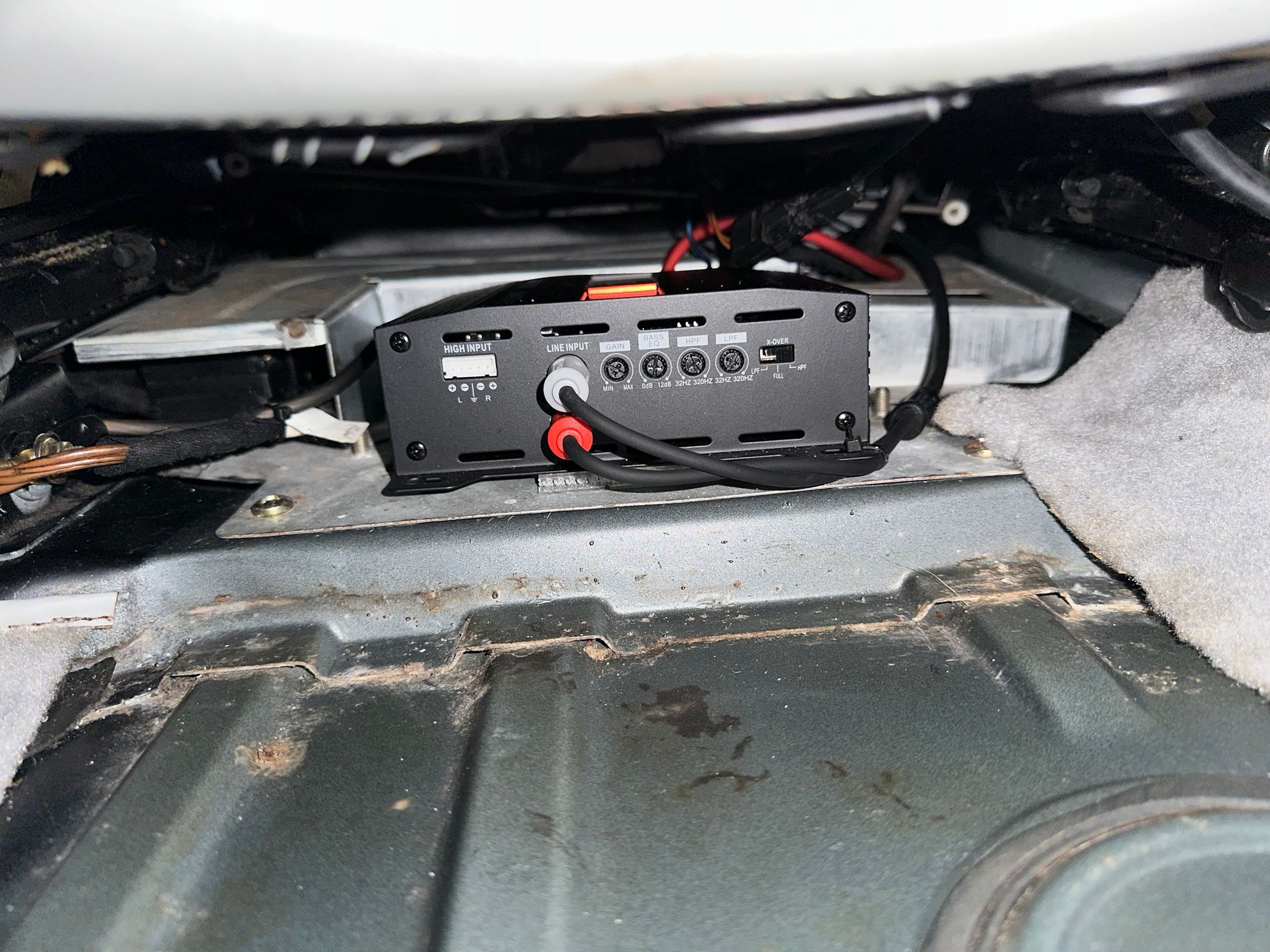

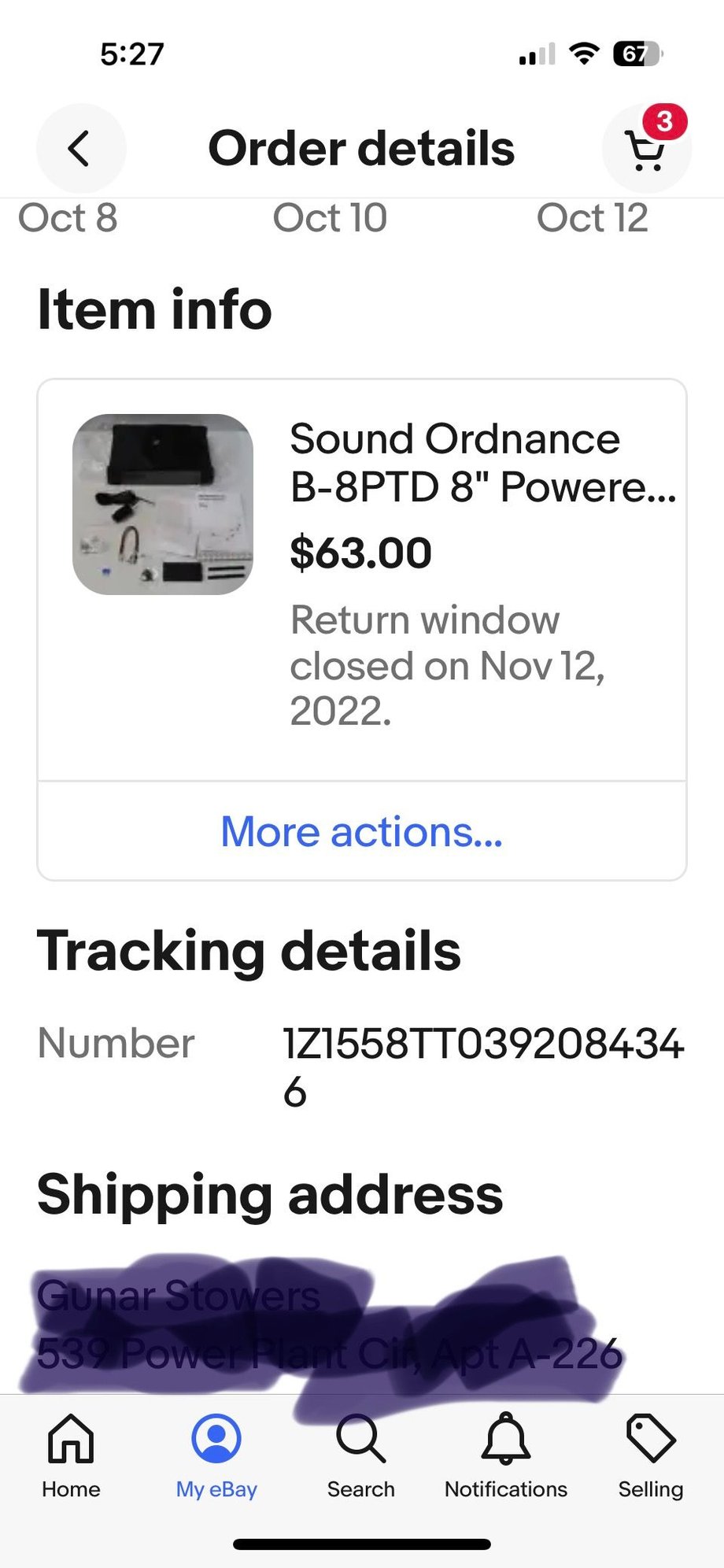

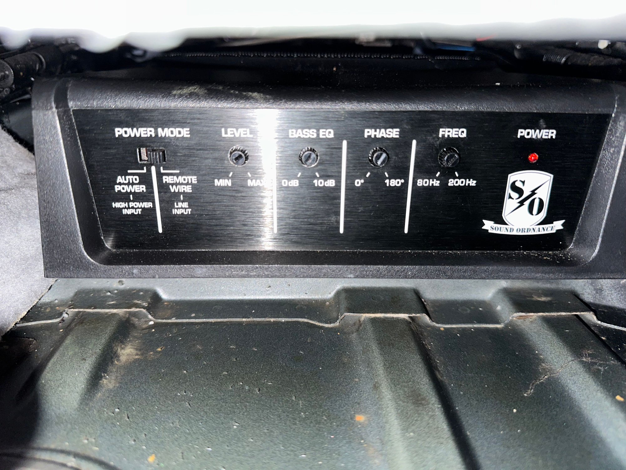

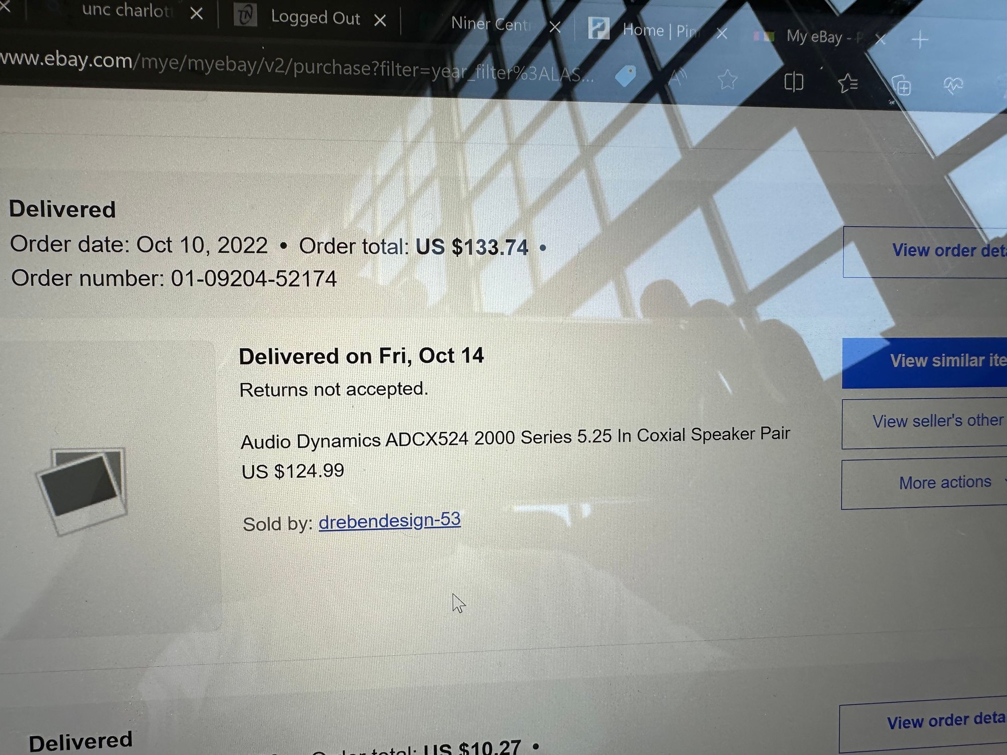

You can buy a 8 inch powered subwoofer box that will fit under the passenger seat. Buy a small 2 channel amp and put under drivers seat to run front speakers. I left the tweeters hooked up. Also you can use the head units amp to drive the rear speakers. This will give you all the base you want. Gunar
I think I used Audio Dynamics in the front. They were drop in. I can’t remember what I used for the rears in my 96 cab

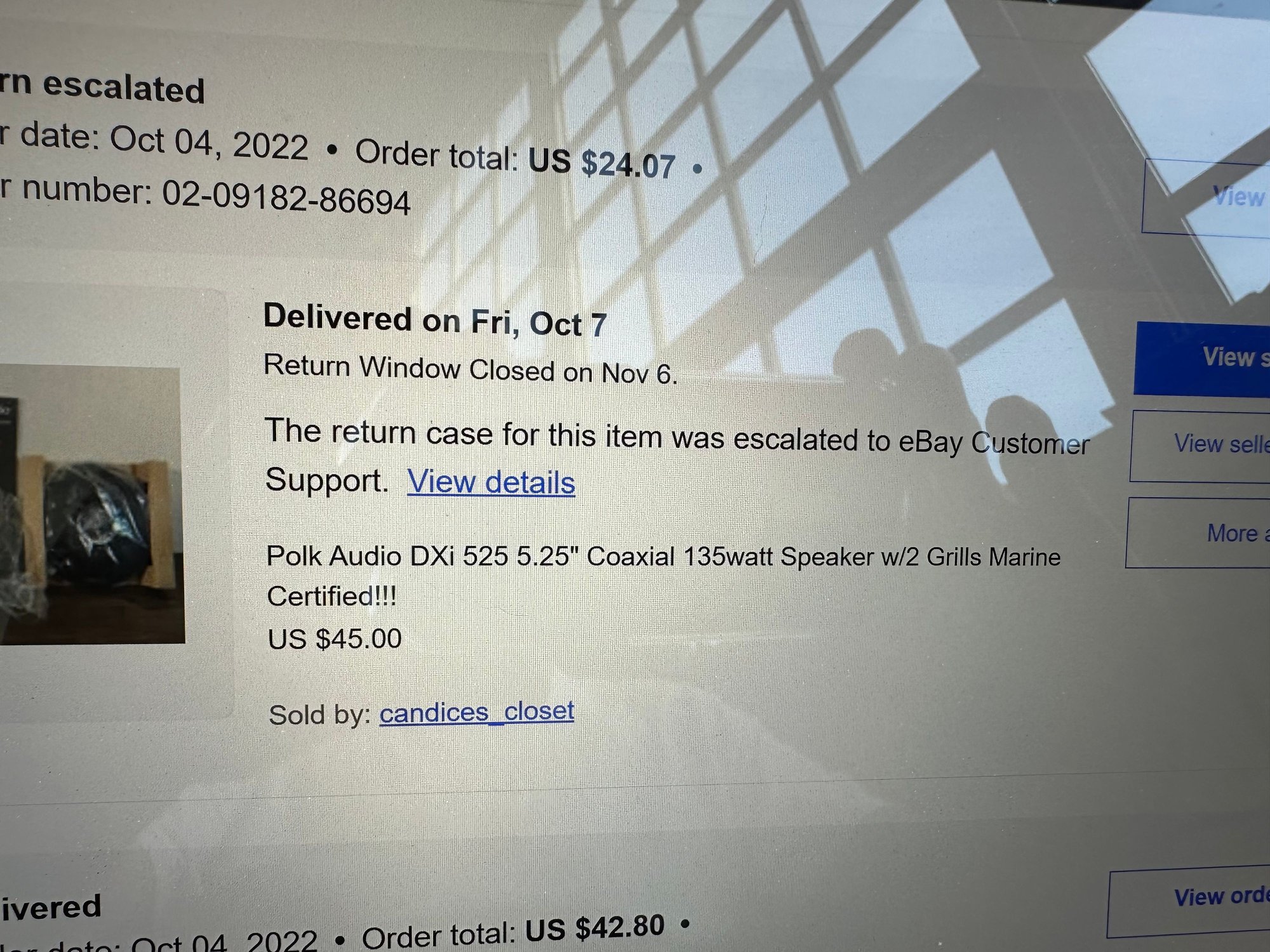

I returned these Polks cause there was only 1 speaker available

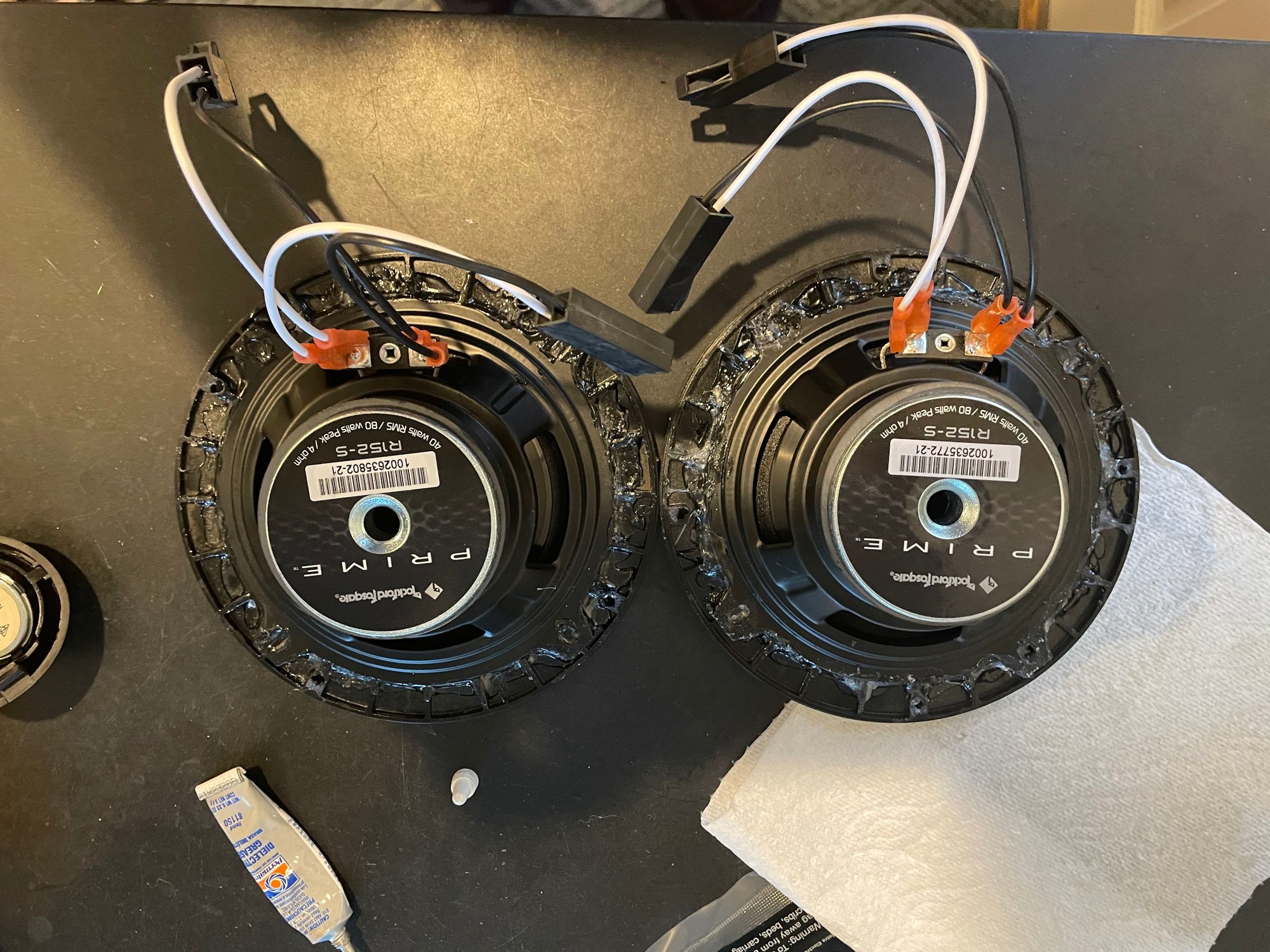

I did this on my 96 cab (non hifi) last year with crutchfield components. My front and back speakers were blown due to age. Once pulled, i couldnt believe i got any sound from them at all.
Up front, i kept the original tweeters and installed rockford fosgate r152-s 5.25 speakers. These come with a speaker and separate tweeter (i didnt use the separate tweeter). For these speakers to match the mounting holes on the door card, I cut out the original speaker’s circular surround (with the screw holes) with a dremel. Then glued the new RF speakers into that surround. I looked here and elsewhere, but couldnt find an aftermarket 5.25 or 6.5 speaker that matched up to the mounting holes on the door card (hence the cutting of the circular surround, which i followed from an earlier thread on here). The RF tweeters didnt easily fit the door, so i just kept the original tweeters. I also ordered the crutchfield recommended wiring harness, which made the speakers plug and play (after the dremel and glue). Reinstalled the original speaker covers.
The rear was easy. Just pulled covers and installed JL audio c2-400x coax speakers. Saw them recommended on here. A bit pricey, but they were a direct fit and sound good for such small speakers. Also used the crutchfield recommended wiring harness. Reinstalled the original speaker covers.
Combined with the continental head unit, the car sounds great to my non-audiophile ear. I Can hear my spotify music great at anything but top down fast highway speeds (and i have fister 2s). I dont feel any need for further upgrades (amp, subwoofer, etc)
Good luck, hope this helps.

Back of speakers glued into old speaker mounting surround. Not pretty, but i let them cure for a few days. They’ve worked great, no rattles or other noise.
Front of speakers glued into original speaker mounting surround (after dremel). Again, not pretty, but very functional.
