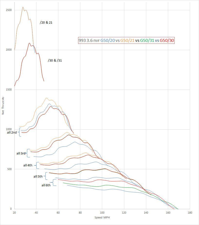

Here are most of the n/a 993 trans overlayed, all have the same 3.8 RS engine for comparison purposes, they don't look all that different but the difference between a /20 and /21 is night and day as is the difference between a /21 and /30

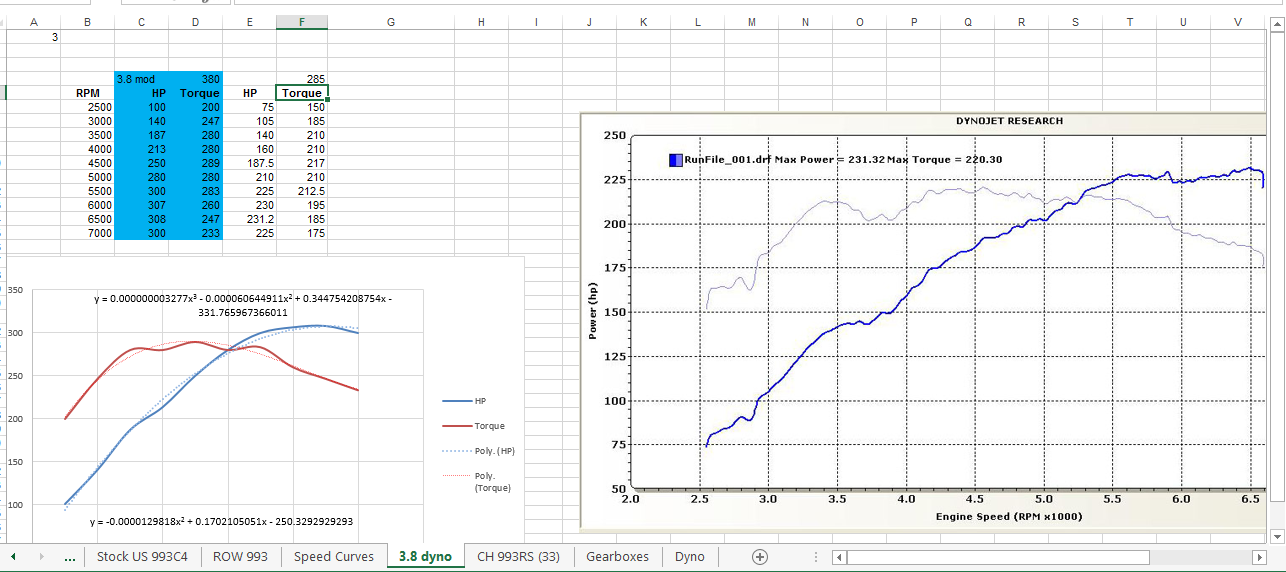

Exactly. Not having a torque curve I extrapolated the 3.8's torque based on sellers purported peak 380 BHP relative to (what I believe is) a stock 3.6 dyno. My simulator includes inputs for shift points, but redline at each shift is generally optimum.
