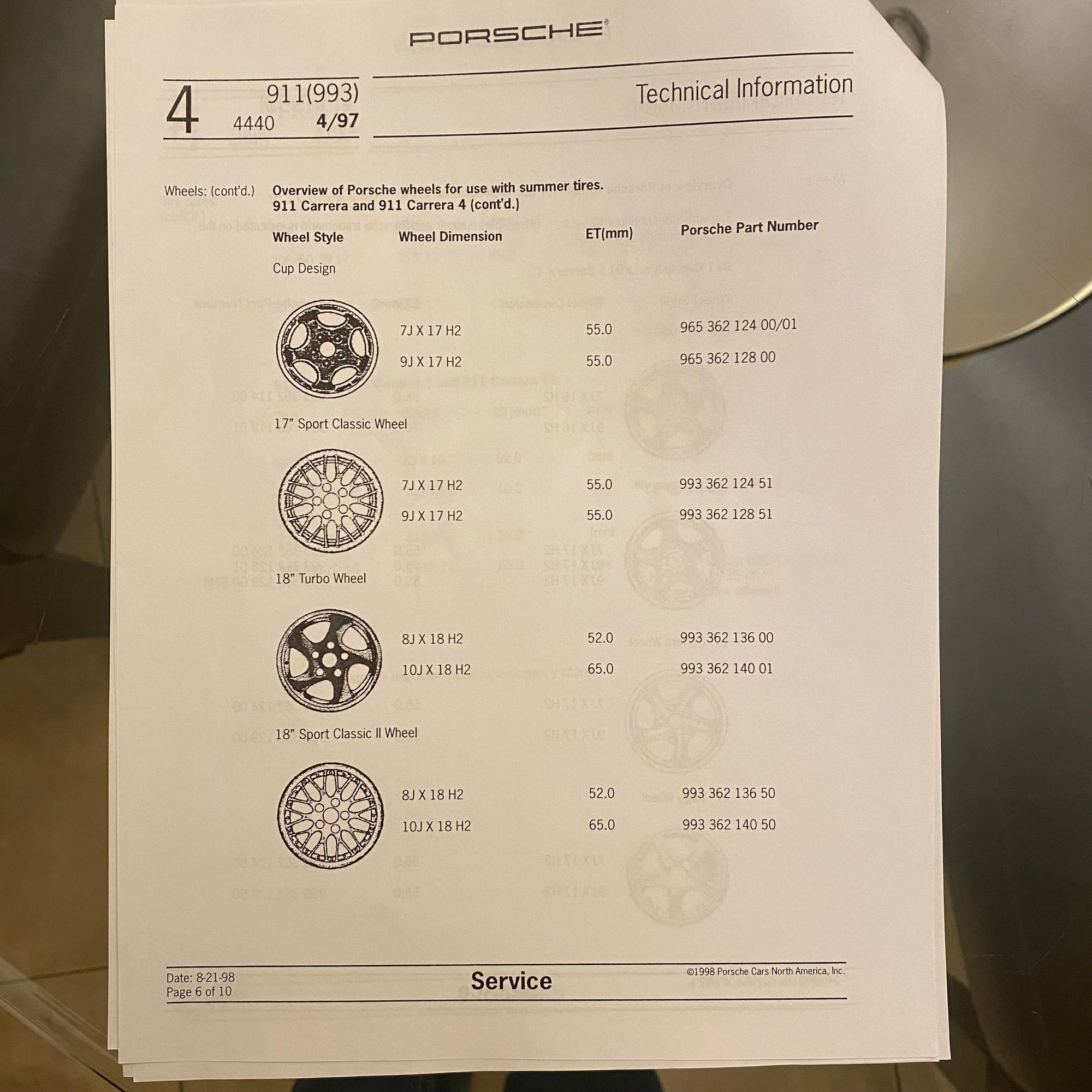

So old documentation is fact? Here you go then.
Thanks. Can you post the entire page 6 so I can see the applications at the top and keep a copy for my records. It’s interesting that my docs are dated 1997 and has no listing for the 7.5’s. Yours is dated 1999 which is the year the 996 came out and shows the 7.5’s. Wonder if they added the 7.5’s in 98 or 99?
It's just the updated 4440 TSB which is on the internet. No secrets.
My 7.5Js are datestamped 1997, so the documentation above trailed the actual production. My 8Js are datestamped 1996, SM may have been making both in 1997, or they may have switched.
The interesting thing is that SM made just one face (from sometime in 1997) for the rear 9J and the 10J, and attached a different barrel to complete the wheel. I've never seen any info on that being done for the fronts, which you could say implies they had decided to stop making the 8J in 1997 sometime - maybe they had a stockpile that was greater than the number of 993 shells remaining..... we'll never know.

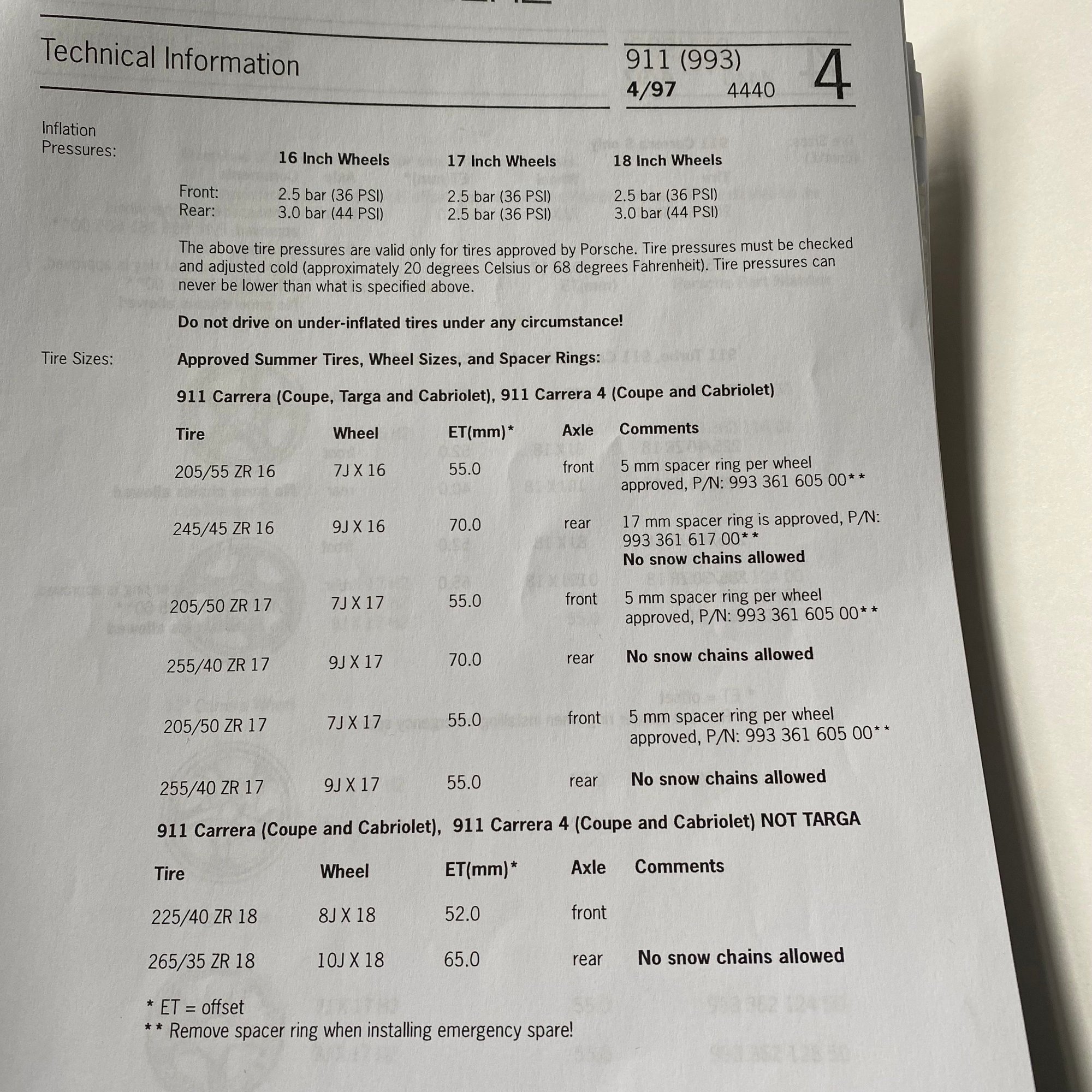

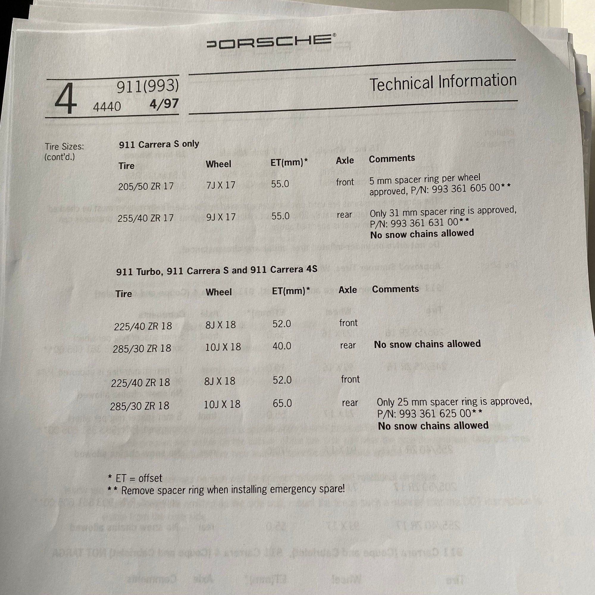

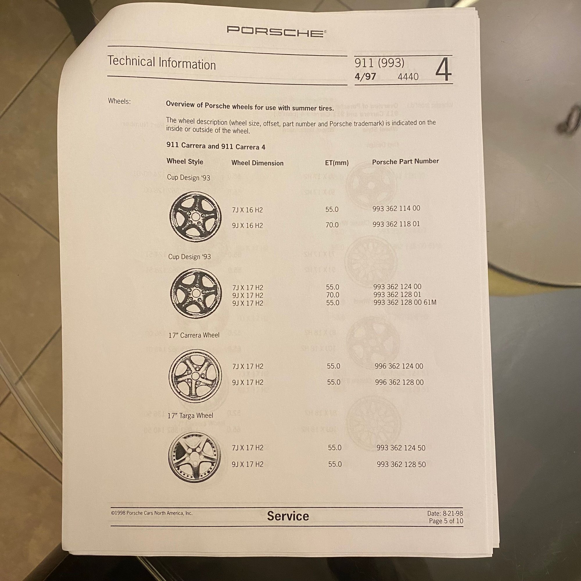

For those interested in production changes/dates etc., you can find a bunch of service bulletins here…
https://rennlist.com/forums/993-foru...regularly.html
The first mention of the 7.5 inch wheel for a 993 is in 1999 under “winter wheels and tires”.
That copy I showed is printed/dated 1999 for sure, but the TSB is actually version/dated 2/98 - the earlier one you have is actually 'TSB issue version/date' 4/97.
Again this matches the datestamps on the wheels that I have seen, if all '18" Turbo' wheel sizes were available from sometime in 1997.
Note that even your 4/97 version of the TSB details the Carrera 17" wheel with the 996 part number.... as we all know, if anything is available to be sold, Porsche will sell it to you
