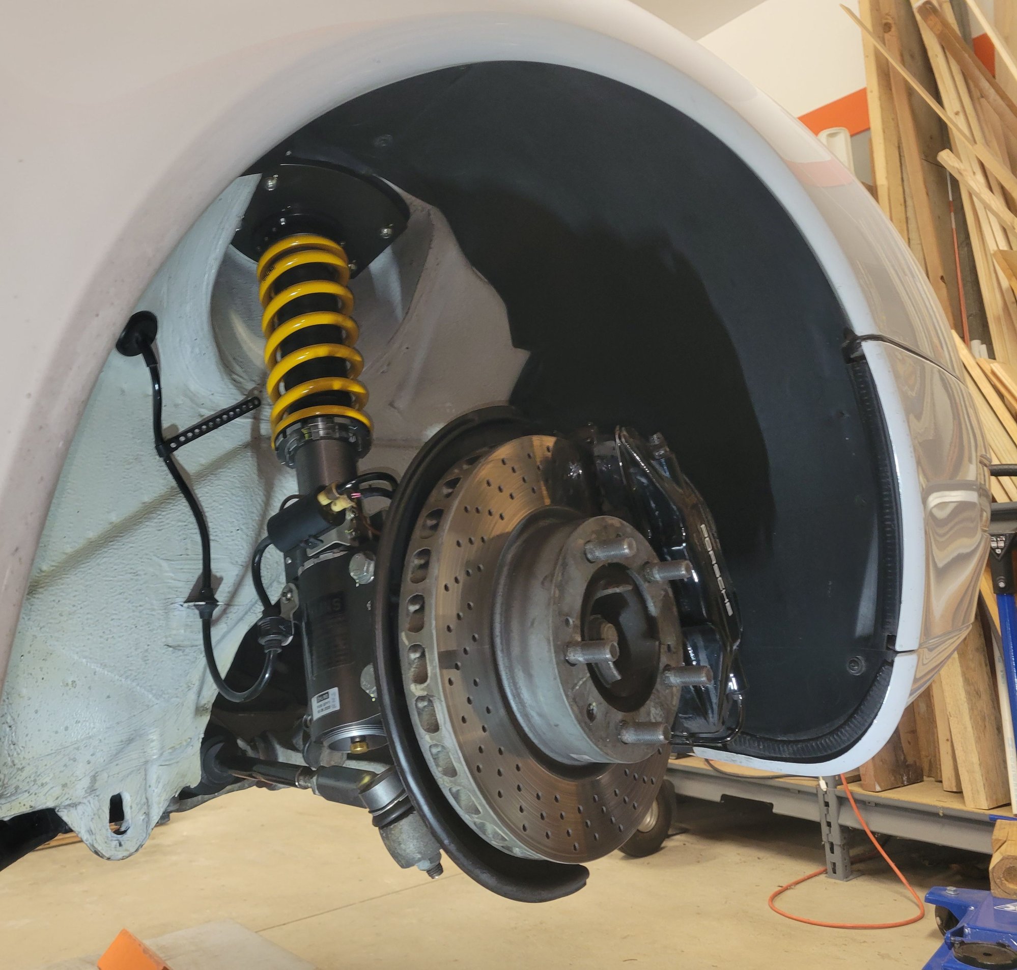

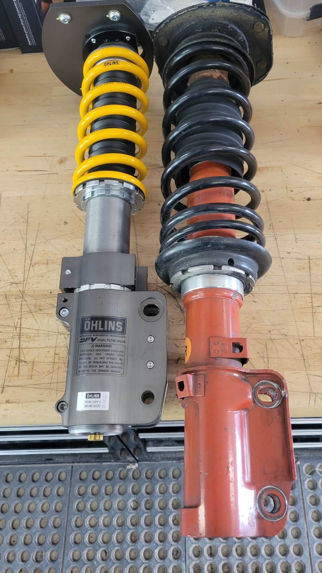

Originally Posted by LimeyBoy
the front right has a clunking and is now sat on my workbench.
Update:
Ohlins USA came through: The fault was "excessive play in the outer tube bushings". The bushings were replaced, the turnaround was around 10 days and the $122 + shipping was waived for Goodwill.
Arrived last night:
Back in place:
Then out for a drive and ... beautifully clunk free.
Now I can put more miles on them
