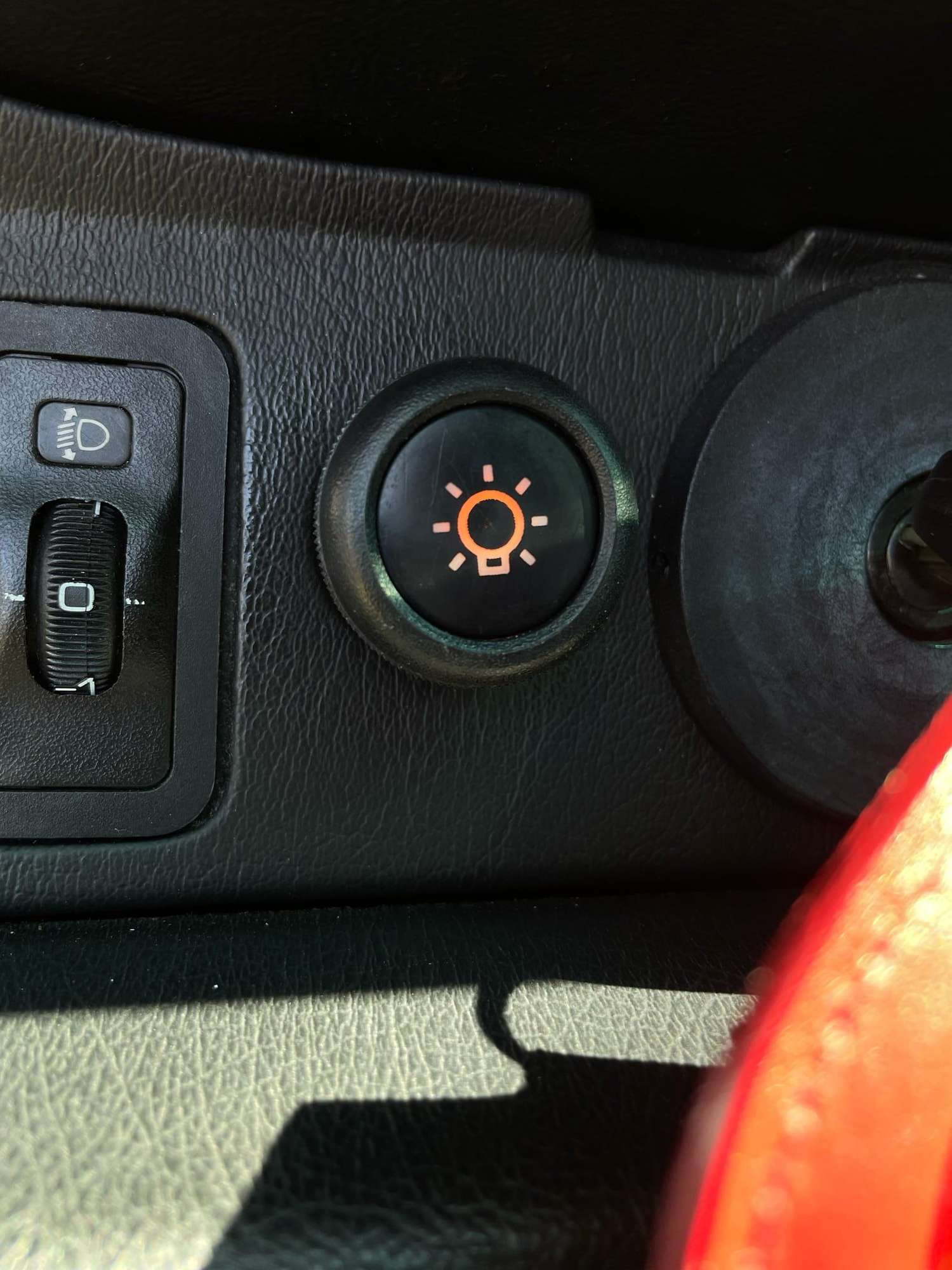

But the icon is upside down.
Good idea Mike. Looks good.

Mine was out too. Just replaced it, also fixed alignment of icon.

Thanks for the pics! I was trying to pry out the top plate at first but after seeing your pics I realized it's the whole cover. Anyhow, not sure how long my light bulb has been out, replaced with another halogen and happy with it now!
Originally Posted by Styrizo
Done here too. Since it is a constantly lit bulb, I decided to go for LED instead of incandescent. Bought a 10pc bag at Amazon and I will do the same mod to my Z3 which also has the same light out.
I had to trim the steps on the sides of the LED in order to make it inside the bulb hole. No big deal.

I hope someone will clarify a concern regarding the headlight switch. Post nine displays removing a different part of the headlight switch compared to posts fourteen and twenty-one?
Thank you in advance
Both work. You can pull the entire switch straight off. Or pry out the center plastic with the logo. I'm going to guess the switch only has so many "pulls" on/off before the plastic "catches" that hold it on breaks. For that reason, some might prefer prying out the center.
Either method will give access to the bulb in question.

Pull the entire switch off as in post 21. This exposes enough of the bulb to even pull it out with fingers. When you put it back on, there is only one way it will fit.
If you pull just the cover (to fix the orientation of the bulb icon), you will need thin needle nose pliers to grab the bulb.

That was a very satisfying $3 fix. I didn't even realize there was a bulb there.
I used the method on post 9. The inner cover comes off easily - it's about the size of a dime. Buy the light bulb on amazon. I think they were $5 for a two pack.
Good luck.
