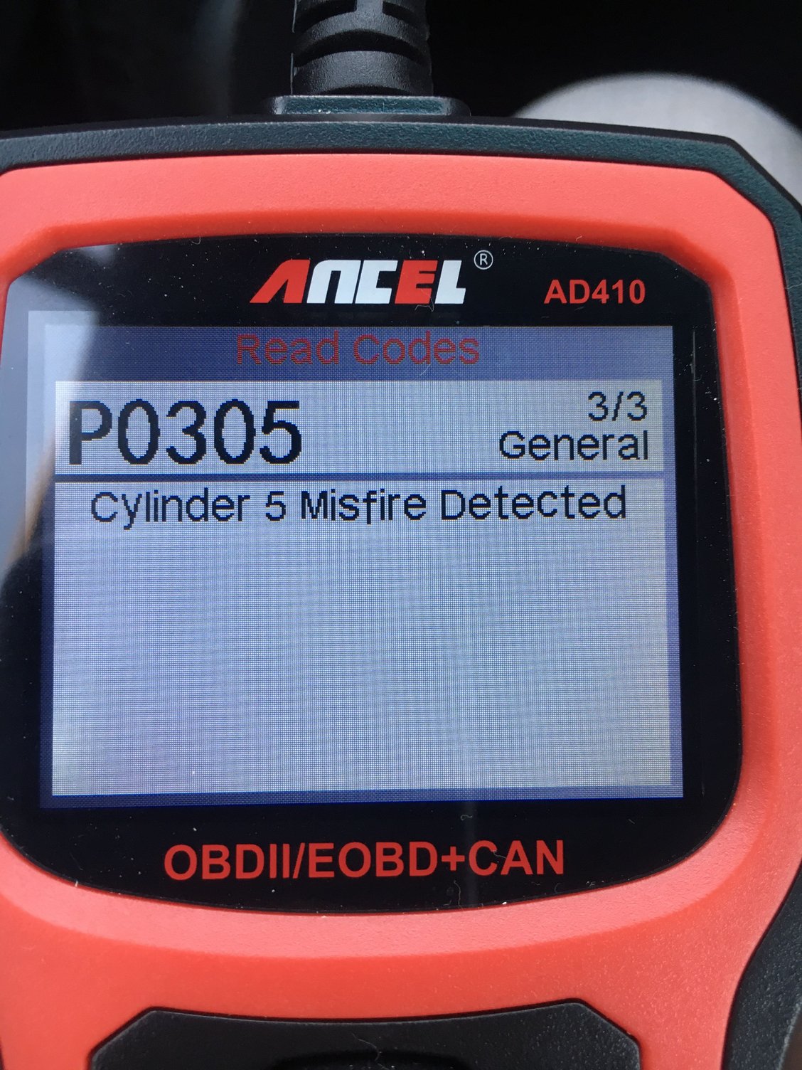

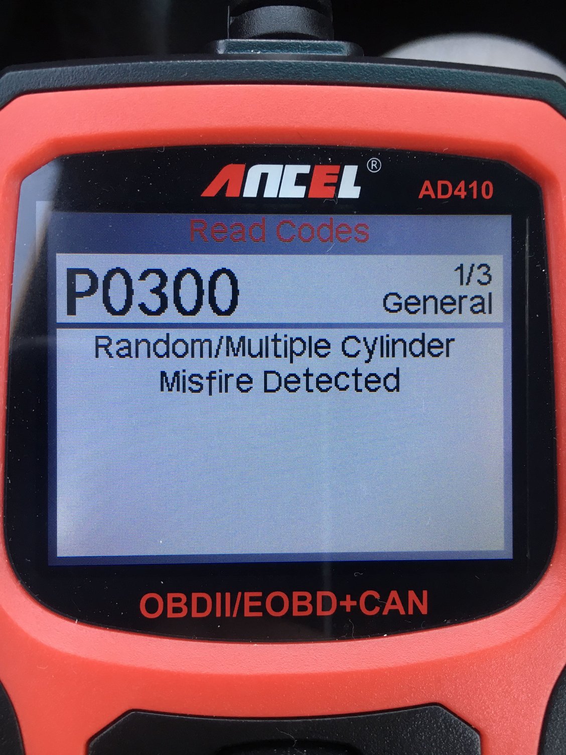

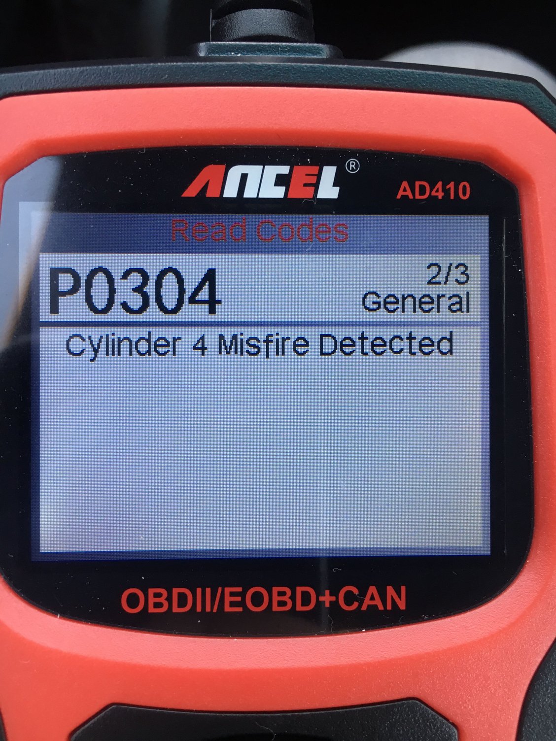

It is a random /multiple misfire in cylinder 4 and 5

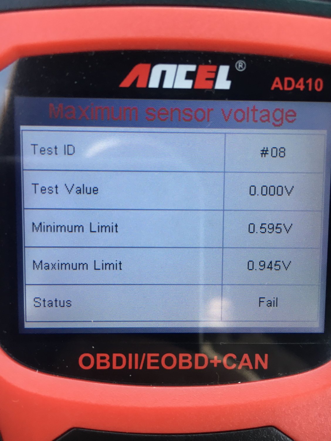

And maximun sensor voltage which has failed? With what looks like a high voltage compared to the other sensor measurements?
Can anyone explain the sensor failure as I do not understand this.
Thanks
It's best that you view the actual values of the O2 sensors (4) on your scanner.

but I am relative newbie so what does the maximum sensor voltage failure mean? is it one of the 4 o2 sensors that has gone?
It most likely means that one of the 4 O2 sensors is reading out of its normal range. Use your scanner to read the 4 O2 while the engine is running, and post the results.
