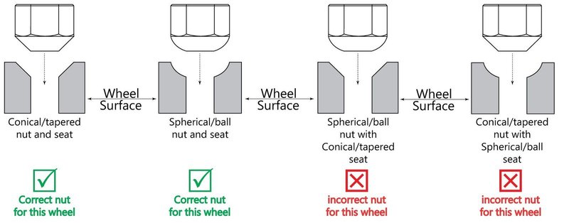

just to clarify ...
And of course, the radius on a 'ball' nut has to fit too ...
Beside a possible different ball radius on the shown upper nut, the shown contact area would likely look like this if you screw a ball nut into a conical seat ...

Originally Posted by boomboomthump
Agreed. The radius of the ball seems to be a bit small, which would cause the center of the radius to touch the wheel before the rest of the radius, thus wearing the anodize.
If it were a "conical" nut, it would not touch in the center, instead it would make contact at both edges instead.
Same thing with a 'smaller' radius ...
