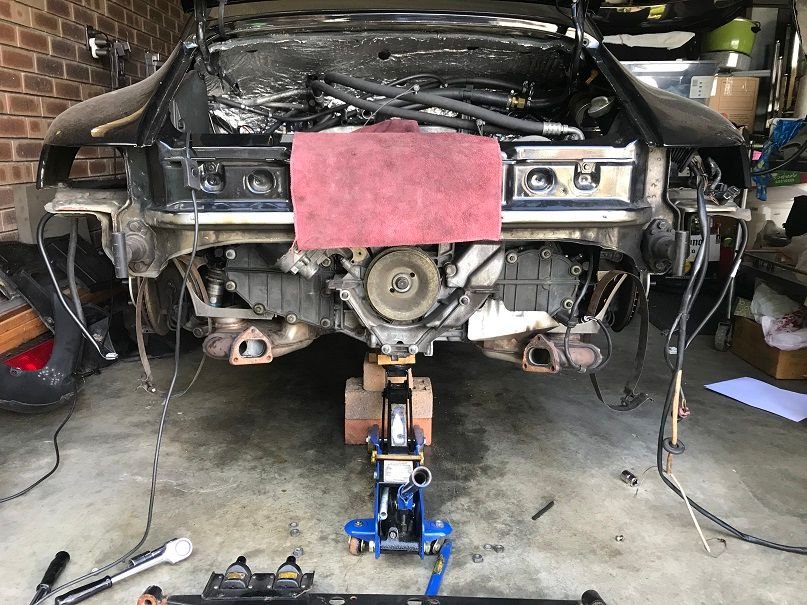

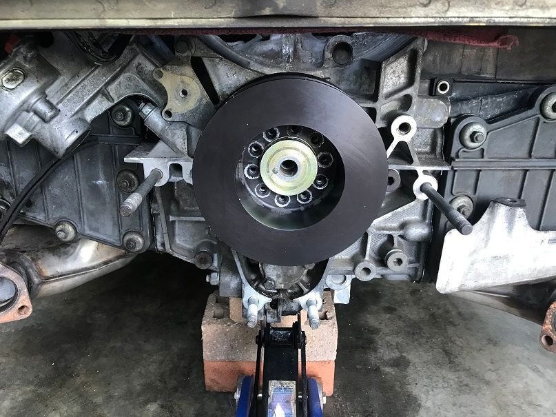

After today's session - my back is done - need a rest.
Spent a few hours doing the crank pulley + belt pulley mount adjustment + re-installing alternator and engine fan.
And some clean up while parts where off.
Will test 2mm adjustment of pulley mount angle tomorrow - but from pics of what I had last time to pics of the new position - it should be good.
Tomorrow will be test fit of SC unit and connection of pipes, vacuum lines, EGT and AFR sensors, and I might start running the coolant hoses.
See how long the back holds out for.

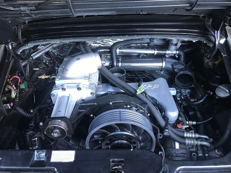

Just a few hours today.
Engine mount reinstalled. Added two additional washers per side to get the extra drop to stop the top of the SC unit from rubbing.
EGT and AFR sensors installed. Exhaust back on.
Eaton M90 unit and TPC bracket mounted.
New SC belt installed.

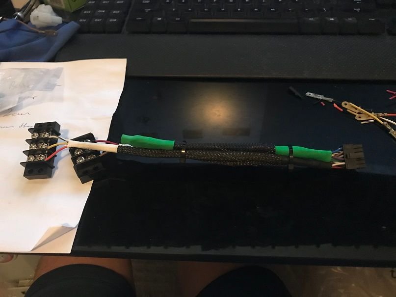

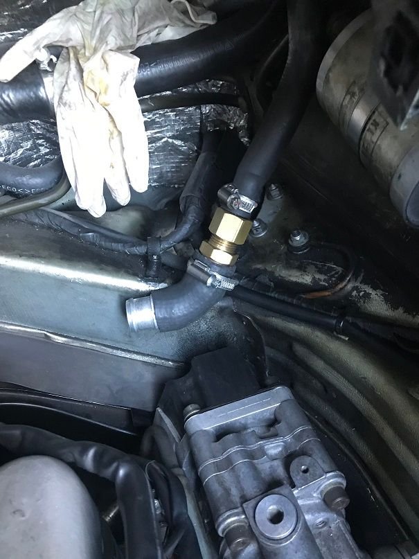

So I've been making harnesses and getting all the cabling and water pipes routed and cleaning up the install.
Some more powder coating came back - support frame for front AC and Oil coolers.
Water hose has been upgraded from AN10 to AN12.

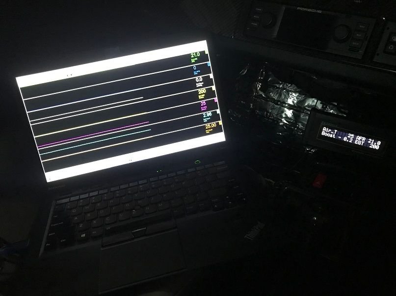

Telemetary gear wired up now - just need to clean up the wire mess.
We should be able to crank the engine up tomorrow and start looking for problems.

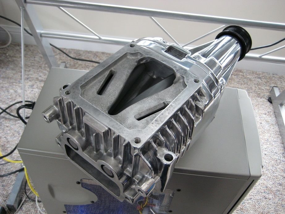

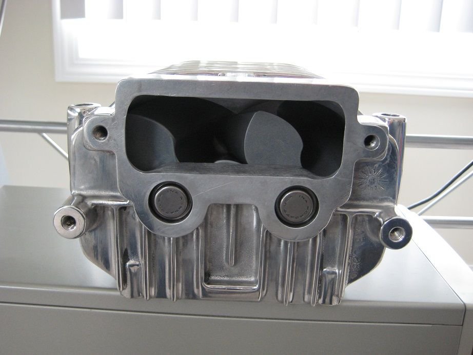

I wish I caught this thread earlier. You seem like the guy with the proper aptitude to explore blower porting. It's something that Ford Lightning guys have done extensively to the Eaton blowers. I don't know how it would translate to the TPC but if history is any indication a good chunk of top end HP can be found. Since torque remains unchanged it does not place additional burdens on the bottom end. The porting work focuses on the initial entry around the twin screw ends and the V shaped exit. Tons of info out there if you're curious.

Amazing work! Glad to see you're putting it back on! Had my TPC supercharger, TB and intake ported and matched by Stiegemeier Supercharger Porting.
Well worth the money. You should pick up the Clewett Pully that was another nice upgrade to the stock TPC unit. I've had no belt alignment issues ever since.
