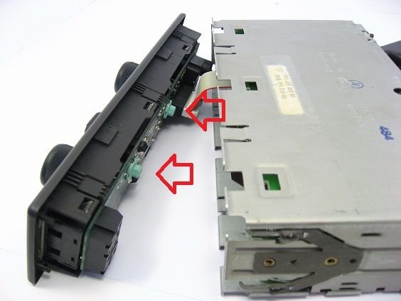

After reading a bit, are there multiple bulbs behind the HVAC CCU? It seems there are bulbs behind the switches for A/C and defrosting (yellow) and separate bulbs for the fan controls (white). ALL of mine are out, so could this be a fuse that's blown?

There are two B8.4D 0,9W bulbs for the dial and rotating **** backlighting. In addition, there are miniature bulbs inside the switches for backlight and ON lights. All of them are normal yellowish incandescent bulbs. Later 993 switches have LED lights.
The switch miniature bulbs are not at all easy to replace, and the switches are difficult to dismantle without destroying them. Search here on the forum for details. The switch caps disintegrate and the catches break off. I spend about an hour or two on two switches when refurbishing and fitting LED's in them.

Thanks, Tore. The photos are very helpful. This still has me wondering why all of the lights are out. That seems unlikely which has me curious about a blown fuse, maybe. Is there a fuse that would control the HVAC lights alone?
