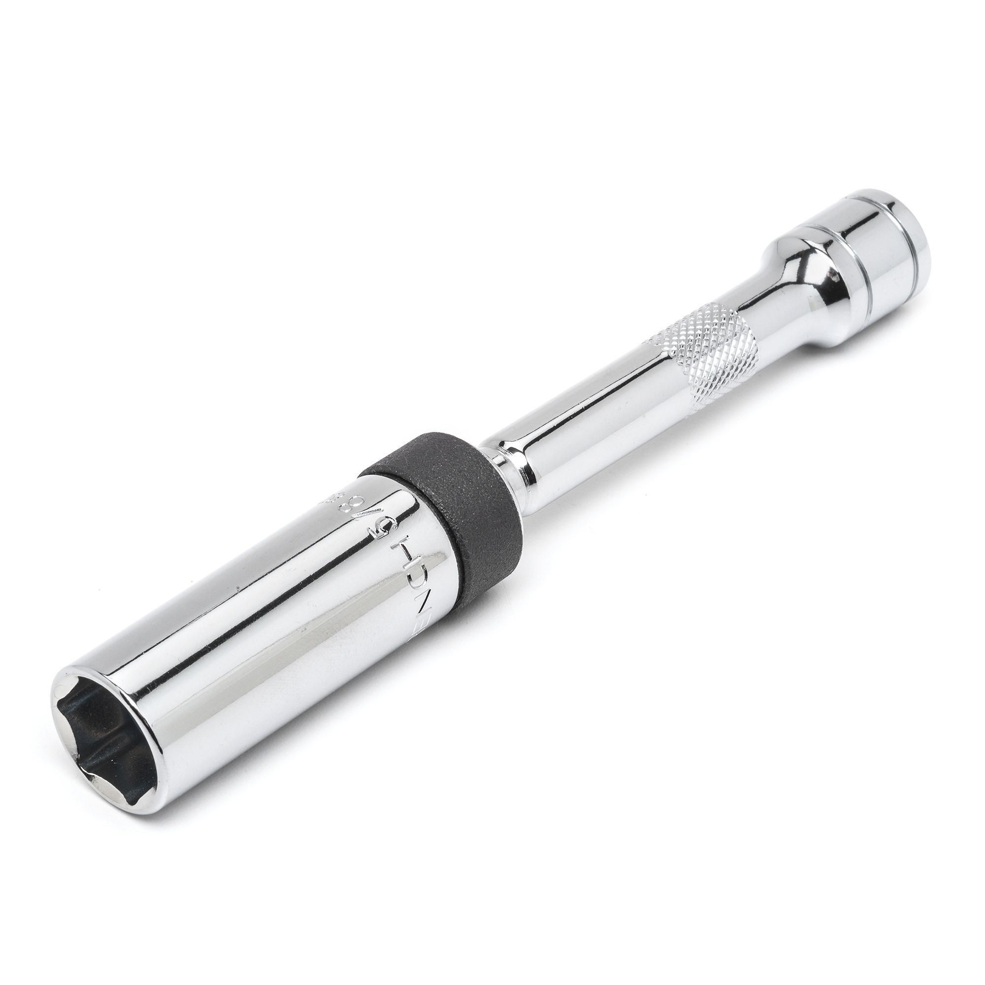

I use Bosch plugs and dizzy cap, Beru plug leads. If diying get the Snap-on wobble extension plug socket or even better and cheaper the Gearwrench 80546, allow all day and much cursing.
