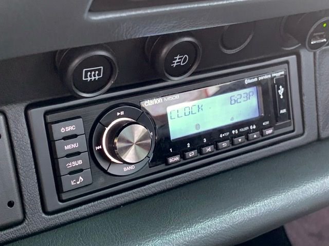

I replaced my Pioneer unit with the Clarion M508. It has an attractive simplicity that matches the interior nicely. I drive a targa so the chromatic display is quite nice, I can finally see the display while driving. It sinc’s up instantly via bluetooth to my iphone which was frustratingly slower with the pioneer. Power output is fantastic, it has 6 channels of RCA outputs that I run to my DSP before connecting to the amps. I cant even reach the point on the volume where audio clipping occurs because it would blow my ear drums. It’s made for a marine environment, so thats a bonus if i decide to go on an overseas voyage.

I like it!
Nice looking for our cars.
Clarion USA M508 Marine Audio Information Sheet
I like that it retains I-Phone/I-Pod control so I can leave the I-Pod in the glovebox.
It is only 18 watts RMS per channel, so for me, a power amp under the seat for the front speakers would be desirable.
It also doesn't seem to list a Digital Signal Processor (DSP) for low-frequency recovery/generation. So an external unit in-line with an external power amp would be an upgrade.
BX-10 x Digital Signal Processor for Bass recovery
Alpine Power Amp Alpine Power Amp
Some of the Marine oriented functions are a plus like the weather-radio function
does it display song title and info with Spotify? I like the look as well

To the person asking about spotify, I dont use spotify just pandora or amazon music. But with both of these it does display all of the info about the song title and artist and allows you to skip to the next song, fast forward, rewind etc.
