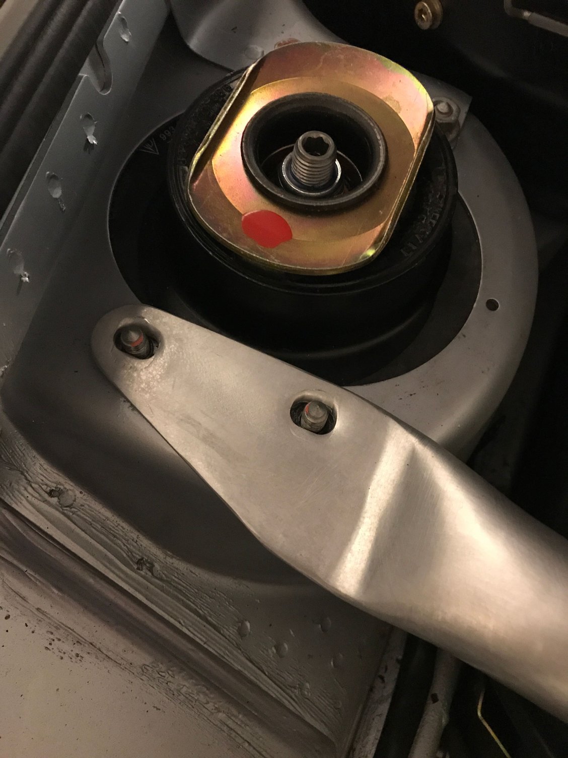

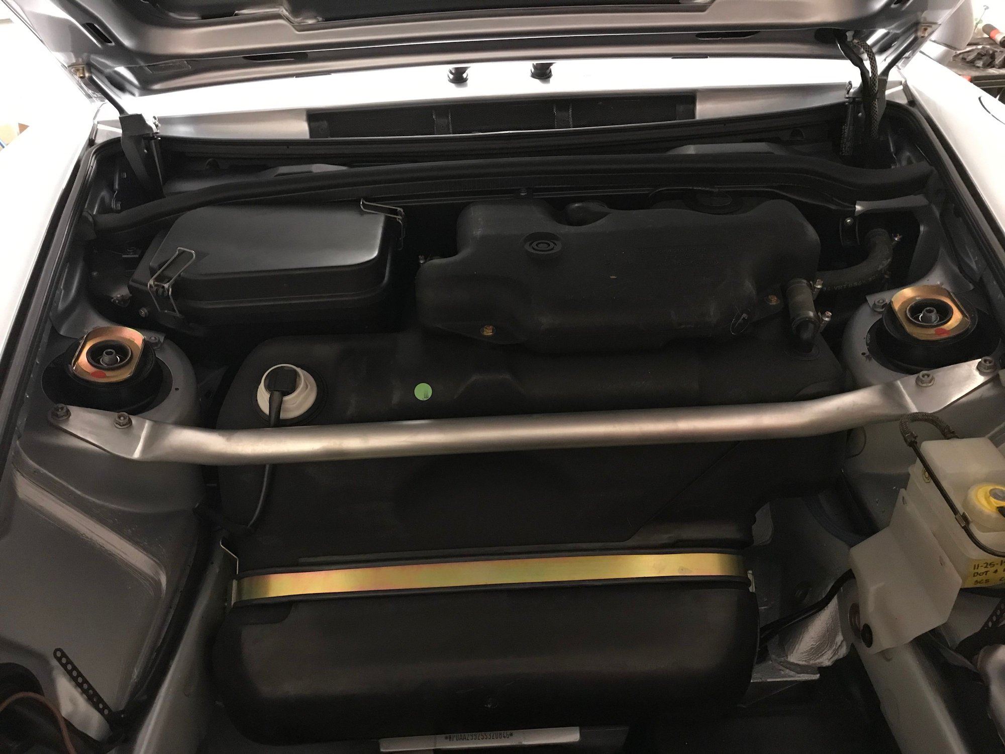

Here is the Fabspeed bar. I took the stickers off and de-polished it as I thought the mirror finish was a little too much. Fabspeed had them on sale a few months ago.

Is there adjustment on the fabspeed? Are the mount holes oval and it relies on clamping force or are the tolerances so precise that it just bolts on? Does it fit under the carpet?
One thing that impressed me about the RUF is that it has opposite threads like a steering link so you can tighten or loosen it and then it has jam nuts to lock it in place.
Good luck fabbing a fabspeed copy out of aluminium. If you can, you are a better fabricator than me (not saying much, to be fair). But generally, there is no reason why you could not fab one out of pipe or rod.

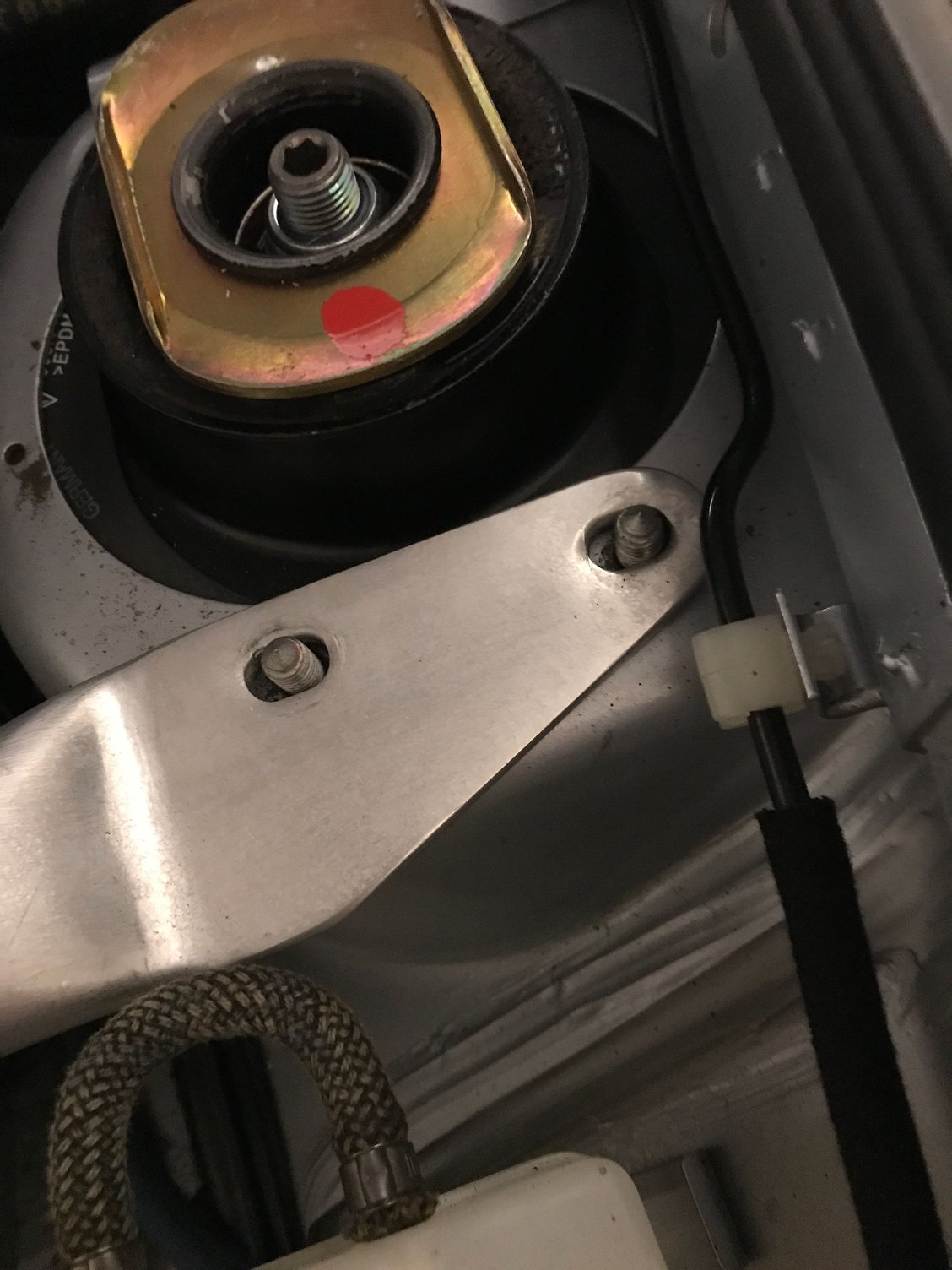

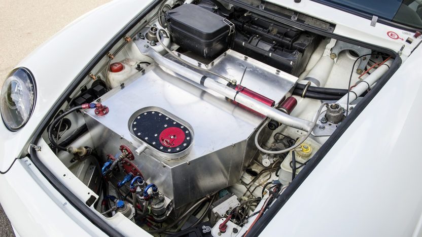

The Fabspeed brace is a copy of the GT2 EVO brace seen here. I assume it was designed properly by Porsche. I have never seen a real GT2 brace in person so I don’t know how close the copy is to a real one. The bolt holes on mine lined up exactly with the strut bolts (while the car was off of the front wheels) and it is not adjustable. If I remember correctly the bolt holes are round(not elongated) but I will check when I get a chance. I haven’t fitted the carpet over it yet, but it is very low profile and I think the carpet will go right over it.

Upon inspection, my bolt holes are oval.

So it allows movement which questions its intended effectiveness.
