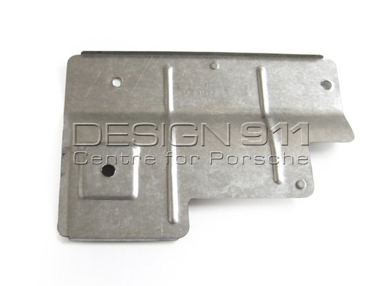

Factory exhaust: Can anyone tell me where this heat shield goes? I am stumped and the Parts Katalog doesn't show this actual part to my knowledge.

Doesnt it go over the flux capicitor?
...After searching, "various heat shields for Porsche 993", I came up with this.
https://www.design911.co.uk/fu/prod1...che-993-C2-C4/
Pipe-Heat-Shield-Porsche-993-C2-C4/​​​​​​
Zoom In (2)AIR DISTRIBUTION PIPE HEAT SHIELD. PORSCHE 993 C2/C4
Code: 99321121304Air Distribution Pipe Heat Shield.
Genuine Porsche product
Fits:
Porsche 993 C2 / C4 1994-98 (NOT Turbo)

It attaches to the inside of the catalytic convertor, nearest the passenger side chain housing cover.

I knew I could count on you, Andreas. Thank you.
The down side is now I have to take the exhaust completely apart again to put it back on.
--Maybe not. I can get it into place and have line of sight for connection points...we will see.
thanks again.

^ I think you can install the shield with the cat in place.

^tight fit but very doable.

Done! Had to tape a ratchet endwrench to a long pair of pliers..but done. Hacked up my hands..but done. Thanks, Buddy.
