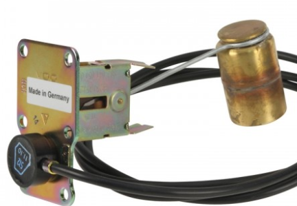

On the complete oil level sender unit the arm seems to be permanently attached to its pivot mount.
The float seems to be captured in a "C" shaped section of the arm, see the below photo.
The original posting mentions the float as detached and laying in the bottom of the tank.
Is he speaking of the float having slipped loose from the "C" shaped section of the arm
OR
The arm came loose from its pivot point and is in the bottom of the tank with the float.
In both cases fishing it out through the sensor's mounting port with a pair of hooks made from coathanger wire should be no biggie.
I would order a fresh gasket for remounting the sender once it is reassembled or replaced.
Andy

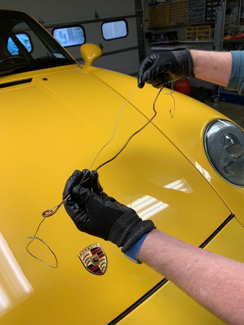

Thanks guys for all of the suggestions. I tried to use the collective information and ended up making a lasso out of picture hanging wire with a stiff piece of copper wire to support it.. Worked on the first try.
