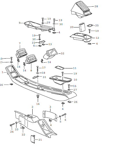

Thanks to everyone who replied! My next question is - how do i get to the Ebrake to make the repair?
Old Aug 2, 2018 | 03:25 PM
pp000830's Avatar
pp000830
Joined: Jul 2004
Posts: 10,597
Likes: 2,049
From: Dallas, TX
See the screw #19 locations:
