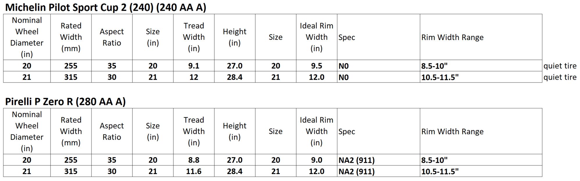

The newish Pirelli P Zero R tires seem like a potentially excellent all round tire for 992 Carrera models (992.1 Base, S, GTS & 992.2 Base, S). In Tyre Reviews testing it got the best dry lap time, even slightly beating a Michelin Cup 2 and performing much better in the wet. There was no comment on track durability. It was interesting to note that the Cup 2 was actually the quietest tire in test by a good margin. Note sizes listed in table below are one size up from the standard 992 Carrera size tires, but work fine with the OEM 8.5 x 20, 11.5 x 21 wheels (no rubbing or other issues). Both Pirelli P Zero R sizes listed below are currently in stock at TireRack.
