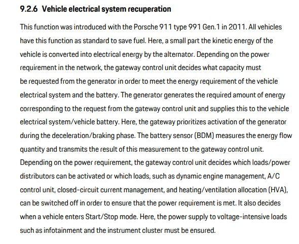

@mlrtime3 @CJDCREW After having the dealership look at the car and sharing data with Scott and him reviewing it, it looks like the car is charging the battery as it should. The conclusion was the algorithm that derives the state of charge (SOC) in the Antigravity Tracker Plus app does not do a great job with this car, so that metric in the app can't be trusted nor can the "Charging" status or lack there of. Scott's advice was to focus on voltage. Even doing that, you can see that the car rarely starts charging the battery immediately, but eventually it does. Sometimes it might take 20 min or more before you see the voltage come up. Some of that probably has to do with the recuperation function (see below), which is probably throwing off the app algorithm as well. I did successfully do a 4-day trip in the car running the AG 40ah battery and didn't have any issues, but I was also careful not to rip through a bunch of starts without getting some driving in, which is easy to do where we were. Probably a downside going go with the lower amp hour battery, but I think if you are smart about it, it shouldn't be an issue.

I’ve seen drops in the data as low as 12V and spikes as high as 15V, but normally it will drop to around 12.9V after one or two starts, but work it’s way back to 13.2V. It doesn’t sit above 13.2V very often and usually it’s a spike or a short period as seen in the data. When I’m watching the voltage while driving, it seems to climb back to 13.2V, but might take an awhile to get there sometimes.
