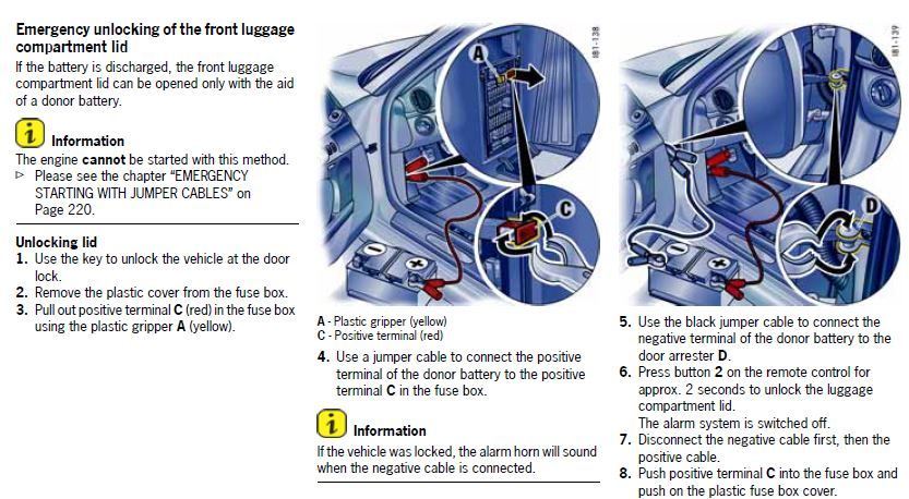

After a tire blew out and while waiting for the flatbed for 30 min with flashers on... my 4 year old battery went dead.
Unfortunately I didn't pay close attention but the AAA guy reached up in the driver's side footwell to connect the +/red jumper lead from his battery pack. Ground to the door frame and the frunk opened up from the frunk switch near my left knee (ie, didn't use the fob).
Key point... didn't use the special access point in the fuse box. (BTW, for those that don't know, if you connect to the fusebox pullout you have to use the fob to open the frunk - I learned the hard way but I'll leave that story for another day)
Anyone know where that positive/+/red connect point up in the footwell is located? I looked up there but didn't see anything (to my untrained eye).
Thx!

You need to open the fuse box cover, then pull a red tab, and it will expose the metal for the jump point.
Here is the picture that may help give you better idea
And here is a video (on boxster but its simiar on 992) which shows how to do it

There is only the one red fuse pullout. Jump Boxes have microprocessors in them that protect circuitry and I have found they will not power the fuse pull-out - UNLESS. you disable the safety internals by pressing and holding the Boost switch, then you get 12v for better or worse (make sure your polarity is correct!)
