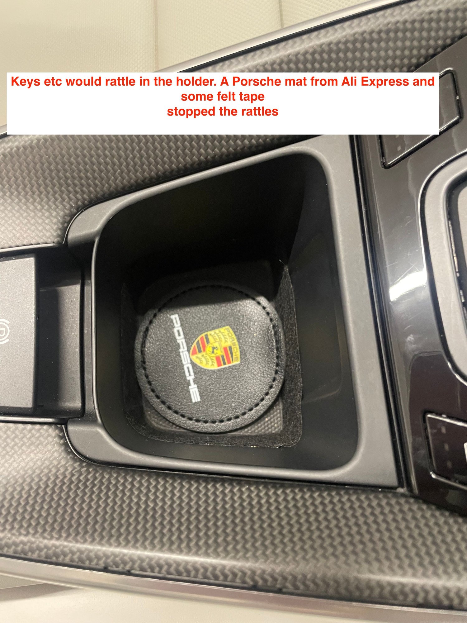

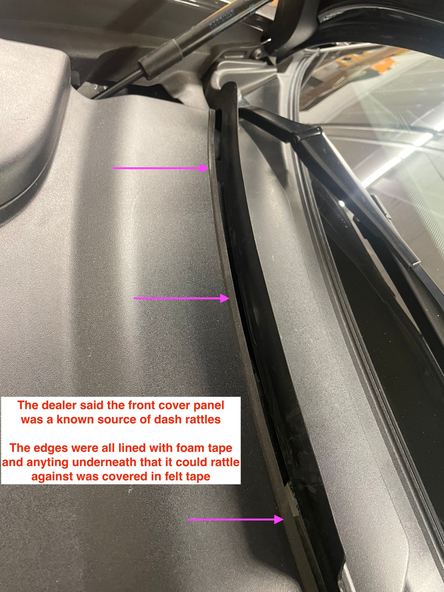

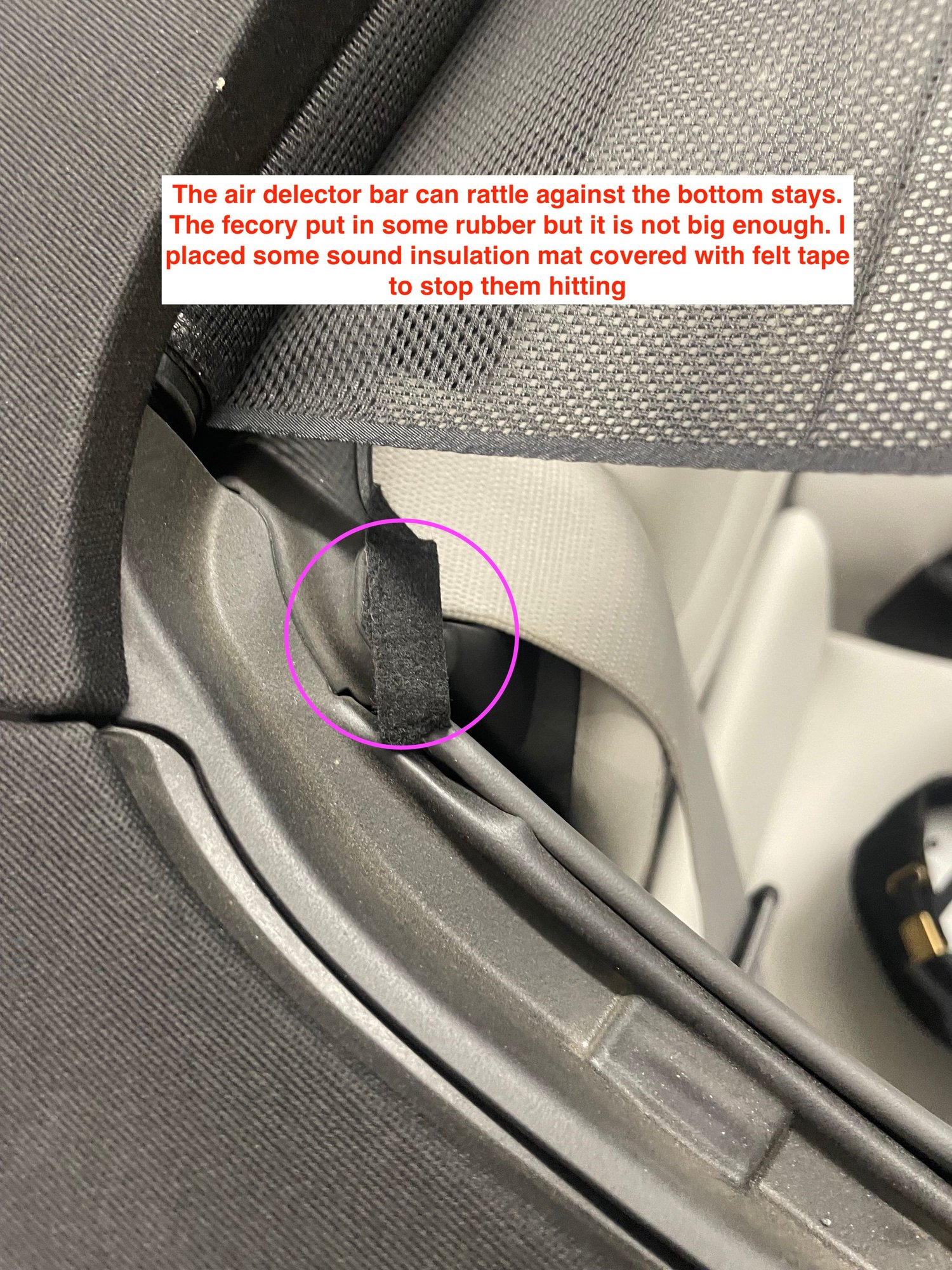

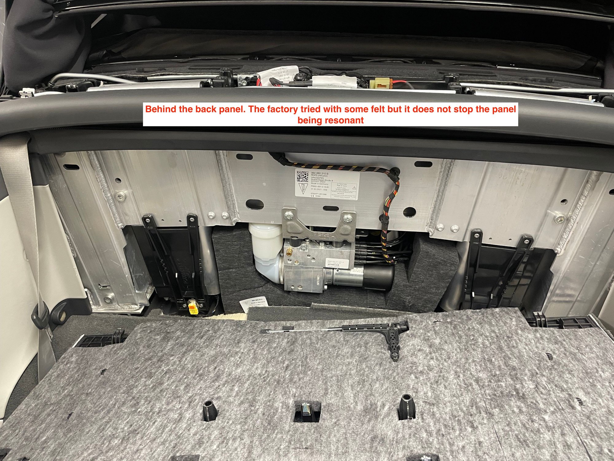

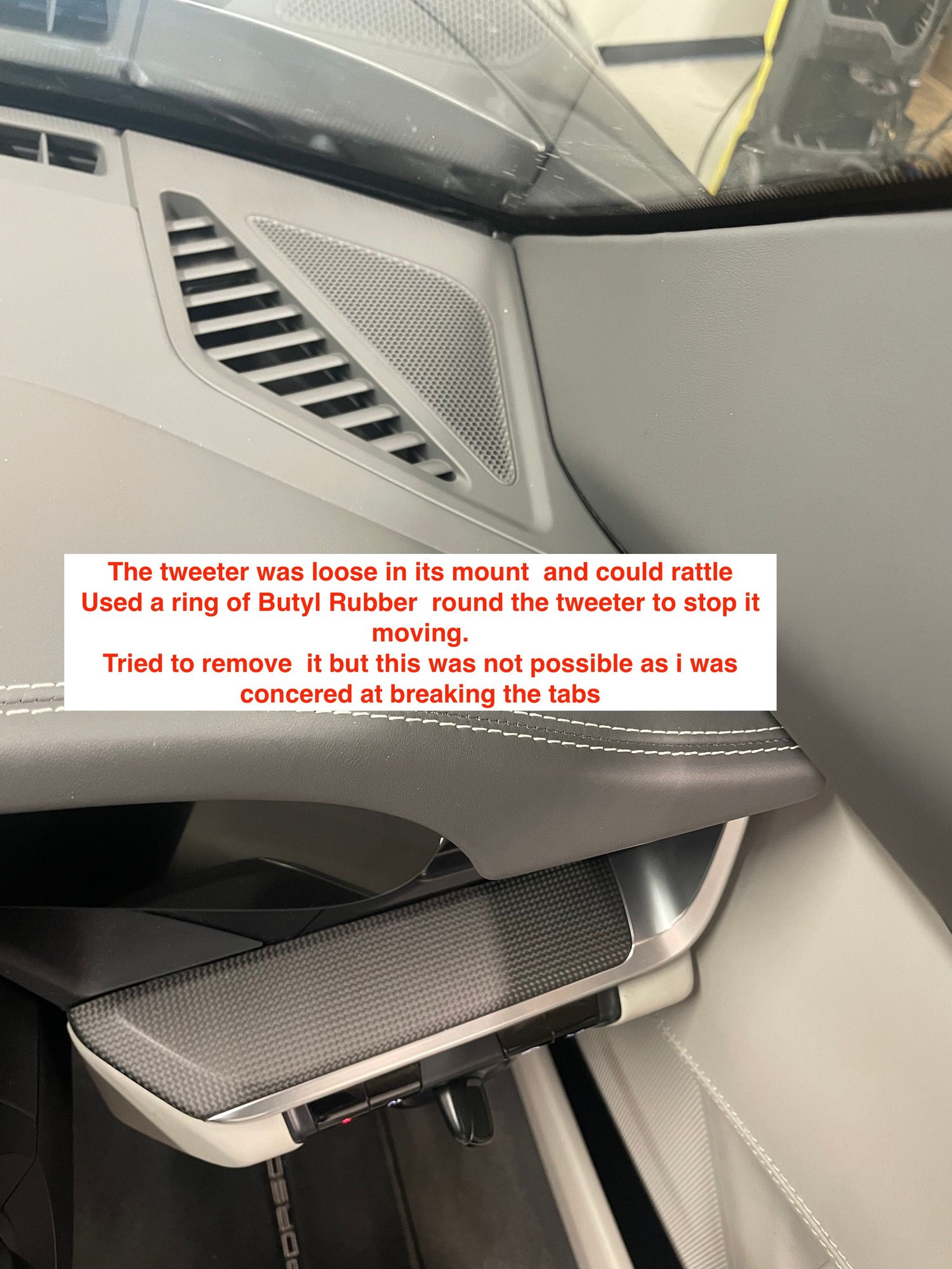

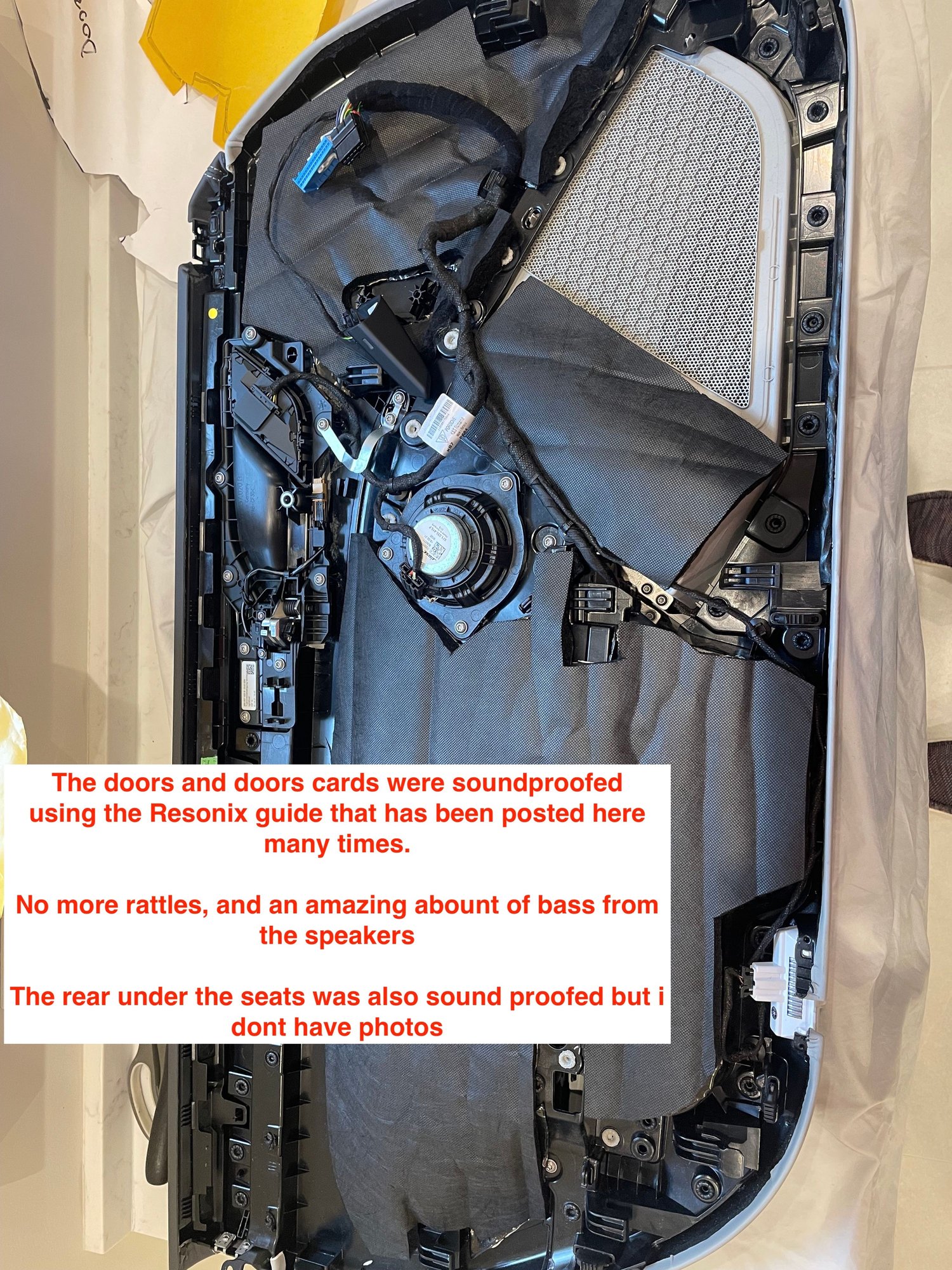

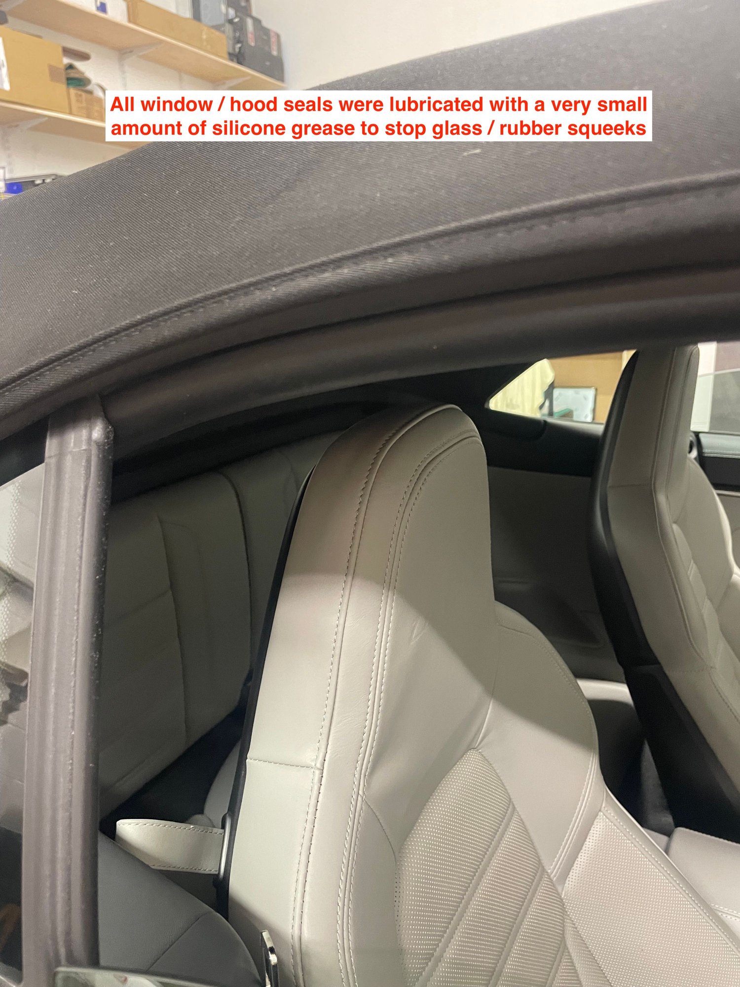

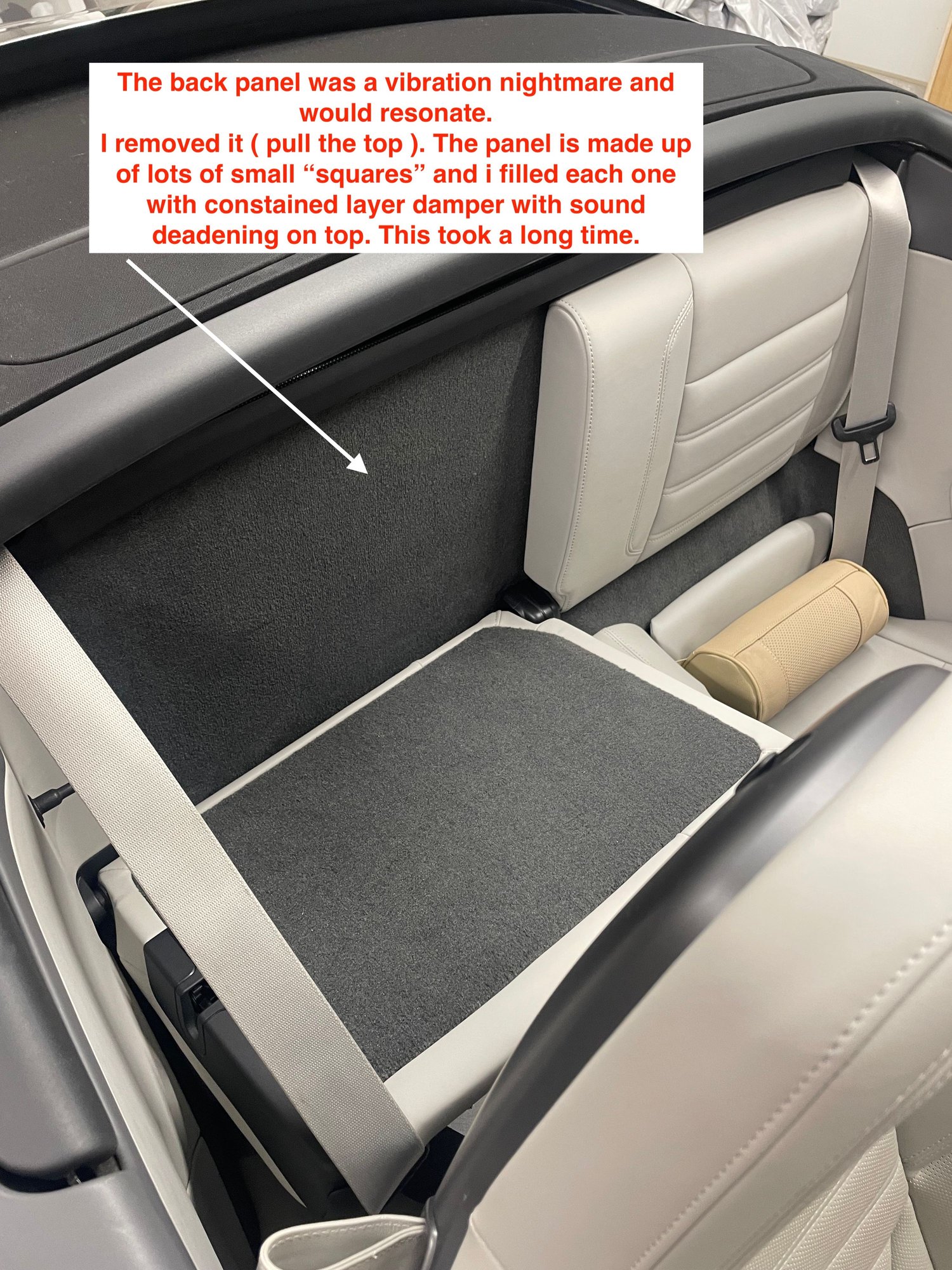

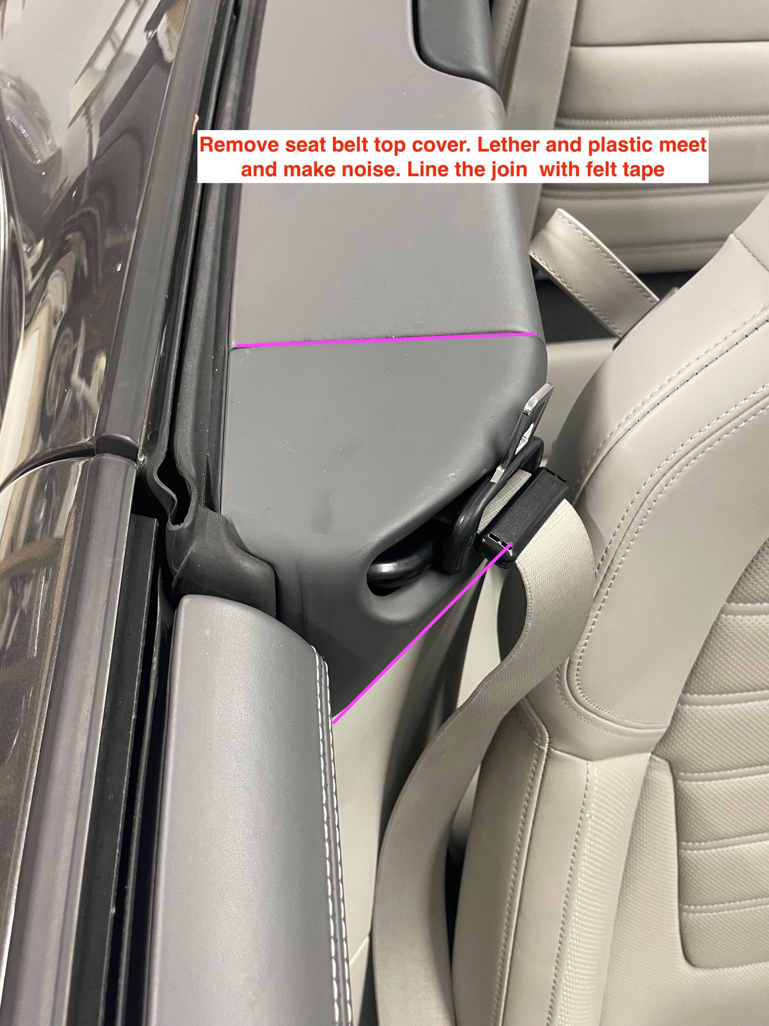

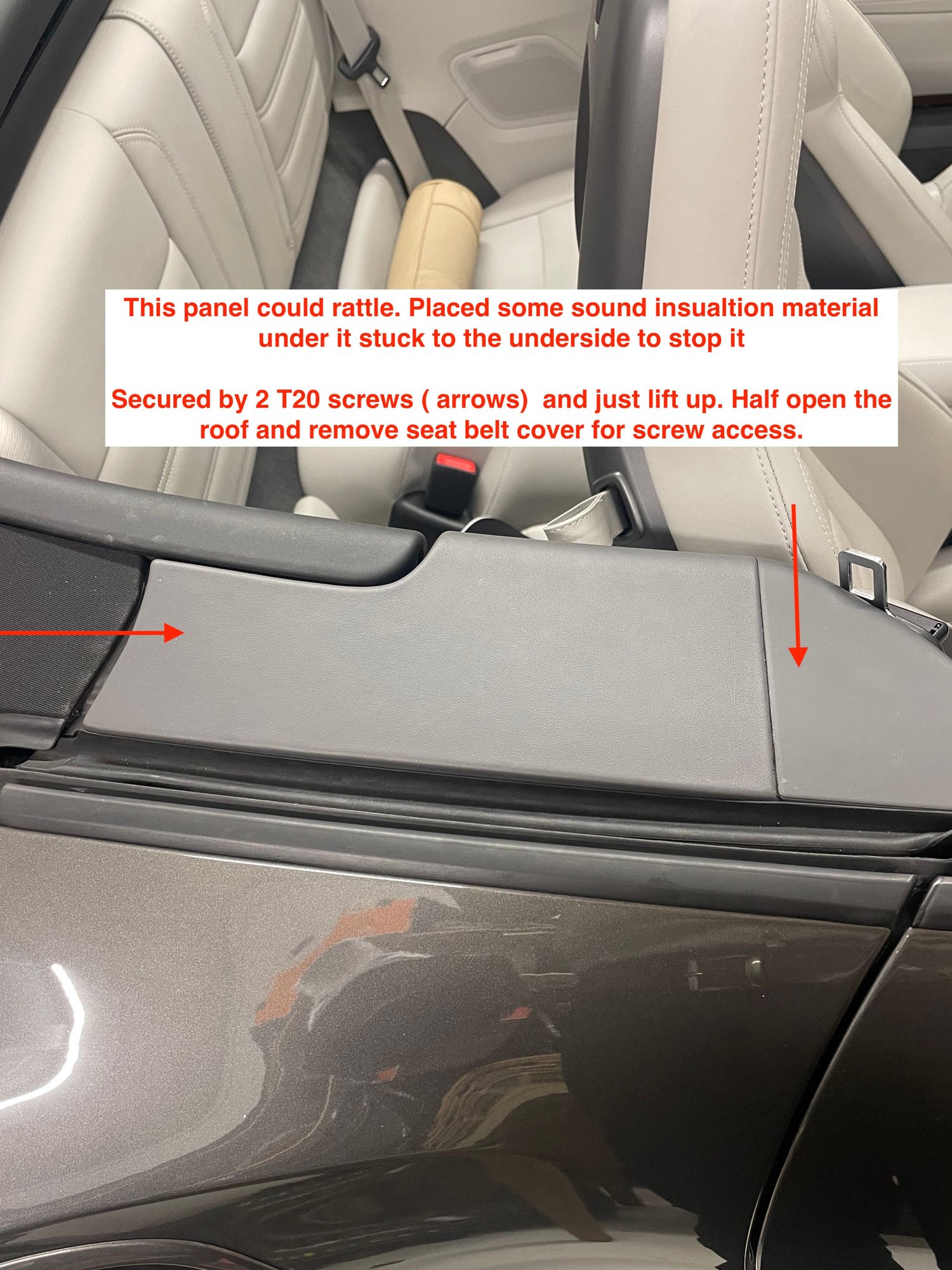

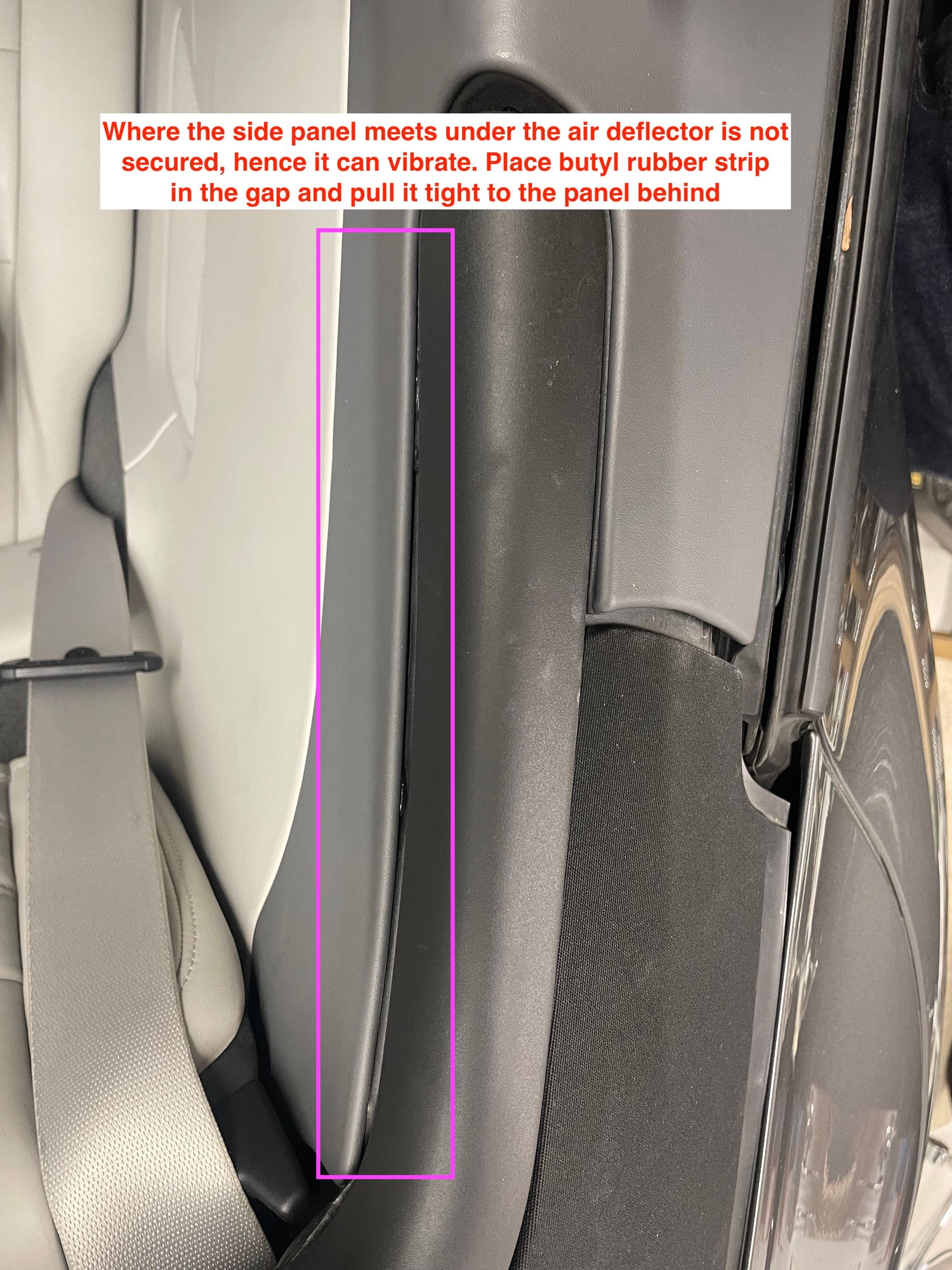

Below is a series of photos with annotations saying what I did,
I have also completed the Resonix sound proofing per their videos ( using UK materials) with just the wheel wells left to go - I have air filters and plugs on the way and will remove the wheels just the once to do these jobs together.
The side panels at the back are pretty flimsy but there was no point in removing them to sound deaden as there is really no clearance between the panel and the hood mechanism - adding anything would cause mechanical issues.
The best technique to find the rattles was simple to thump bits of the car with the ball of your hand and find each and every rattle that resulted and fix it.
The car is to be frank transformed. I have nil rattles. and the sound deadening in the doors had the unexpected bonus of huge amounts of bass from the Bose system as the energy comes into the cabin as opposed to rattling the doors.

1. You will need to remove the screws that hold the flat top panel in place ( one of the photos above)

the seat belt cap slides forwards. Use a panel pry tool and it will pop off. It is fiddly to put it back on then suddenly it goes on.
This will then expose a screw. T20 torx
The other screw you access by having the roof half open and it is mounted horizontally. Pad the gap with cloths as if you drop the screw you will never get it back
the panel will then lift up ( there is I think one pop pin ) to about 30 degrees.
You can't move that panel further without removing the rear side panel but you can pad it out to stop the rattle.

Quote: the seat belt cap slides forwards. Use a panel pry tool and it will pop off. It is fiddly to put it back on then suddenly it goes on.

For those in the UK the materials I used were as follows
I was basically following the steps in this post
https://rennlist.com/forums/992-gt3-...reduction.html
There are also you tube videos.
The cabriolet has no spaces for the rear "stuffing" of voids ( watch the video and you will see what i mean ).
For the cab you can do
1. The door and door cards
2. Under the rear seats
3. The back " wall" behind the rear seats - together with some small exposed areas in the roof hydraulic pump area.
4. The wheel arches
I have not done the arches yet but will next week. The general reports are that the arches have the biggest impact on tyre noise.
The other stuff does reduce noise slightly but also removes rattles and resonances and gives you are massive boost to the stereo bass.
Constrained layer damper
https://www.deadening.co.uk/products...-3mm-bulk-pack
Roadblock
https://www.deadening.co.uk/products/dodo-mat-roadblok
I used this in the door cards over the constrained layer damper and the back panel and will also use it in the wheel wells
Dynacore over the top of CLD in the door cards
https://www.ebay.co.uk/itm/167071317630
Felt Tape
Amazon Amazon
Foam Tape
Amazon Amazon
Butyl Rubber
Amazon Amazon
Thanks for taking the time to document this. The seat belt cap is the only thing that rattles on my 2020 C4S with the top up and it's driving me nuts.
I haven't managed to remove it yet. It's very tight. Where do you insert the trim tool? I assume at the top? Also do you have to remove the thick weather stripping or just make some space to allow you to push?
