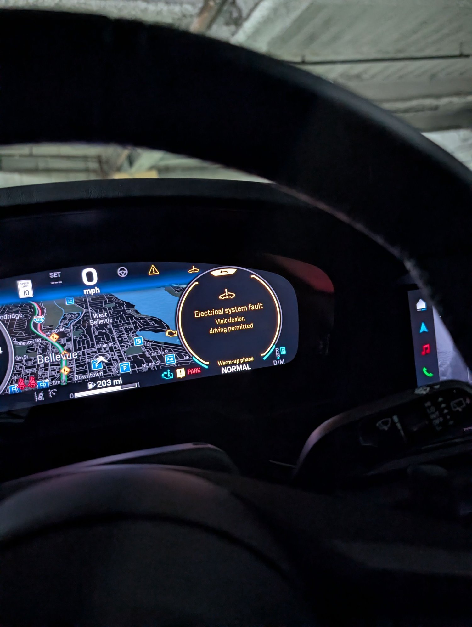

Default 992.2 GTS T-Hybrid: "Inept e-Turbo" Failure & the Day 29 "Customs" Dance
The Setup: 2026 Carrera 4 GTS (992.2), T-Hybrid.
The Incident: Limped my GTS into the dealer on March 24th after "Reduced Engine Power" and cascading "Electrical System Faults".The Diagnosis & The Wait:Credit where it's due: the service department diagnosed it quickly as an "inept e-turbo" (mechanical motor failure in the turbo unit). However, the car sat for nearly four weeks because the replacement e-turbo parts were "stuck in customs". It’s a bit concerning that for a flagship model, the critical hybrid hardware isn't readily available in the states.The "Day 29" Return (WA State):My SA just confirmed the parts are finally in and they are aiming for a pickup this Wednesday afternoon, April 22nd.
The Threshold: In Washington, hitting 30 cumulative days triggers the Lemon Law presumption of "unreasonable repair attempts".
Has anyone else dealt with these "customs" delays on 992.2 specific hybrid parts yet? Did anyone seek other forms of compensation for their car being out of commission?
