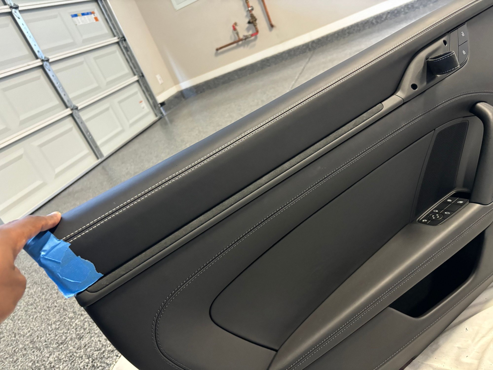

I took my 992 into the dealer a few months ago related to a driver’s door panel rattle and when I picked it up, the rattle was no joke 100 times worse than when I dropped it off.
When I got home I took the door panel off to see if I could see anything obvious like a clip that wasn’t reinstalled properly.
But I noticed that they removed the plastic welds and put in three screws with washer into the plastic. 1 was loose, so I retightened it, and 1 was stripped and cannot be fastened securely. So, in the interim, I just wrapped the washer with some Tessa tape to keep it from rattling.
I’m not really sure how to follow up with the dealer as I don’t feel like this is a proper fix.

Using self tapping screws is a regularly utilized way to secure trim. I used the same method on my upper trim.
That said, you can use epoxy - another commonly used/permanent method - to secure the screw/trim. It’s not worth taking to the dealership.
