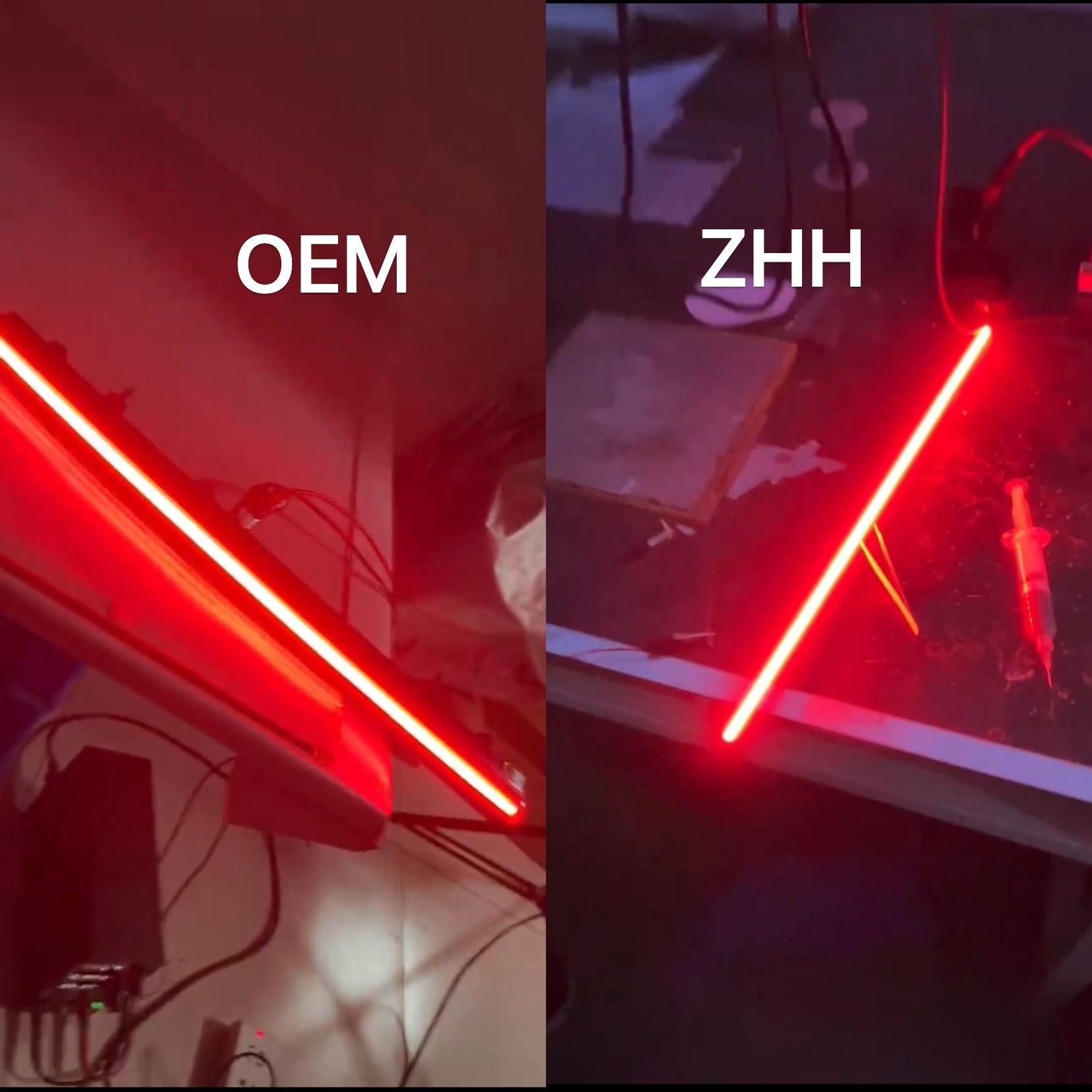

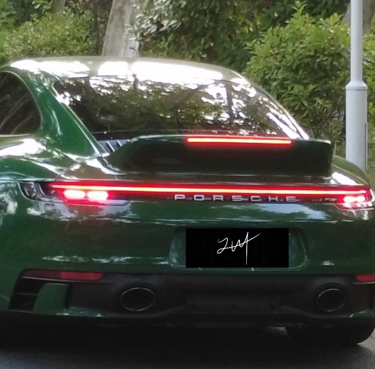

Originally Posted by MajTom
OK thank you Zhao. Can you provide any technical details about the light itself to understand durability and life expectancy? Sounds like if there's an issue with the light a whole new tail will have to replace. And do you have any pictures in darker lighting (or at night) with the brake lights on to see how it looks lit up along with the OEM lights?

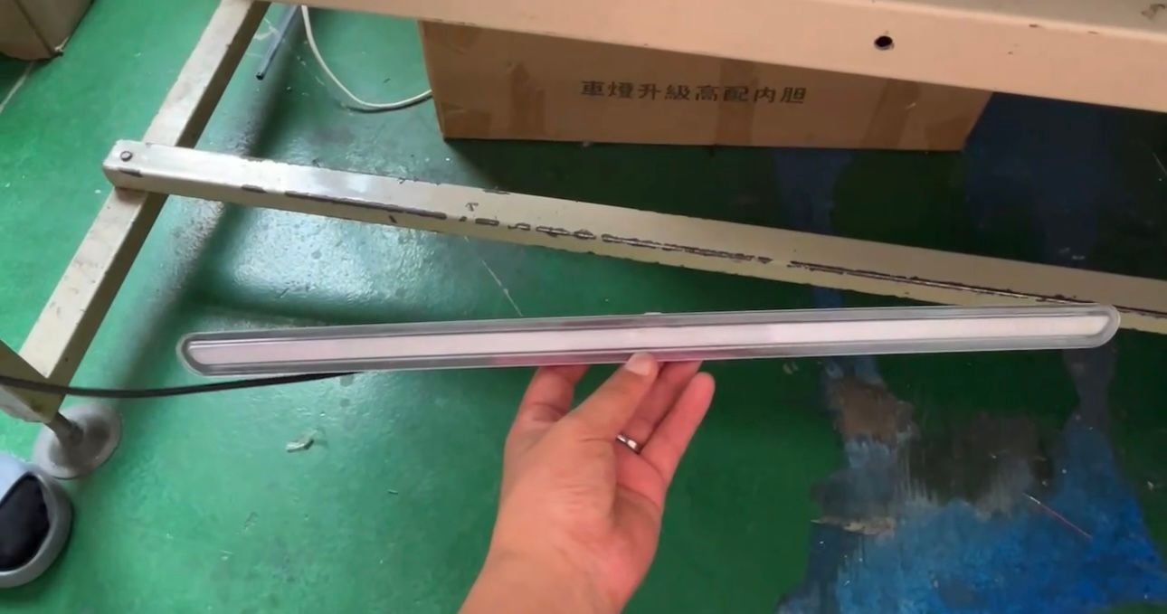

Throughout my entire research and development process, I found the lights to be the easiest part. The OEM lights are compatible with models such as the 991 TBS, 992 TBS, and 718 GT4RS. During development, I certainly had to compare them with the original factory lights, comparing the color and brightness. I have included the comparison images of the original factory lights and my own.
For the 992 brake lights, if they are not OEM, there will be error codes. I eventually solved this problem by using lights with the same power as the OEM ones.
OEM light
My brake light consists of three parts: LED light group, front and rear light housing, and light wire. In fact, the structure is very simple. This is just the simplest brake light. I found a professional car light development factory, and because it only has the function of lighting up, there are only two wires in the wiring harness. It is very simple and even has a lifespan. The factory told me that it can basically be used for vehicle scrapping. If replacement is needed, I can find a way. As long as high-strength sealant is not used internally before leaving the factory, 3M adhesive with lower strength is used for easy disassembly.
