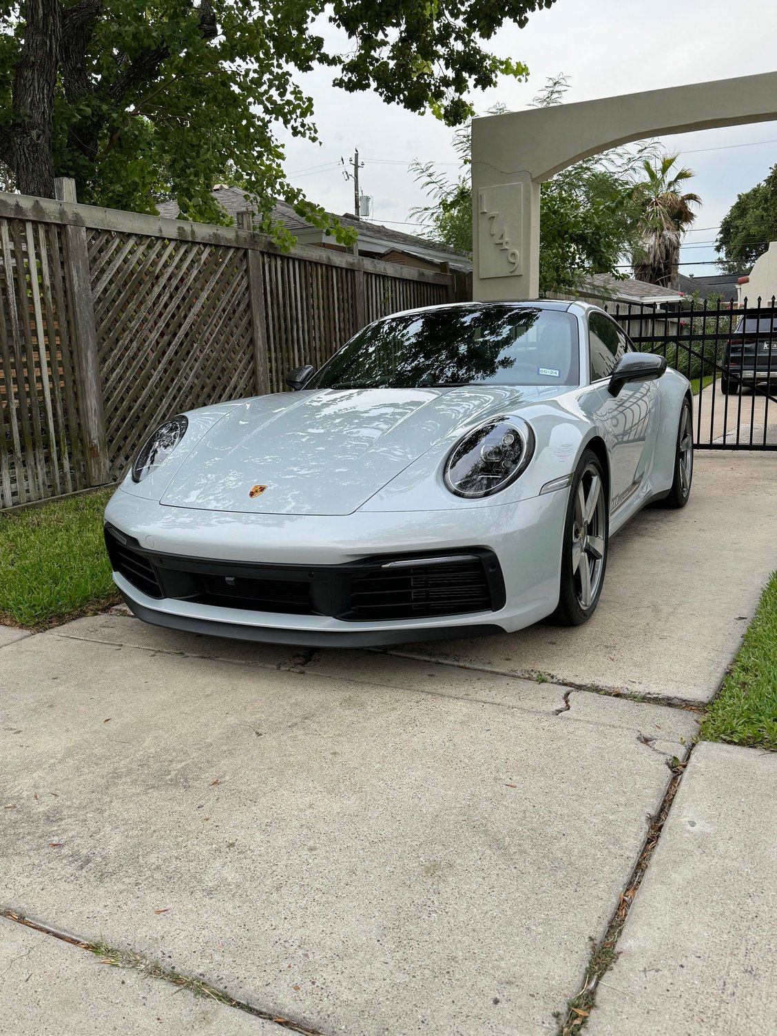

I just did Gtechniq CSL topped with Exo V5 on my truck and my wife’s M3. Easy to apply and looks great, amazing beading and easy washing:
