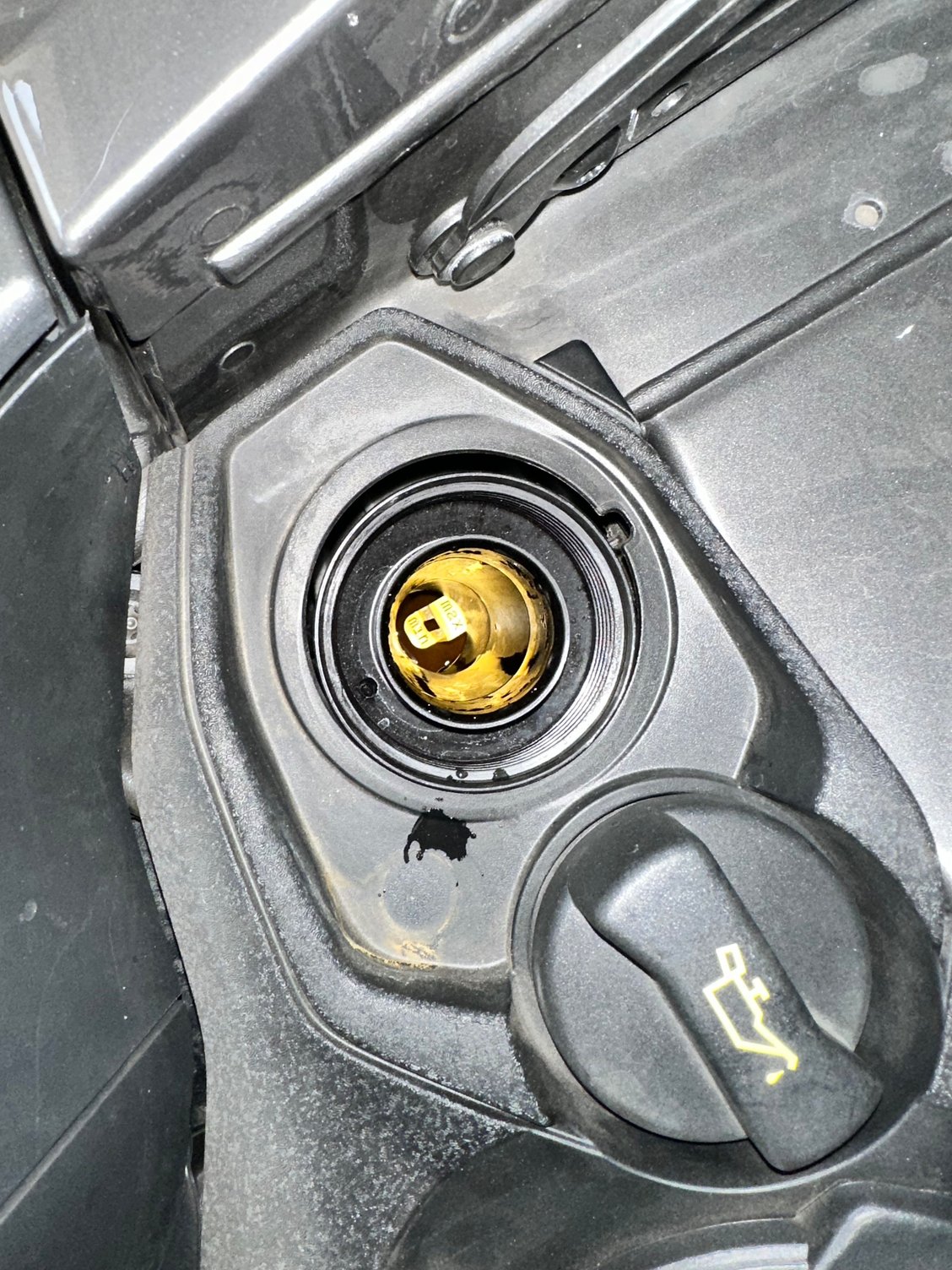

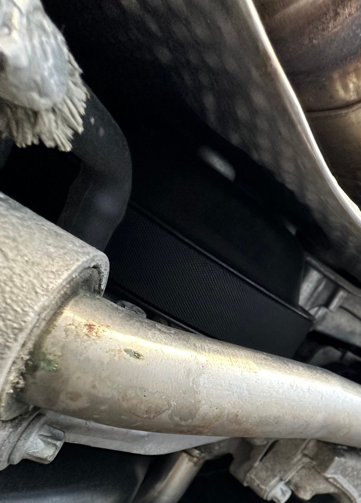

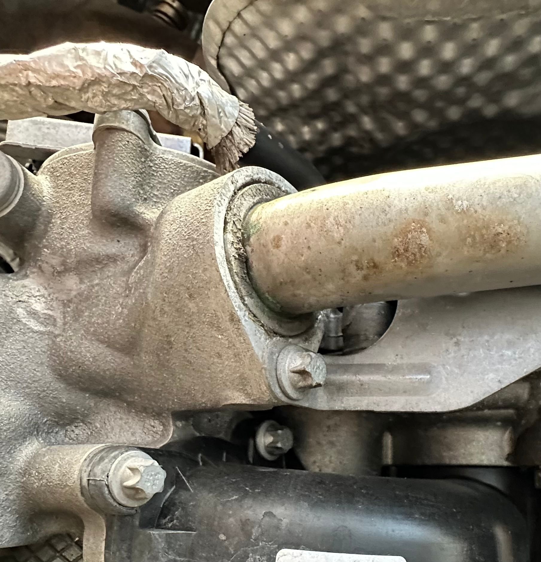

Got the message above last couple of days. Doesn’t appear on every startup but has a few times now. 2020 C2S with 12k miles.
Took some pics of the driver side manifold area that another member posted about a while back during their issue. Coolant is definitely low and seeing some green goo on pipe, if that’s indicative of a leak.
Anyone else experience this or seen this on their pipes? Will try to take to dealer soon. Car had a full service last month.

Coolant should not be green. It should be pink/violet. G12++ or Glysantin G40. (I think Autozone or one of the chains sells Valvoline G40 Porsche spec).
I don't see any obvious leaks in your pictures. Coolant should be above the MIN mark when cold. If you're losing coolant, that's a problem.

Thanks. I got back from the dealer yesterday; they could not find a leak anywhere and said it’s not unusual to have to top off every now and then, which is what they did. Though not sure how/if they performed a leak test. I just find it odd how it could be at such a low level. Engine temps have always been perfect however.
Checked this morning cold and I can see the coolant about near the level of Min now, will keep an eye on it for now.

Photo still makes it look like your are low.How can you track the level if you are already below the min level? What is the reference point then?

It looks like something is leaking from the pictures of the bottom of your engine.
