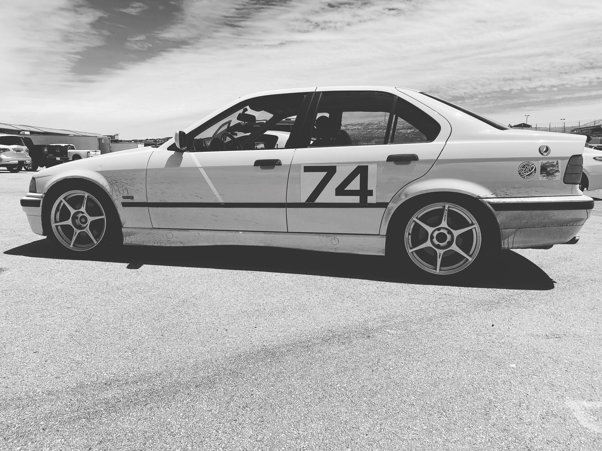

as much as I want to drive my 911 on the track , this will have to do
