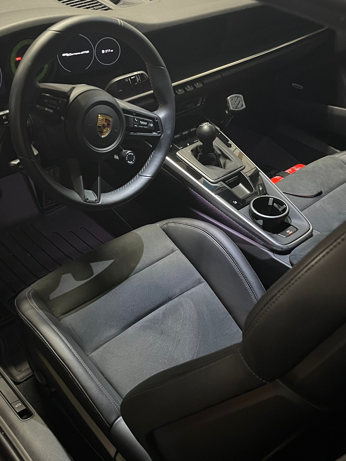

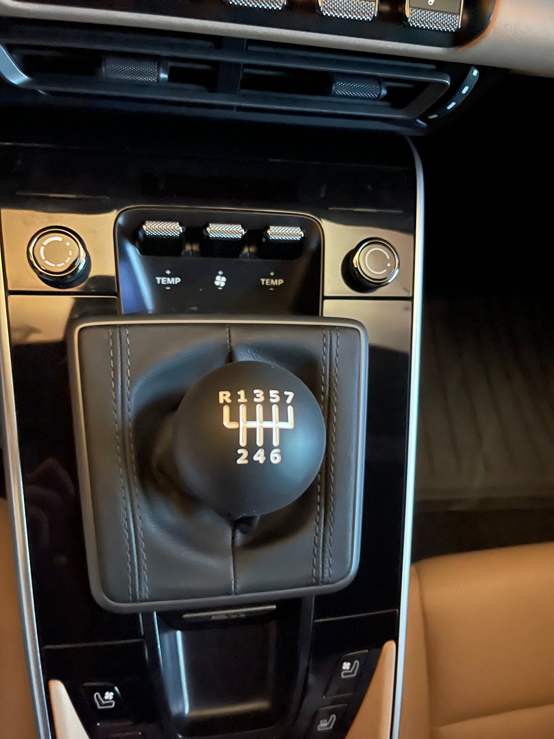

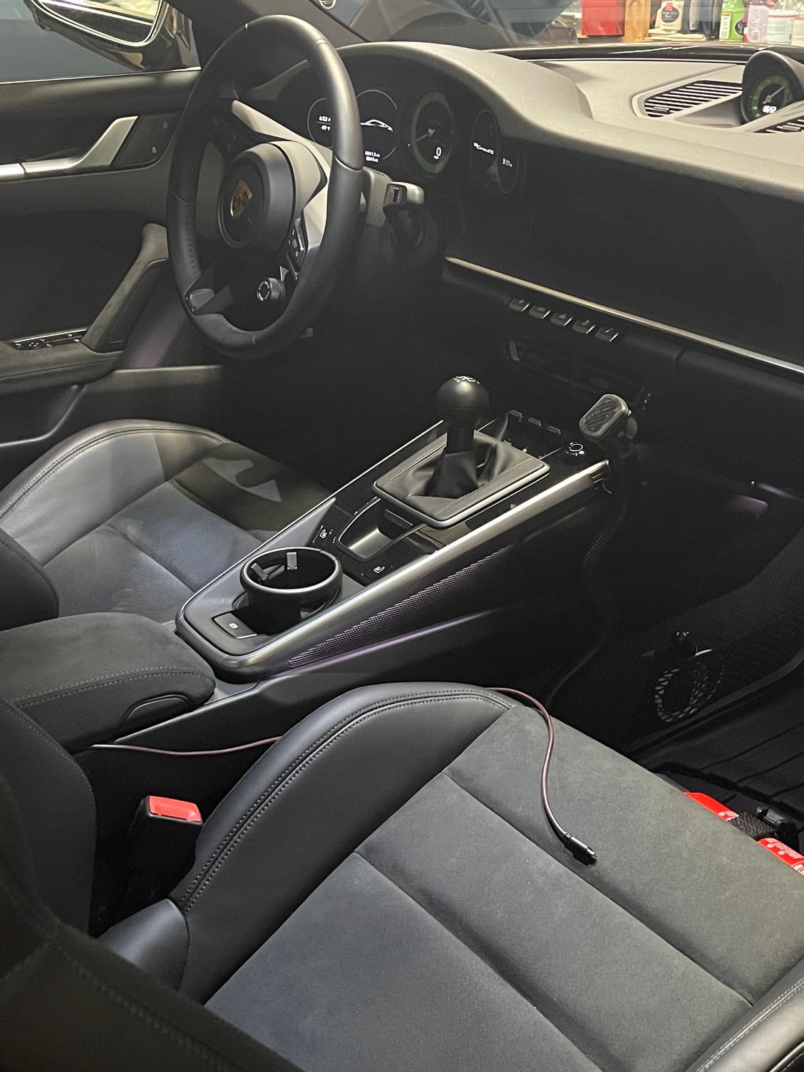

Old Dec 11, 2022 | 11:00 PM
philghill's Avatar
philghill
Joined: Feb 2004
Posts: 138
Likes: 165
From: North California
Brianja, here are few pics from further away, hope these help. Just a reminder this is in a GTS so it is a little shorter than non-GTS. Good luck.
Old Dec 11, 2022 | 11:10 PM
brianja's Avatar
brianja
Joined: Dec 2011
Posts: 708
Likes: 741
From: NYC
Thank you! I appreciate the time to share those.
It looks great.
