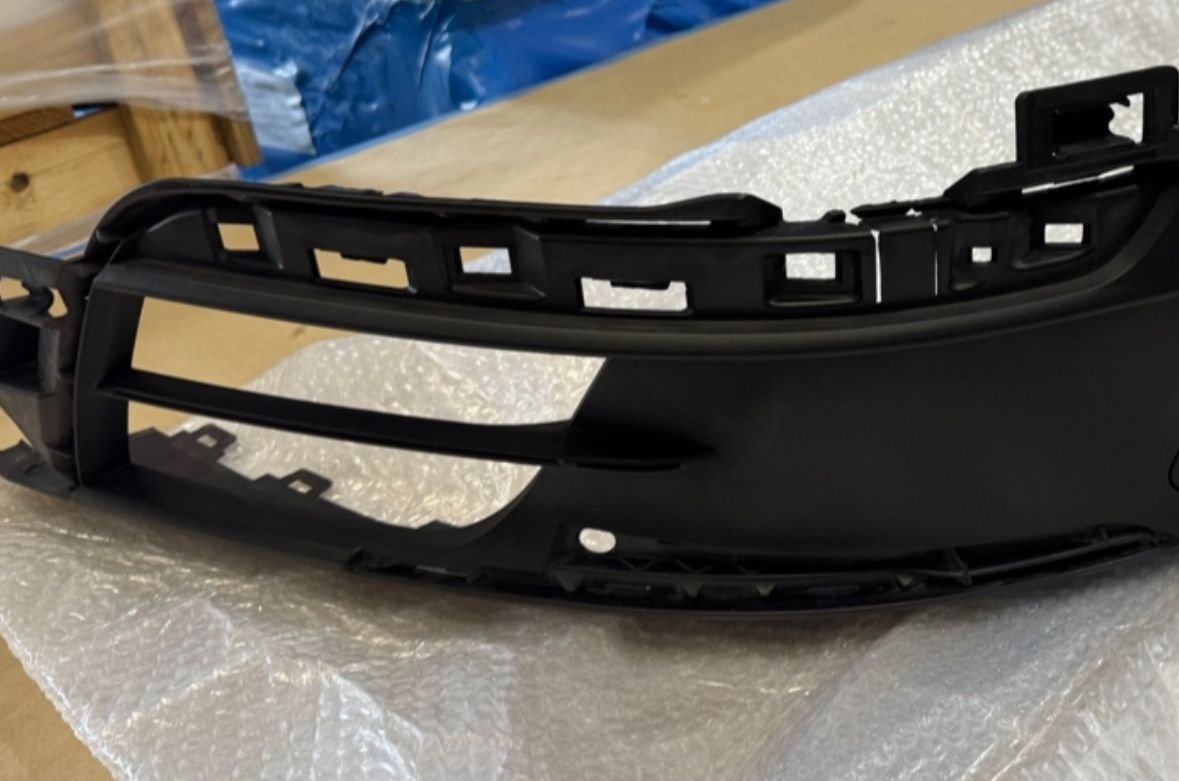

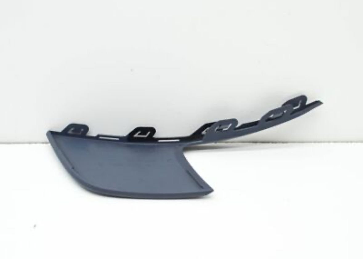

They are clipped in. Once you pull the bumper off, you’ll be able to see how the lower diffuser, rear reflectors and the fins are clipped in. The last time I removed the bumper I didn’t take pictures of the fins specifically, but it’s all very easy to discern.
Here is a photo that shows the tabs.

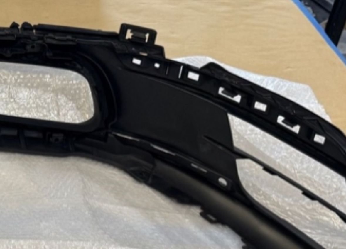

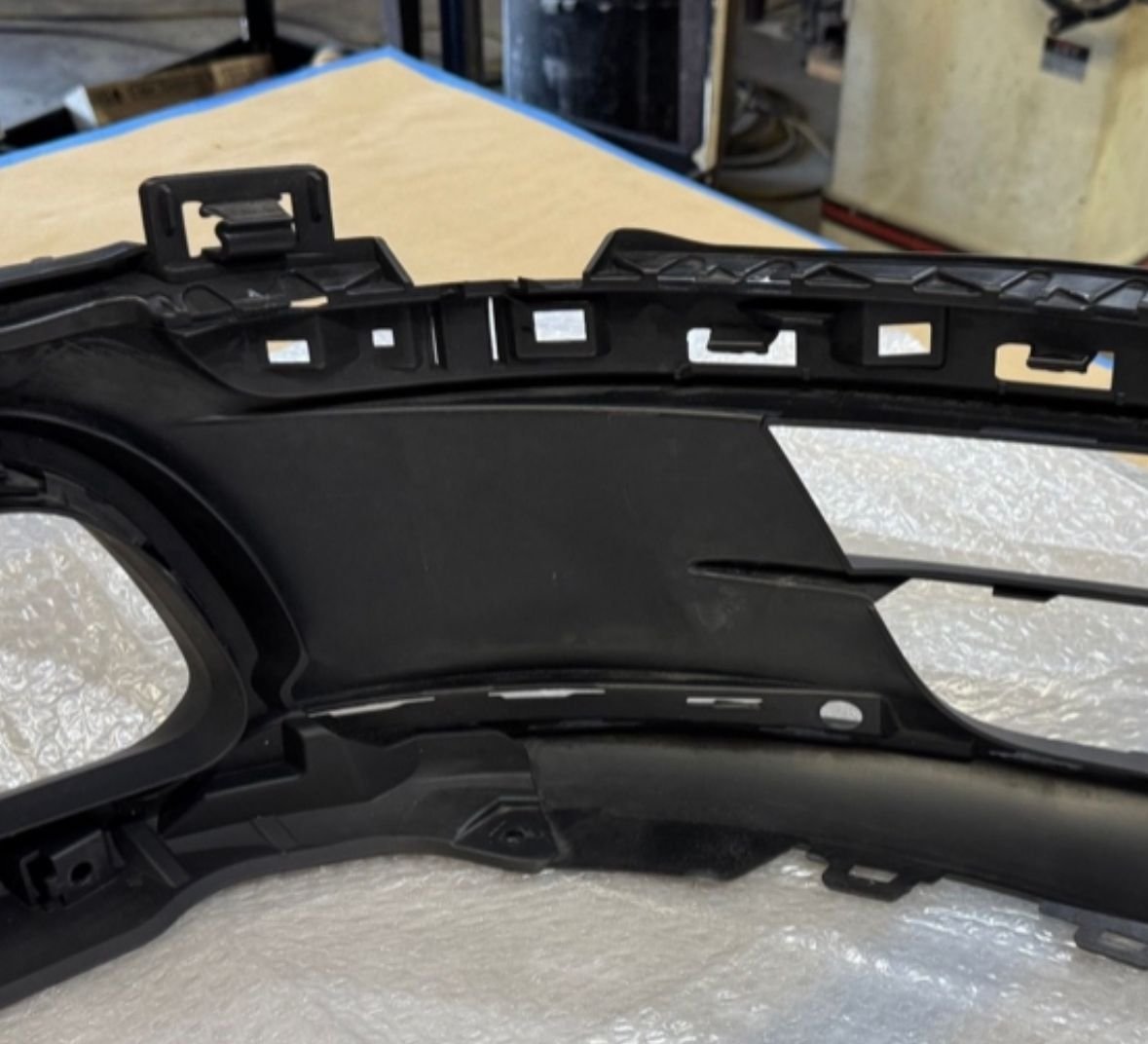

I mean, you can, but you run the risk of snapping a tab, damaging the bumper itself, etc. Those tabs are a pain in the ***, so the safer bet is to just pull the bumper, depress the “release”, and remove them that way. The bumper takes 20 minutes to pull off [for AeroKit 992’s], so it’s not too time consuming.
Here are a few pics of the lower diffuser where the fins clip into:
