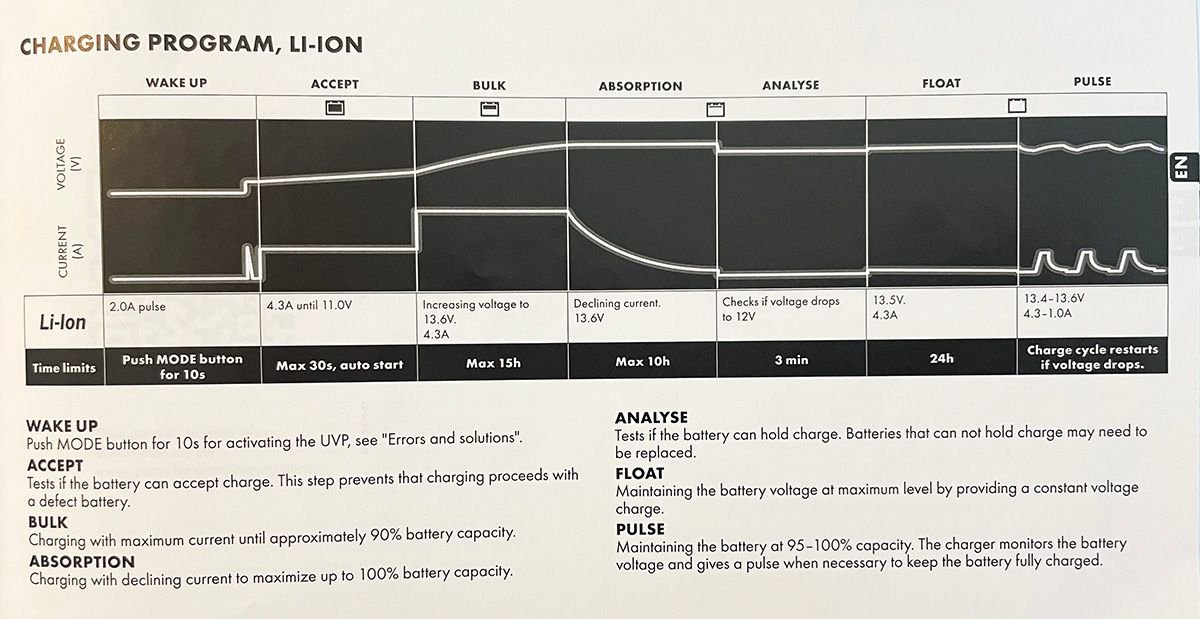

It might well be as simple as buying a "generic" LiPo charger and you're good to go. Looking at the charging profile information from the Porsche Charge-o-mat Pro Manual (previous versions were rebranded CTEK units, as this one likely is as well) there is a specific charging sequence/protocol. Is the Lithium charging process the same for all batteries, thus the charger/maintainer is immaterial? I don't know.
What I do know is that my Porsche LiFePO4 is pretty sensitive, and I've already seen the car's electrical system shut down by simply running the audio system for a couple of hours while doing a wash/detail, followed by 12 hours at a very small power draw to run my 2-ch dashcam(s) in parking mode. I also suspect (but don't know for sure) that a replacement Porsche LiFePO4 battery is likely going to run me north of $1000 (maybe substantially more) rather than the few hundred that an AGM replacement would cost.
My Charge-o-mat-Pro was in the frunk of my 992 on delivery, along with winter mats, at no cost. I picked up a set of alligator clips from the dealer for about $40 CAN that plug into the lighter socket on the unit, enabling me to run the charger/maintainer without doing the 12v socket dance. Paying the Porsche premium on the Charge-o-mat likely not necessary as the CTEK probably uses the same charging program. However before hooking it up - or any other lithium charger/maintainer - to my 992 LiFePO4 I'd want to be CERTAIN the charging profile is the same.
Overthinking it? Maybe. This is the first LiFePO4 battery I've had in a car, and using the Porsche branded charger/maintainer gives me confidence that it's going about its business according to Porsche protocols. If my battery goes south for any reason in the next couple of years, I don't want the dealer or Porsche pointing the finger at a $50 Costco charger as the reason my expensive battery went kaput. At any rate, my charger was free, and it's currently doing stellar rotating "maintainer" duty on three motorcycle batteries on the counter in a spare bathroom: thanks for that Porsche.
Below is page from the Porsche Charge-o-mat manual.
