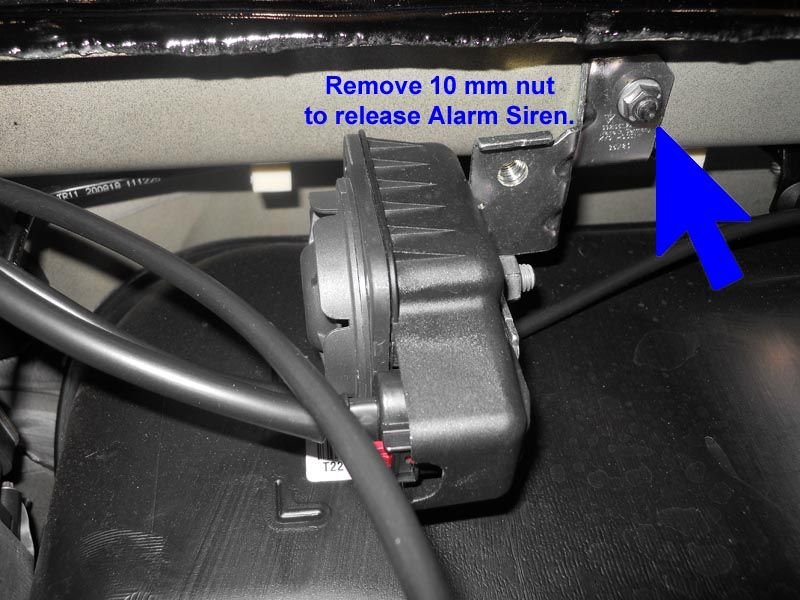

Here is how to silence the Panic Siren. Simply unplug and if desired you can also remove the Siren as I did.
The car doesn't have any problems with this.
This is easily reversible.
The only Tool required is a 10 mm Wrench.
Time invested is less than 2 minutes.

I don't have my car yet to experience first hand, but i assume that the siren doesn't control the panic feature, only the sound. If you disconnect or remove the siren, wouldn't the car still be flashing the lights in response to the "panic".

Yes, all you're doing by unplugging the siren is to eliminate that particular function.

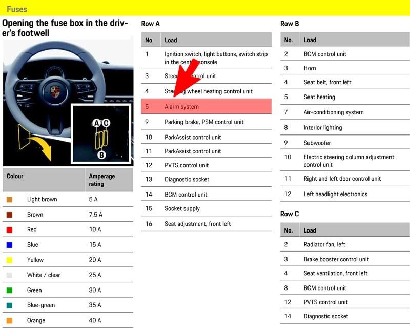

If you wish to disable the entire Alarm System one could pull Fuse "# 5" in "Row A" of the Driver's Side Fuse Box.
