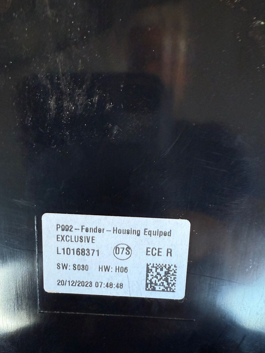

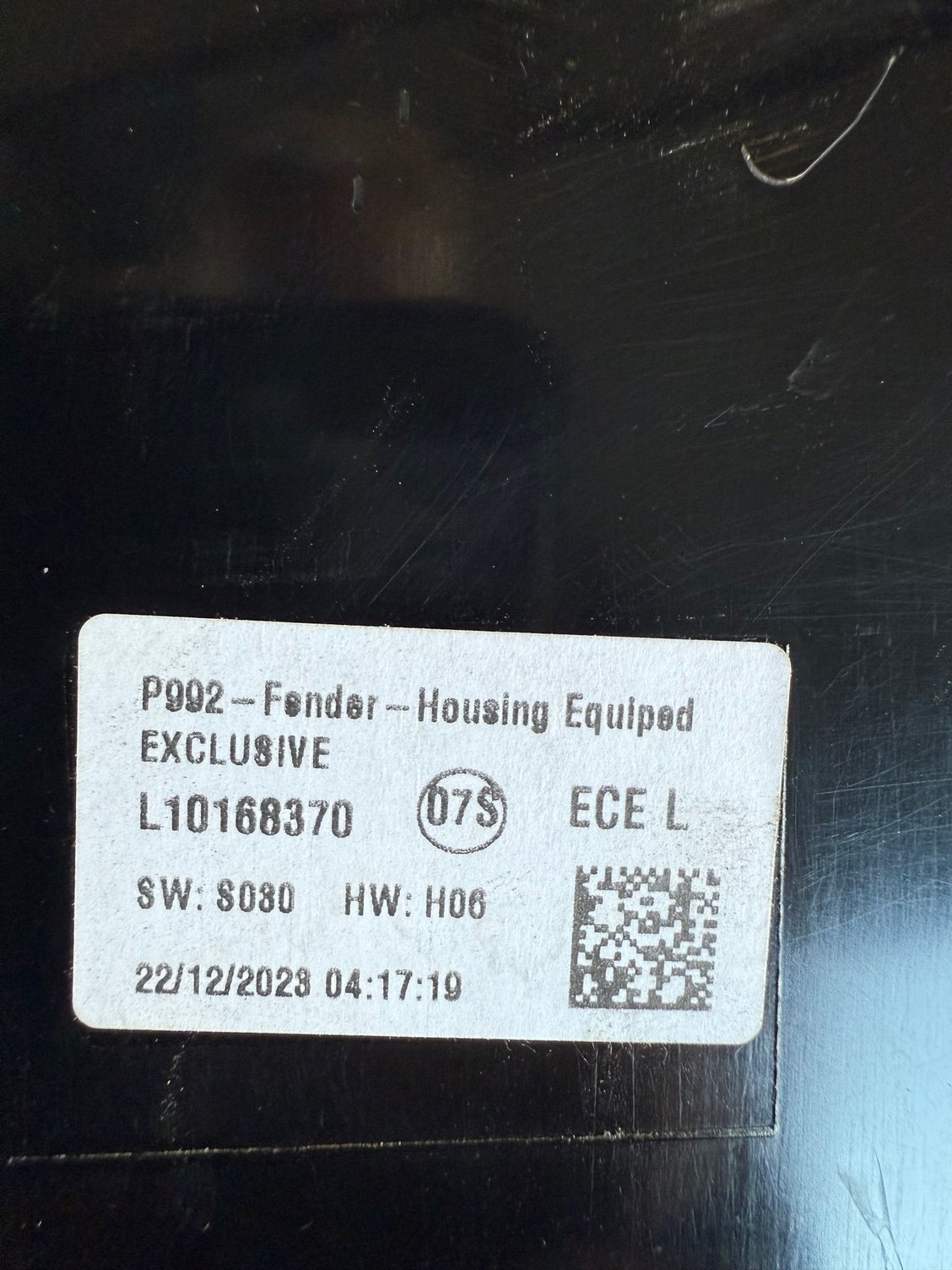

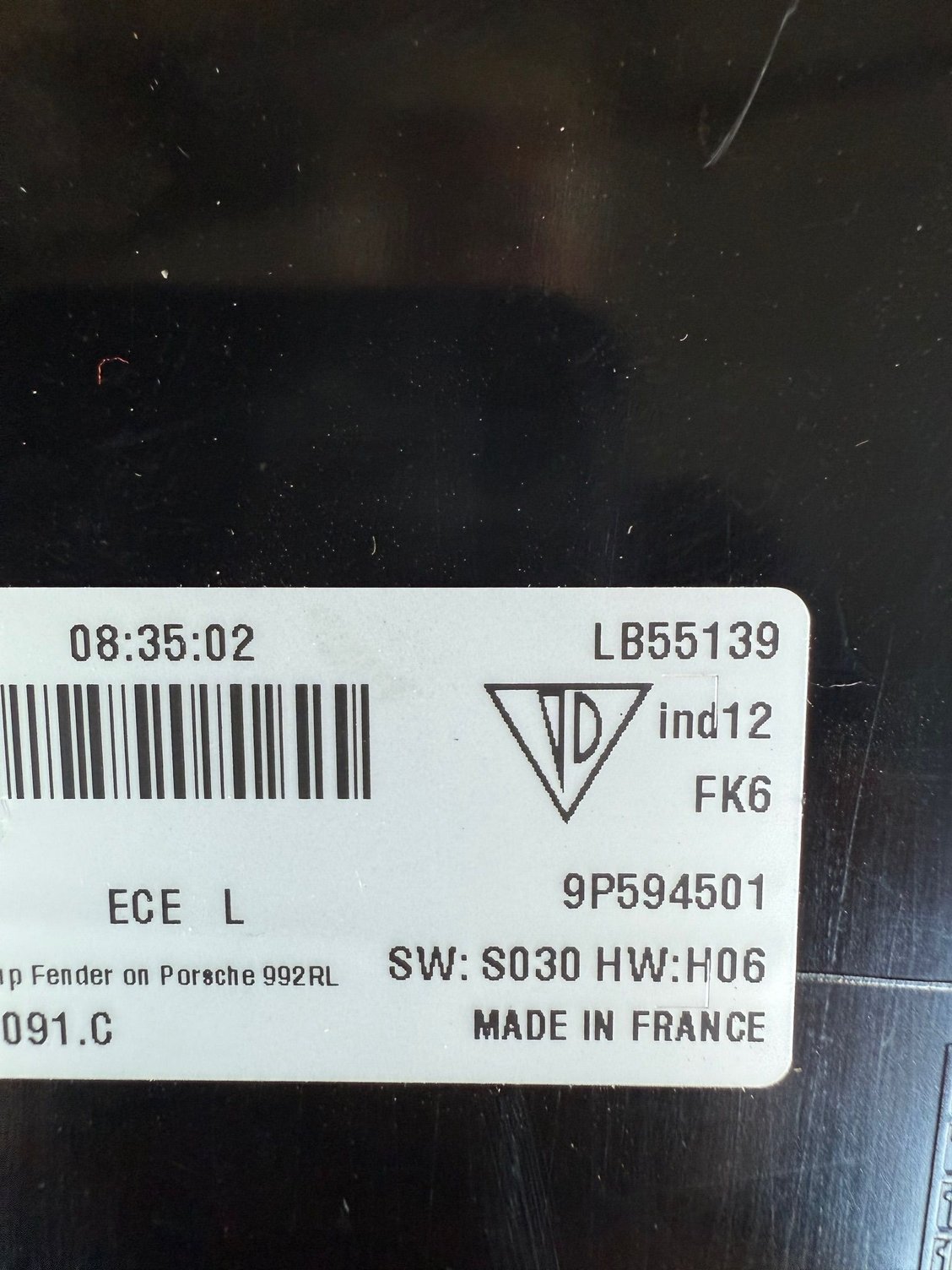

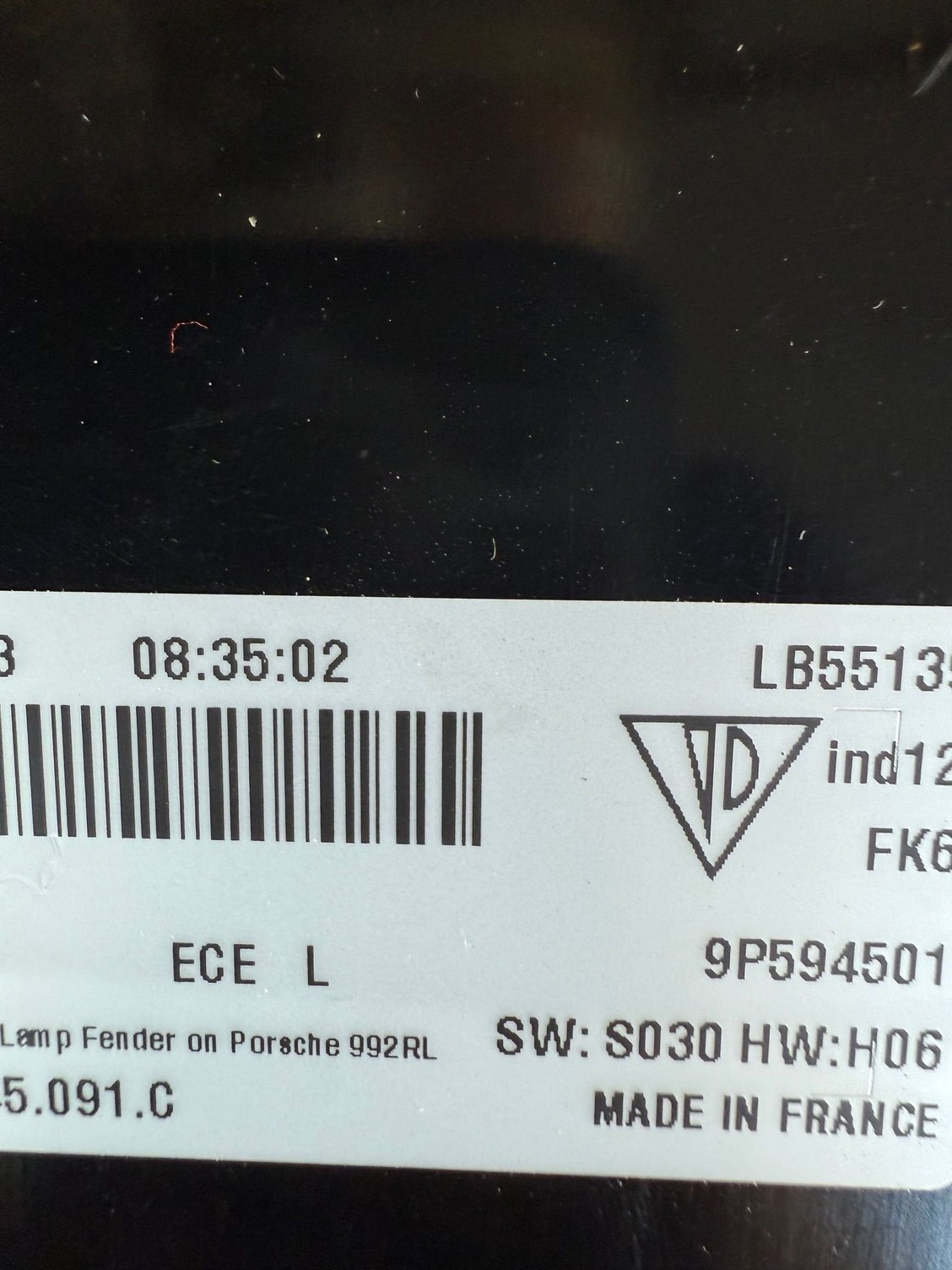

ACTUALLY - the Porsche dealer accidentally shipped me a set of ECE (Euro) lights in the exclusive tail light kit - I was unaware they were Euro until someone pointed out they were amber turn signals!! Thus, I can confirm they are plug and play - no wiring required, and no programming. . . here are the PNs from the amber lights:
