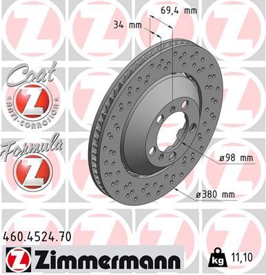

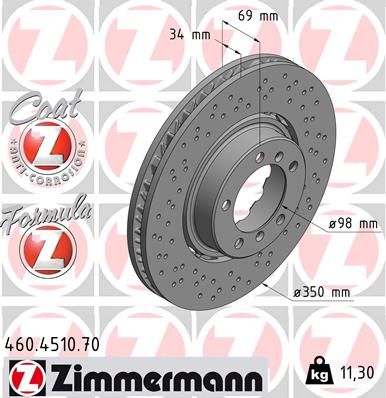

Bumping this thread as it seems not many S owners have pursued upgrading to 380mm rotors instead of the OEM 350mm rotors.
Based on the information in this thread and a thread over from the 991 forum https://rennlist.com/forums/991/1434...-on-s-gts.html it's clear that 991.2 GT3 (IRON) / GT4 rotors will work. Where I am stumped is the ET difference in the rotors. The 991 thread doesn't mention an ET spacer needed on the hub, but this thread does, although it doesn't show a picture of it, only the caliper spacer.
The height of the rotor difference is 0.4mm. Hardly enough to warrant a spacer on the hub (if they even make such a thin one) so I'm curious what @pietrostone ended up using.
69.4mm height for the GT3 / GT4 380mm disc vs 69mm height for the 992 S 350mm disc
For the rears it's a 1mm negative difference in height and 2mm increase in disc thickness. (see 991 thread post #32)
https://paragonbrakes.com/paragon-2-...91-gt3-gt3-rs/
This would be a very good improvement in weight, rear brake cooling (since the disc is 2mm wider, and overall braking performance (about 10%). I need to replace rotors anyways so this is a great excuse to upgrade with the paragon discs. Just need to figure out the spacers and do the washers for the pad studs as mentioned in the 991 thread towards the end. Curious if after a few years anyone else has done this upgrade and how you did it.
