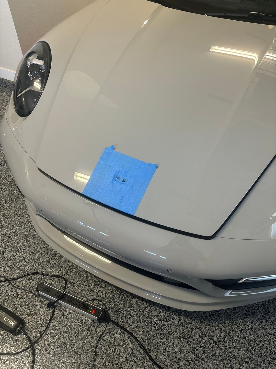

The only way to do it is to pull up hard while using the 8mm to loosen the nut.
Use painters tape to protect the area.
In my case I had a hood emblem rip from its posts, so I epoxied small nuts onto the posts in order to unscrew them.

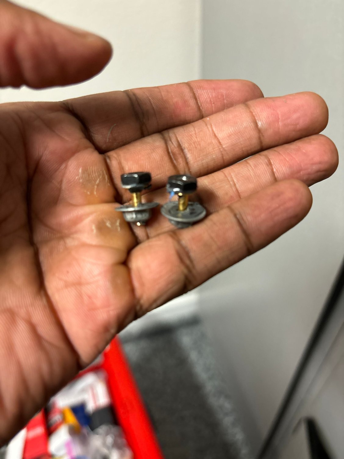

I used a pair of hemostats along with a pair of tweezers that I got at Harbour Freight…I changed my original and replaced it with the Turbonite…my T is GT Silver with Agate grey accents so the Turbonite works!!!!
My problem is that when I loosened the original nuts they would only come halfway off…stuck by the rubber adhesive….
