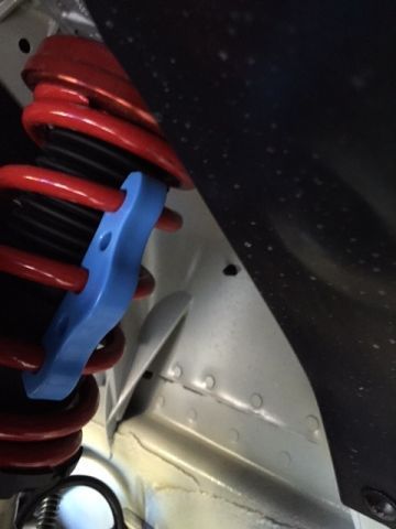

Shipping (orange) blocks:
Thank you. Certainly not present in my car - kinda wish it was that simple though

Originally Posted by WCE
Definitely no shipping blocks like that image in my springs. (do they even always use them - looks like a lot of trouble?)
My car is an (unexpectedly) early delivery "base" Carrera, so it has the PASM suspension which judging from the firmness HAS to be the same exact spring rate now as the S.
I'll definitely mention it to the dealer if I ever get there, just another area of mild disappointment with this highly praised 992 version.
Yes they do. Here's what they looked like on the 991 version:
