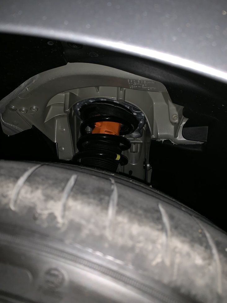

Originally Posted by LexVan
Shipping (orange) blocks:
And my shock looks different ... it has an accordion type sleeve inside the spring, so I cannot see if there is a block or not..

Originally Posted by 992Sam
So driving around one of the wealthiest pockets in the world, the SF Bay Area peninsula (aka Silicon Valley) ..where the tax revenues are probably the highest in the world, and the roads worse than many 3rd world nations... I've now twice, once on the 101 near Redwood City, and once on El Camino in San Mateo heard a loud bang after hitting one of our famous road bumps.. these are not pot holes, just badly aligned road work areas... where a new piece of pavement meets an old.. I'm pretty sure the shipping blocks are gone. I inspect the underside of the car, and there is no damage, so I assume it's suspension... feels like front.. Should I get the car inspected? should I be worried? or is this something the car can handle?
I get this same "bang" noise frequently going over some road bumps at speed (mine seem to be coming from the rear and on rebound rather than compression). I had my dealer check it out (yes, shipping blocks are removed) and they said that there was nothing wrong with the suspension and that this is normal--seems a little odd that this would not be absorbed by the shocks on a Porsche suspension (non SPASM).
