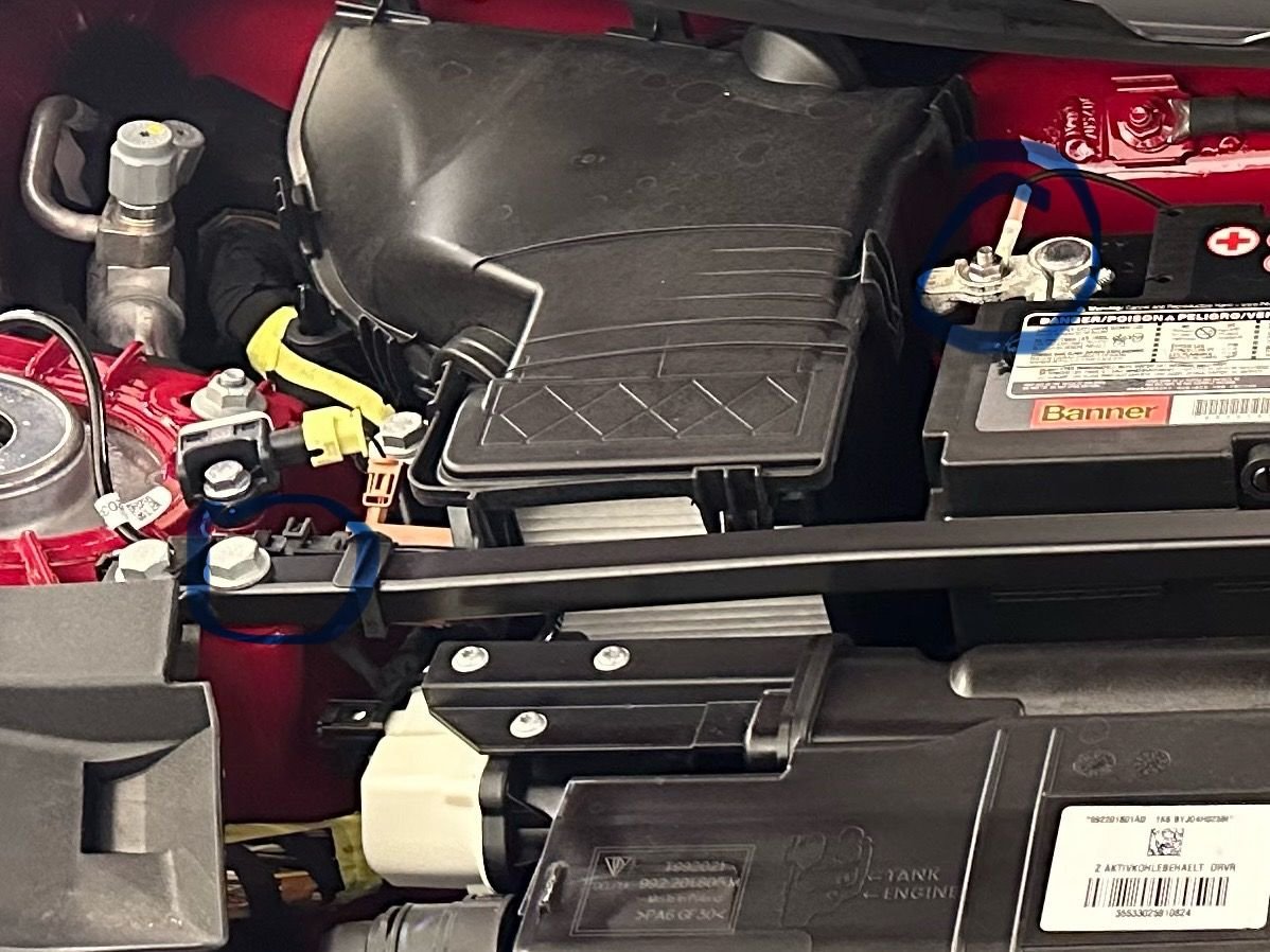

Here are some photos of the "second nut" approach with a Battery Tender product.
You use m6 or m8 eyelets?
Is there really enough thread for this?

Its whatever eyelet comes with the Battery Tender product, I guess its an M6 eyelet since the post takes an M6x1.0 nut. If you get a thinner nut, there is enough thread to tighten.

I bought m6 eyelets as the m8 eyelets that came with the charger went on my sedan. The negative nut barely fit and took a couple of tries to thread it in. Hopefully it doesn't come off with vibration as time goes on.

I wanted to provide some info pertaining to this. The M8 eyelets worked fine on my Nov 2023 992 build (MY24) with a AGM battery, but the M8 eyelets were too large on my July 2024 992 build (MY24) also with a AGM battery. I have had to order the M6 eyelets from CTEK.
