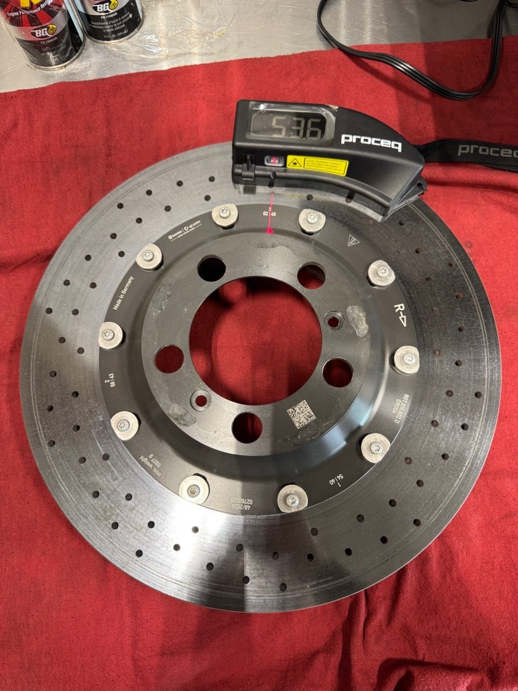

Finally got a chance to get the PCCB’s I removed measured on the bench. Not a perfect comparison to my prior measurement because I did 3 track days between measurements, but I’d say the on car measurement was darn close. Close enough to where I certainly wouldn’t bother measuring off the car or worrying about it being dramatically different. If the on car measurement shows you’re at or near the wear limit, you probably are.
Have since moved on to our CTE carbon rotor offering, and will put these on the shelf for the off chance I ever sell this car or if the CTE rotors need to go back for refinishing.
Note the $15.5k PCCB cost is assuming you buy the PCCB upgrade kit, and then sell the calipers for a couple grand. If you just buy the rotors, you’re looking at a much higher cost.
Updated usage after bench measurement.
One of 12 measurements needed

Thanks for taking the time and effort doing the measurements.
Looks like the rears wear a lot more than the fronts. In my 991 RS, the fronts pads lasted ~2.5x as long as the rear (ESC on) and so were the discs(iron) In the 992 RS (PCCB), the pads wear at about the same rate F/R. My 992 RS ESC is set at Dynamic in Track Mode.
What's your ESC setting when you run on track?

Yep it’s true. Has to be due to the ESC/TC settings.
For the majority of these days, I ran with the default settings in track mode. Today I typically run with TC set to 3. ESC on dynamic
