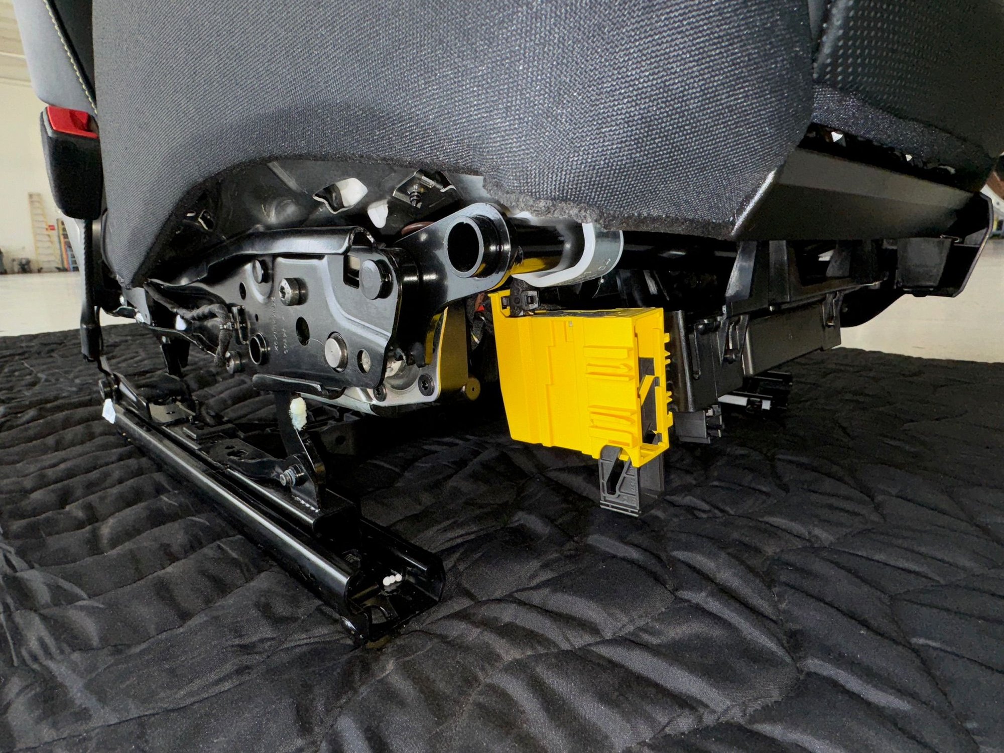

Power up, no faults!! everything worked perfectly - but of course no heat, ventilation, or memory. My theory at this point is that the smaller 3 pin connector is for the memory function, and my guess is that by adding the heater switches in the console, we can get the heater working. I'm going to see if I can dig up some wiring diagrams to confirm what the small 3 pin connector is for, and if possible, how to add it to the GT3. Drove the car around to assure no faults, and that everything works - no issues.

Some other observations - on the larger connector (the big yellow one) on both cars have exactly the same pins - not sure there are wires hooked to them as didn't peal back the harness. So next step is to pull the center console apart, search for wires, and see if I can install the heat / ventilation switches. Lastly, will investigate the memory wiring and control as a bonus project.

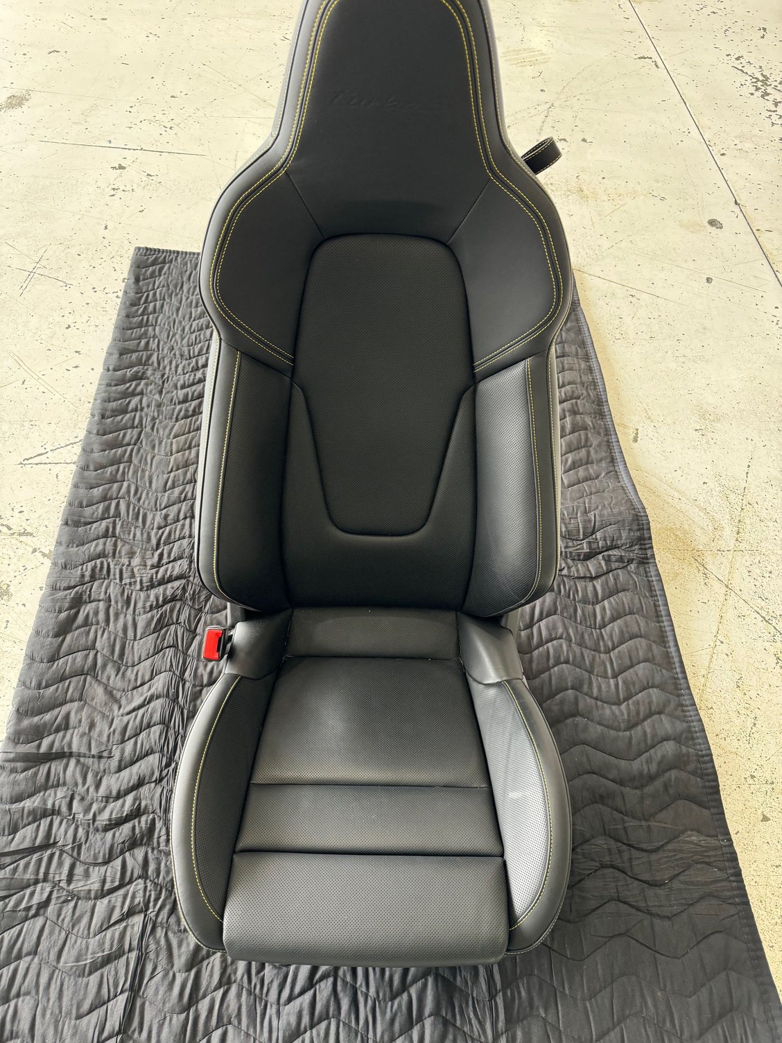

Now the search begins in earnest for a nice set of black all leather sofas with GT Silver stitching! I did check with Suncoast on the cost of new seat covers - they were somewhat unhelpful, and required a VIN. I did find a GT3 online with leather / alcantara seats with silver stitching and used the VIN to get pricing - around $10K for all new seat covers! My bet is these can be had substantially cheaper elsewhere. .

Note the smaller connector on the TTS
Sofa seat connections - smaller connector plus into what appears to be a controller - I suspect this is a CAN connection.
Another view of sofa connection
TTS heated, ventilated sofas.
. . with carbon backs
bucket connector - identical to sofa connector

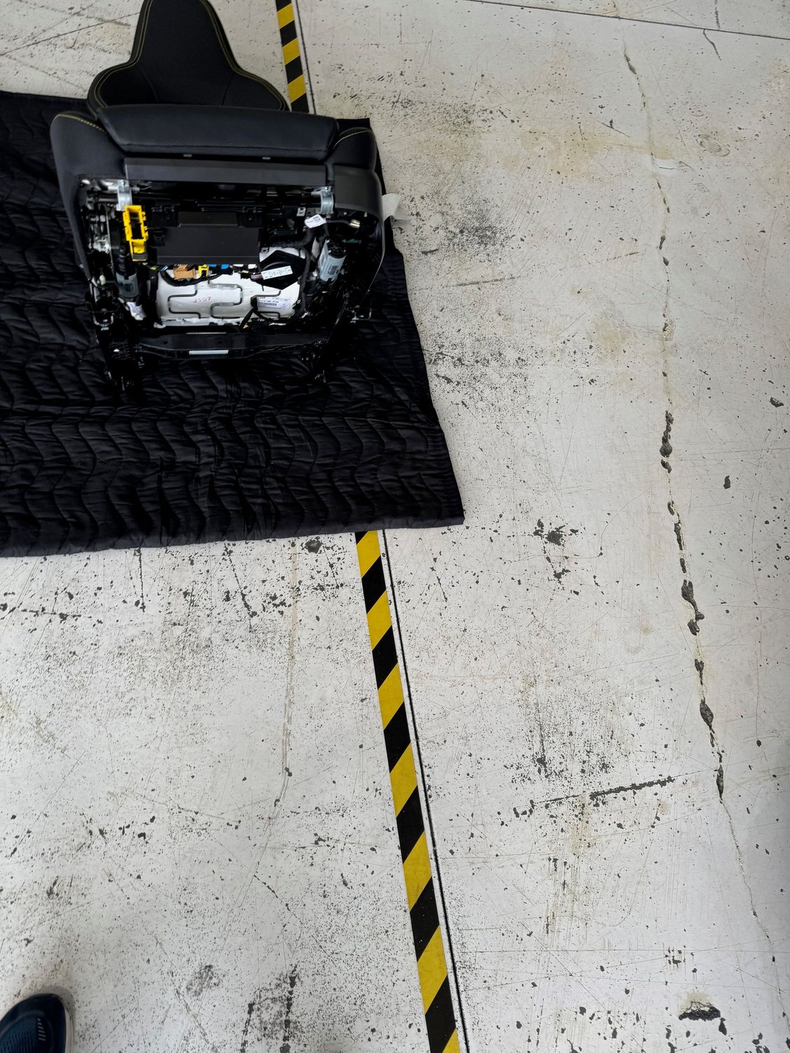

another view of the "controller box" on the sofa - I believe this is the memory controller, but just a guess.
underside of sofa
