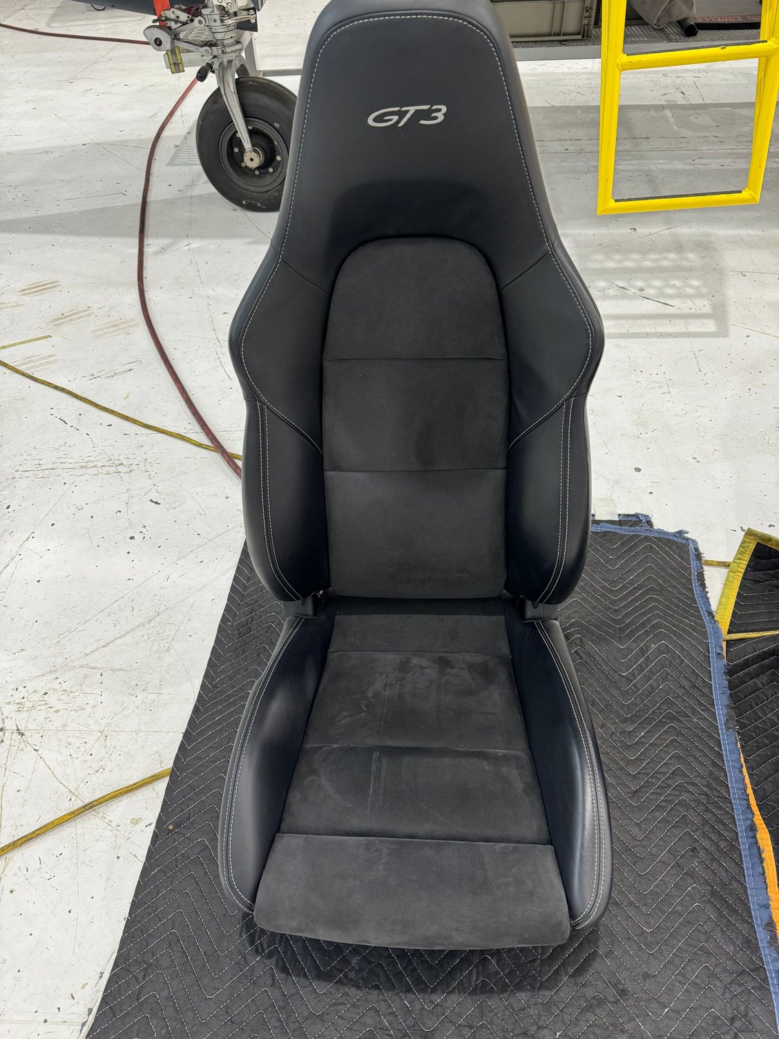

Some progress today - I received the 991.1 GT3 seat I purchased from @G-Dub - thanks! They are beautiful, nearly flawless examples. Unfortunately, they are missing the seat belt receivers, and I have not received the replacements I ordered yet, so at the moment, no real way to completely verify they will work in the 992 as without the receivers, it will through a code. . .
However, I did install the seats in my 2022 GT3 Touring - perfect fit, and the plugs are identical. I powered up the car, and as expected, it throws an airbag fault. However, in looking through PIWIS, it appears the fault is related to the absence of the seat belt receiver - when I examine the airbag resistance values, they appear very close to the values from the 992 seats. All the power functions of the seat work perfectly.
I've read in others posts here that the 991 seats "won't fit" in the 992 platform - this is patently false. They fit perfectly, and as far as shape and form, are VERY similar to the 992 18 ways (I compared them to the 18 ways in my 992 TTS). Consequently, Im increasingly confident that all 991 generation seats will be interchangeable into the 992.
I should receive the belt receivers this week, and once I install those, I should be able to complete this experiment.

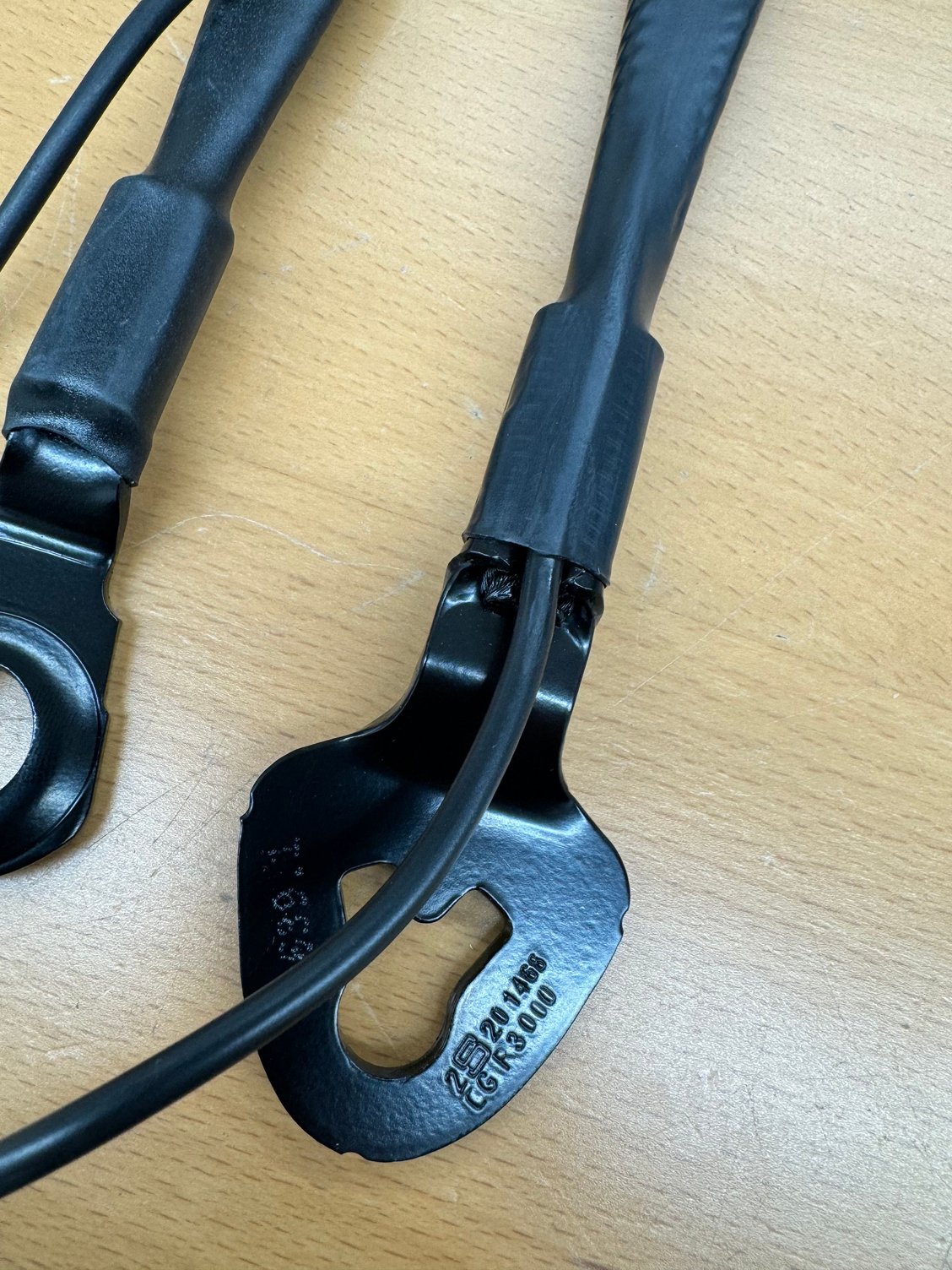

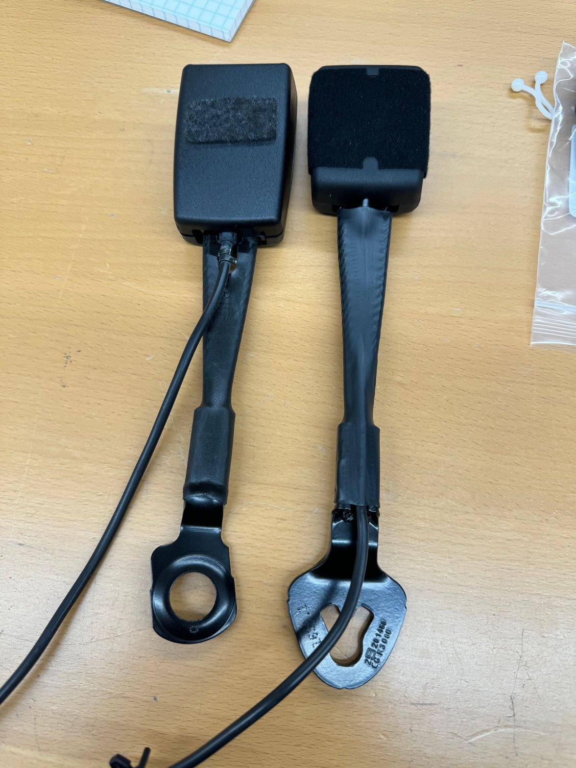

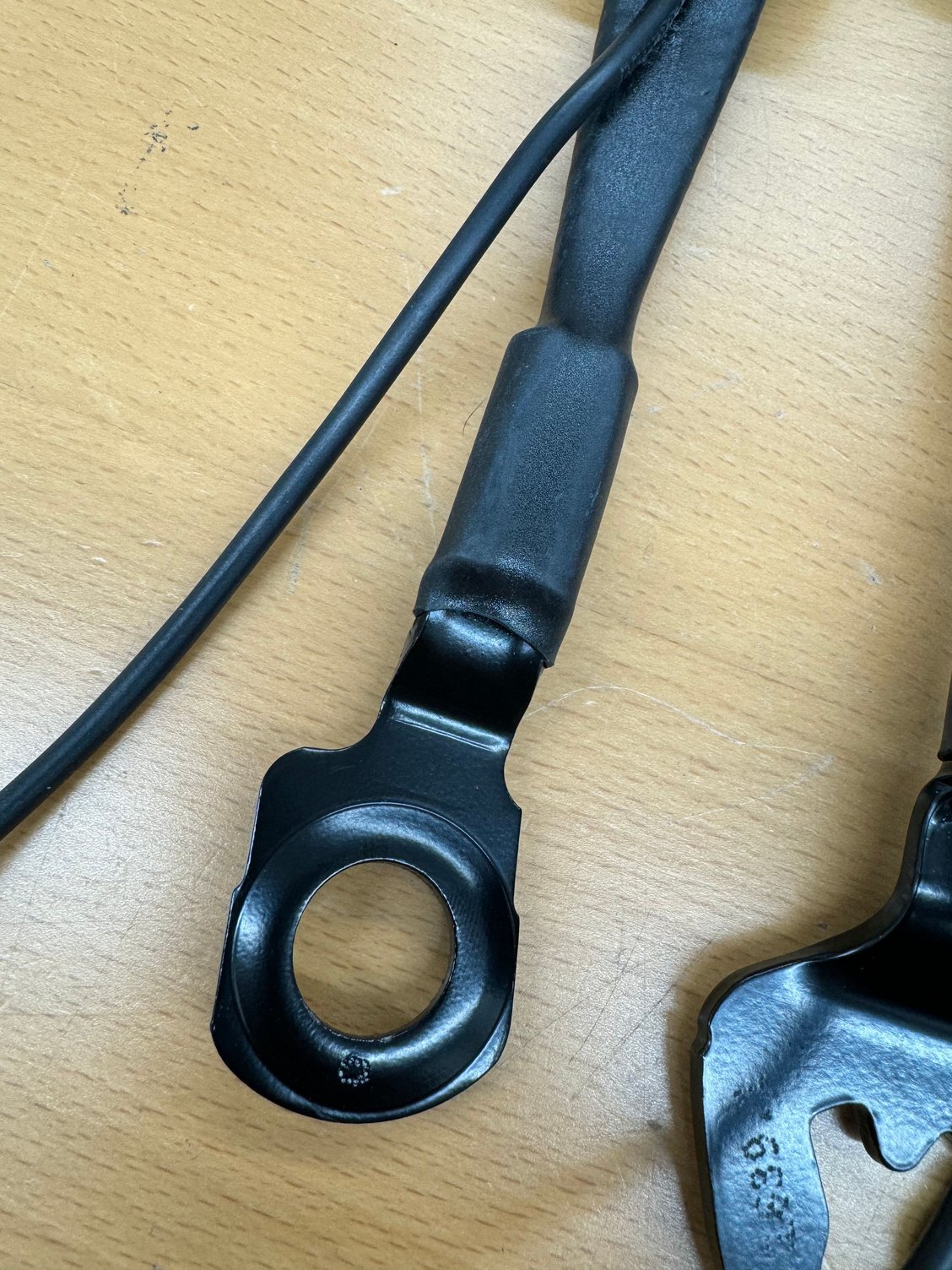

Success! I receive the missing seat belt receptacles today, and made an interesting discovery - turns out the 991 receptacles are NOT compatible with the 992 belts - the tangs on the 992 belts are slightly shorter and won't latch into the 991 receptacles. Thus, swapping 991 seats into a 992 will require updating the seatbelt receptacles to the 992 version. I used PNs 992-857-755-D and 992-857-756-D (about $175 each). Unfortunately, Porsche also changed the the wiring on the newer receptacles, so swapping requires splicing in the connector off of the 991 receptacles and extending the wires a bit (two wires). Also the mounting tab is slightly different, so will require either a small modification to the 992 bracket, or swapping the bracket off of the 991 unit.
However, once the 992 seatbelt receptacle is adapted to the 991 seat, it works perfectly and all functions are available. I haven't receive the new center console switch panel that includes the seat heat switch, but I don't foresee any issues installing that panel (just a CAN bus connection).
Swapping 992 seats into a 991 chassis will also require changing the seatbelt receptacles - the PN for the 991 version (this is for my 991.1 18 way seats) is 991-803-183-00 and 991-803-183-05 (about $176).
Good news is that it appears ANY seat from 991 or 992 vehicles can be retrofit into and 991 or 992 chassis with only a swap of the belt receptacles. Euro versions will require passenger occupany sensor installation, which is covered in other posts referenced here. I was able to download all the wiring diagrams for 992 generation seats if anyone needs them . . .
991 on the left, smaller 992 on the right
this is the 992 bottom bracket - will need to sightly modify this, or swap to the 991 bracket.
this is the 991 bracket that matches to my 991.1 seats.

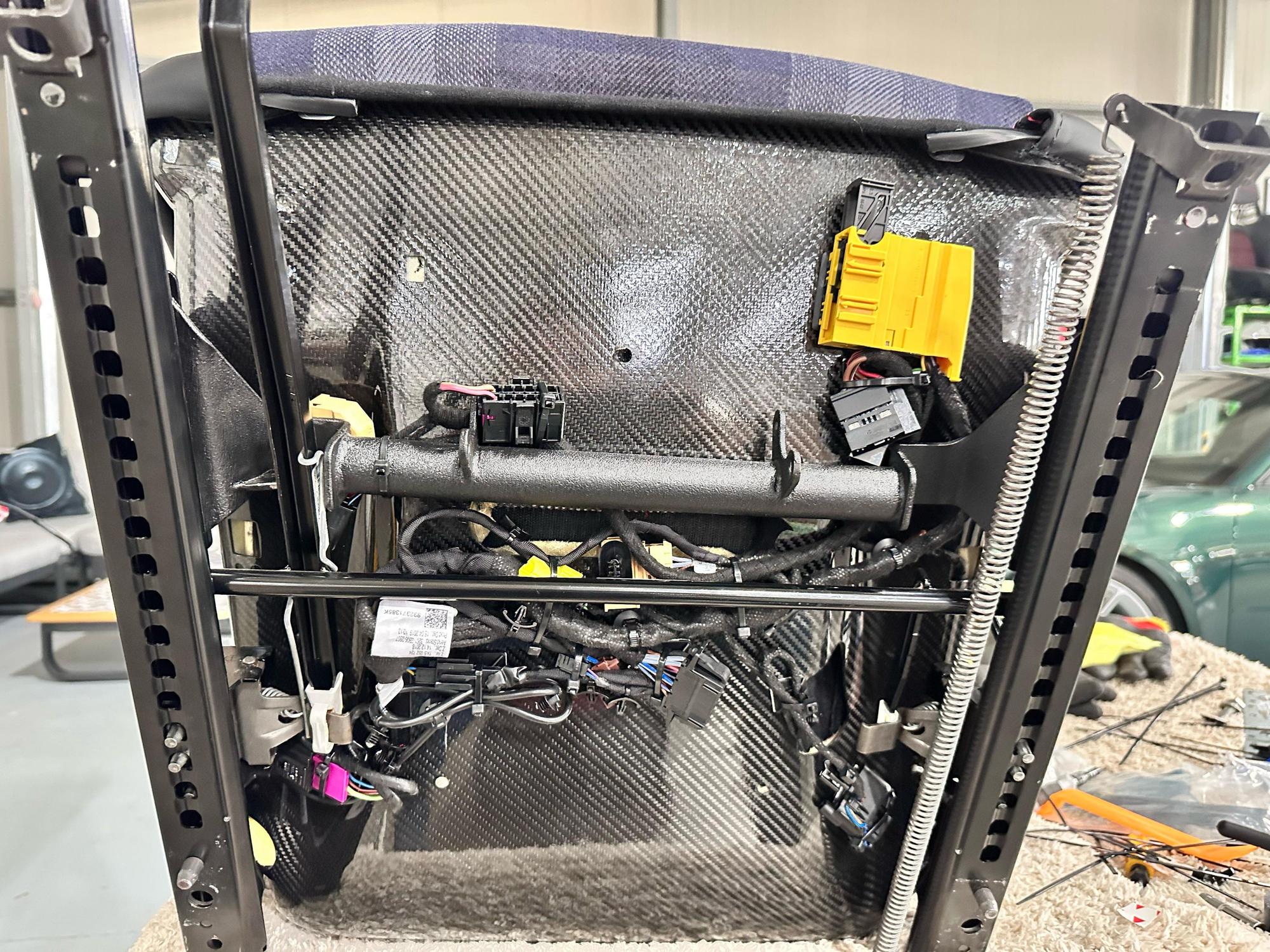

the 992 version uses a short dongle that connects to a sub harness - to use these you will need to cut off this connector and extend the wiring directly to the seat connector and reuse the 991 connector. . .
