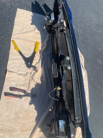

Just reporting back after completing my repair. I opted to repair both sides even though the driver's side seemed to be in perfect condition. 90% of the work is removal and replacement of the spoiler so I thought it was prudent to proactively reinforce the unbroken side so the R&R never needs to be done again. I opted to buy a bar of aluminum from Lowes for $4.50 and cut it to length with a hack saw. Then I used two pairs of pliers to bend it and then twist it to mate up to the two surfaces. My spoiler was fully operational when I started this, but it may have been destined to malfunction at some point. The biggest win was that terrible and elusive rattle is now gone! Finally!!!
