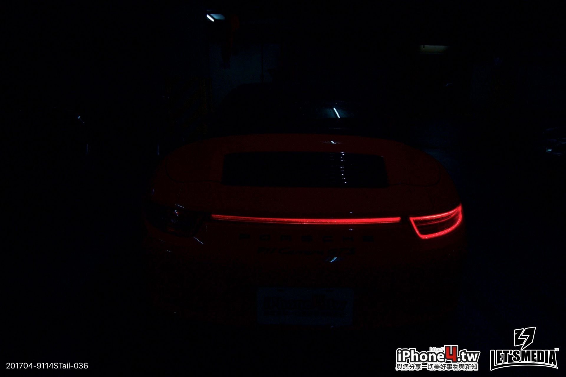

It is doable. Someone from Taiwan has done his 991.1 GTS Center tail light modification. http://iphone4.tw/forums/showthread.php?t=220289. the website is written by Traditional Chinese with pictures.

Thanks for the follow-up Slin818! Now, only if I could read Chinese! Any Chinese speaking RL's out there who can translate? The service department at Porsche Downtown LA told me the electric wiring is different between the US and European/Canadian 911s (which, they claim, is why a European GTS was able to make the modification, as seen here on RL). If this is the case, perhaps the Asian market also has wiring that makes the modification possible. Or, perhaps it is possible with any 991.1 GTS, no matter its country - that is where having the text interpreted would be so helpful. I will see if I can somehow translate the text on Google translate. Thanks again!
